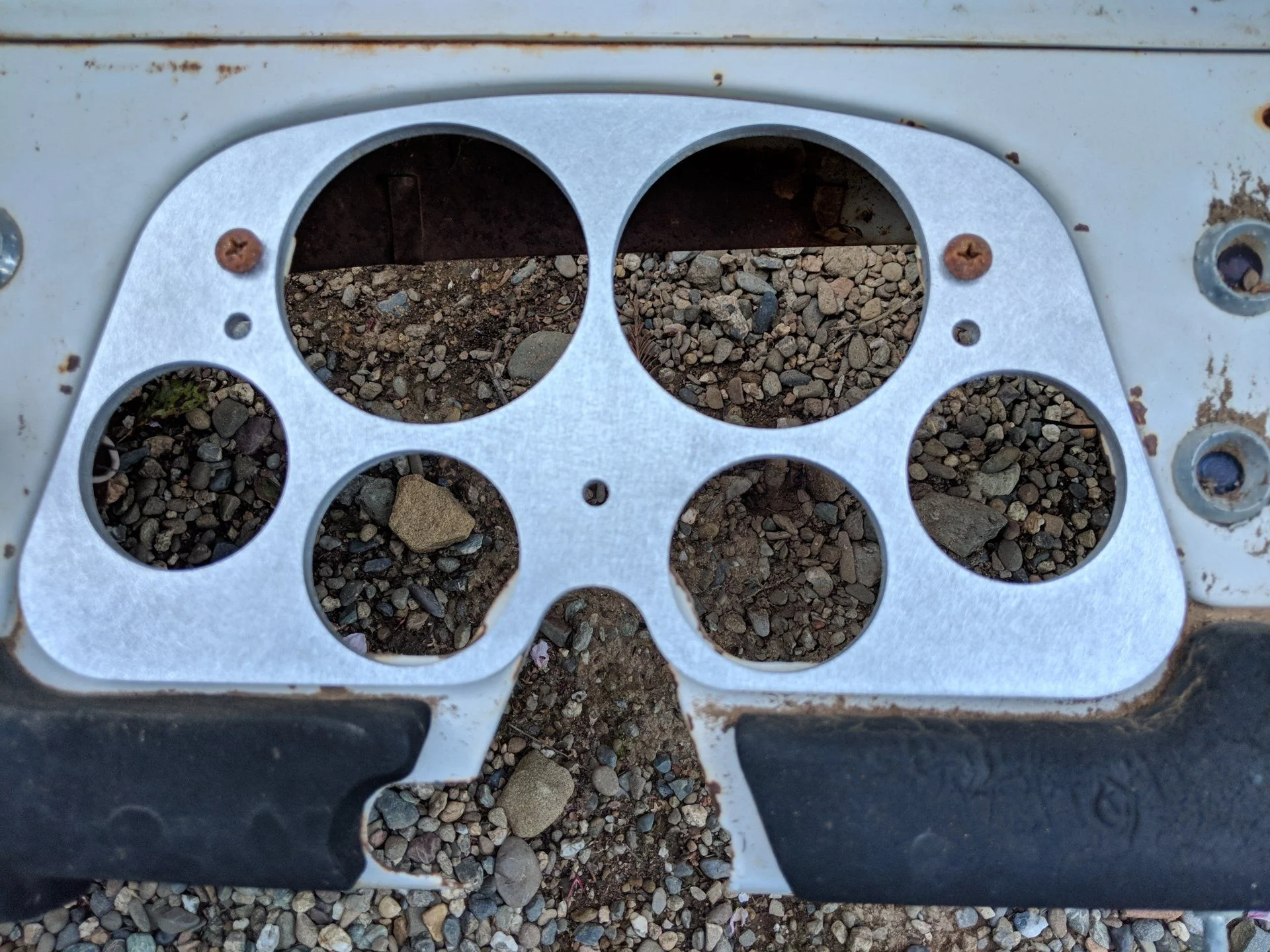

Ok, on to the pics...
full
This plate here does NOT have the mounting holes countersunk. I did that on purpose as I might use button head allen screws instead.
full
Ok, I know some of you are going to say "Hey, you are ripping off someone else's design".
Well, yes, it's not my design. But there are only so many ways to get 6 gauges into an FJ40 dash.
If that's a big problem for you, I guess you'll have to figure out how to get over it... or not.
Now, if Woody or his Mods have a big problem with it, I guess my post will voluntarily disappear.

Have you test fit that into the cluster opening in the dash? I'm just wondering if there's enough clearance outboard of the gauges to fit in the dash without trimming. I'd certainly consider buying one.
Does anyone have a copyright on the design?? Don't care, it's a nice piece. I'll probably take one as well. 1/4" is an awfully thick chunk of aluminum for an instrument panel, but shouldn't give. :cheers:
im interested what kind of trimming are we talkn about
Very little, mostly at the bottom two gauge holes. You have to clearance enough for the bracket that holds the gauge in the plate.

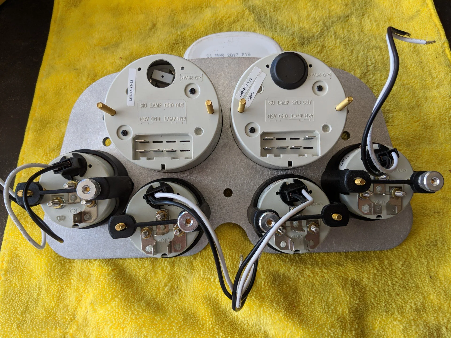

full
I use the Auto Meter gauges in my 40 and they are terrific. I bought the GPS speedometer so I would not have to run a cable. Only take a minute to read the satellites and it is dead on accurate.
