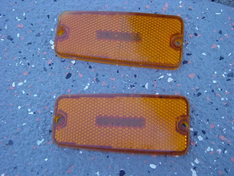

This is the way that i found to take apart thE side reflectors
1.- make a jig with the router
2.- tight the nuts under the jig
3.- push a little
and thats it !!
Now we can send to zInc plate the parts and get the front ring paint!!
Here we only dream about pulling our reflectors off without the studs breaking!:crybaby:

this is what i found
you have to use your old reflectors that they will be withe color
then with a orange cany color ( transparent color )
very watered and go coat by coat!!
The good thing , you can use your old frames and go to zinc , and paint the ring.
And the other :
Use the new frame and ring that came on the rear red reflectors!
Best!
3.- push a little
and thats it !!
