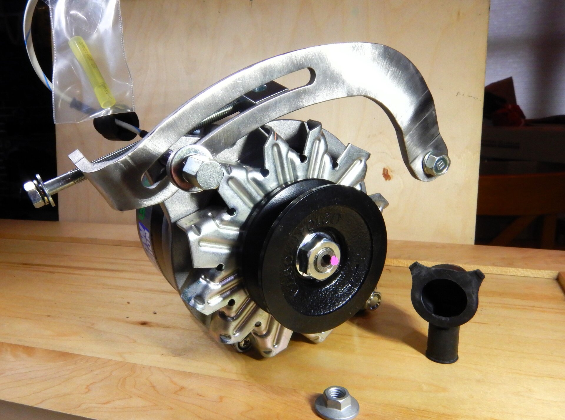

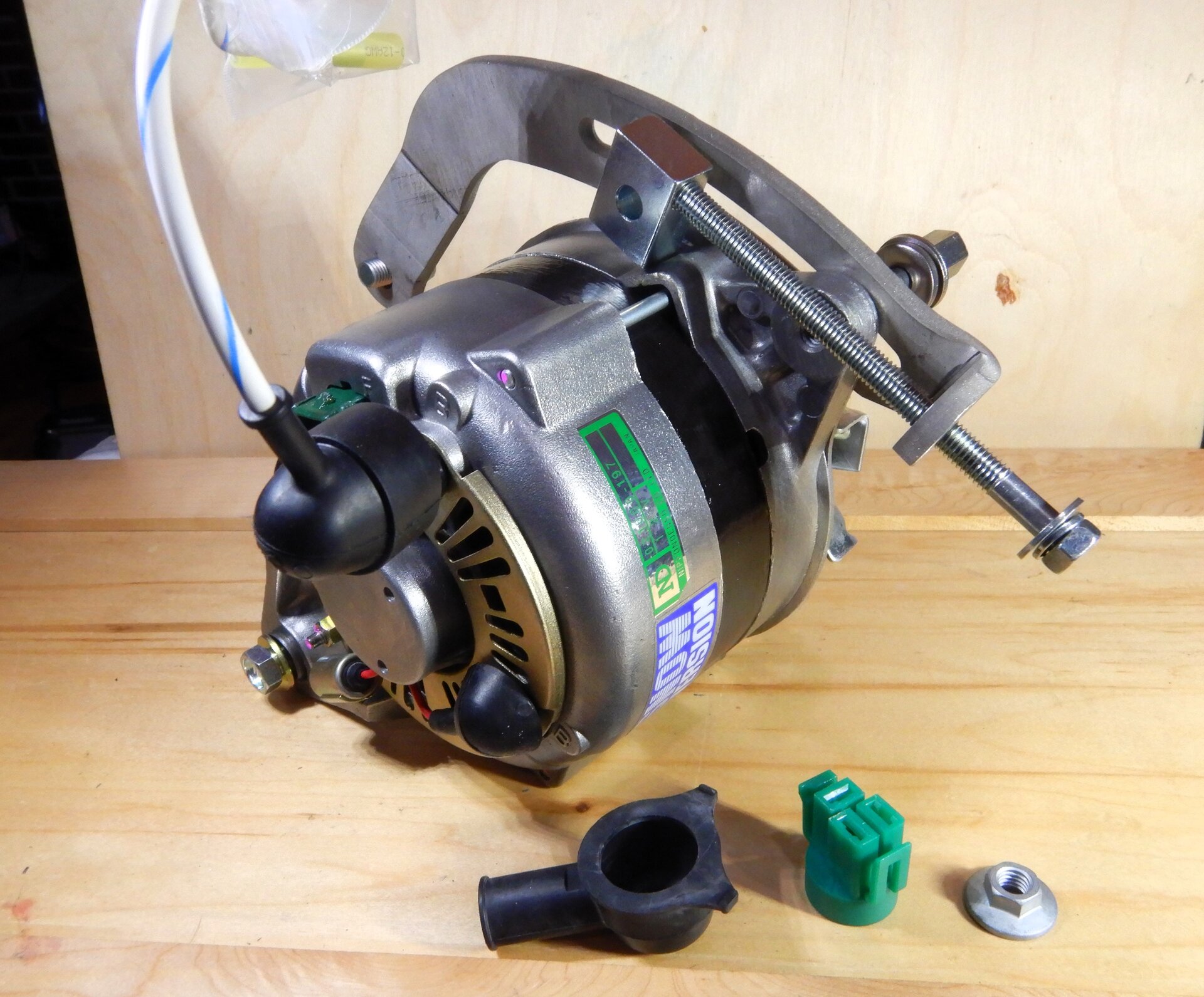

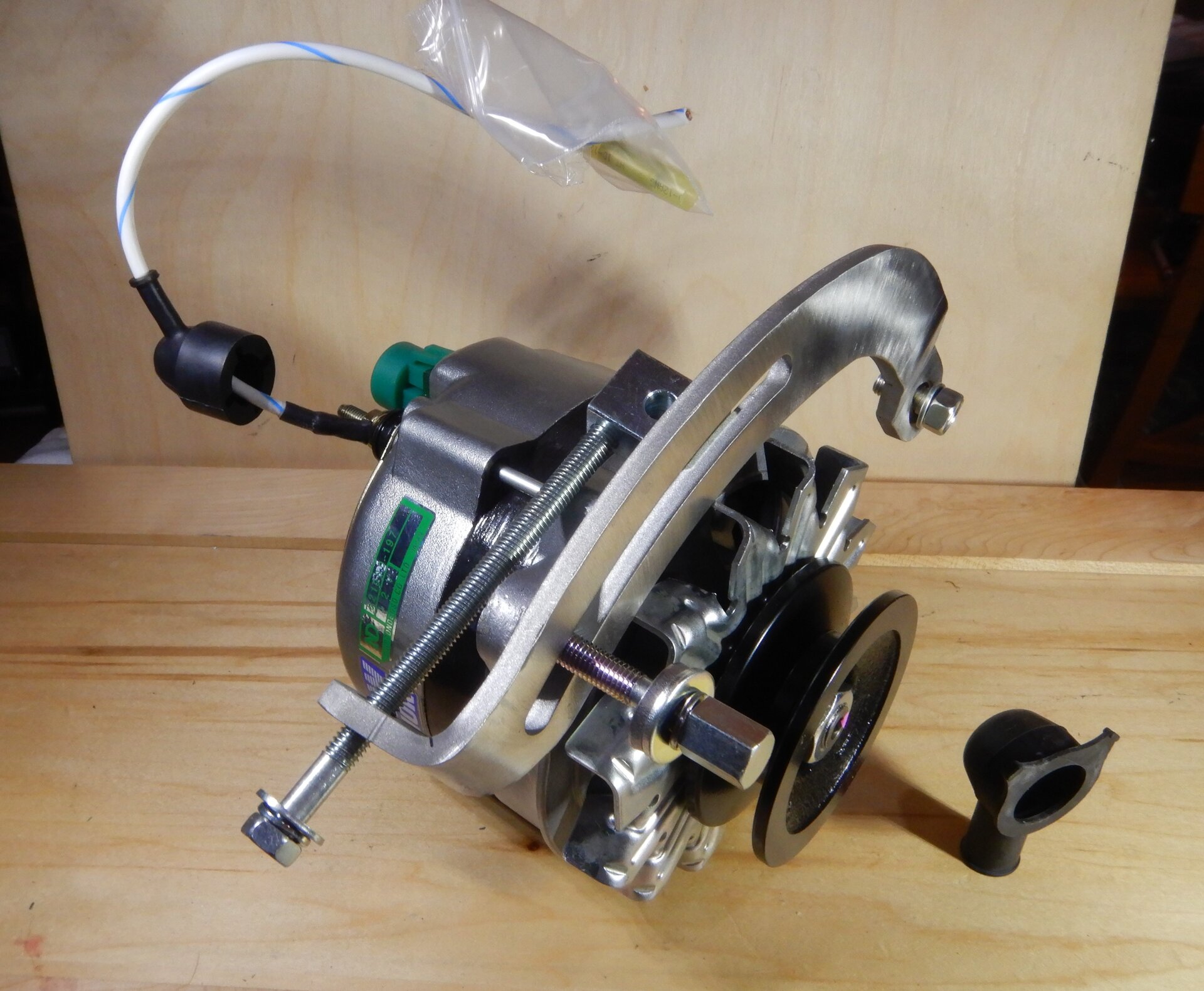

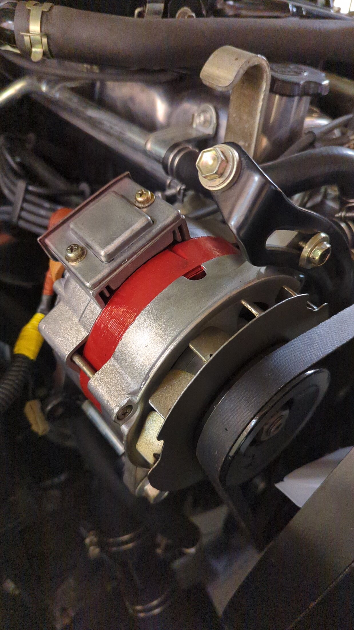

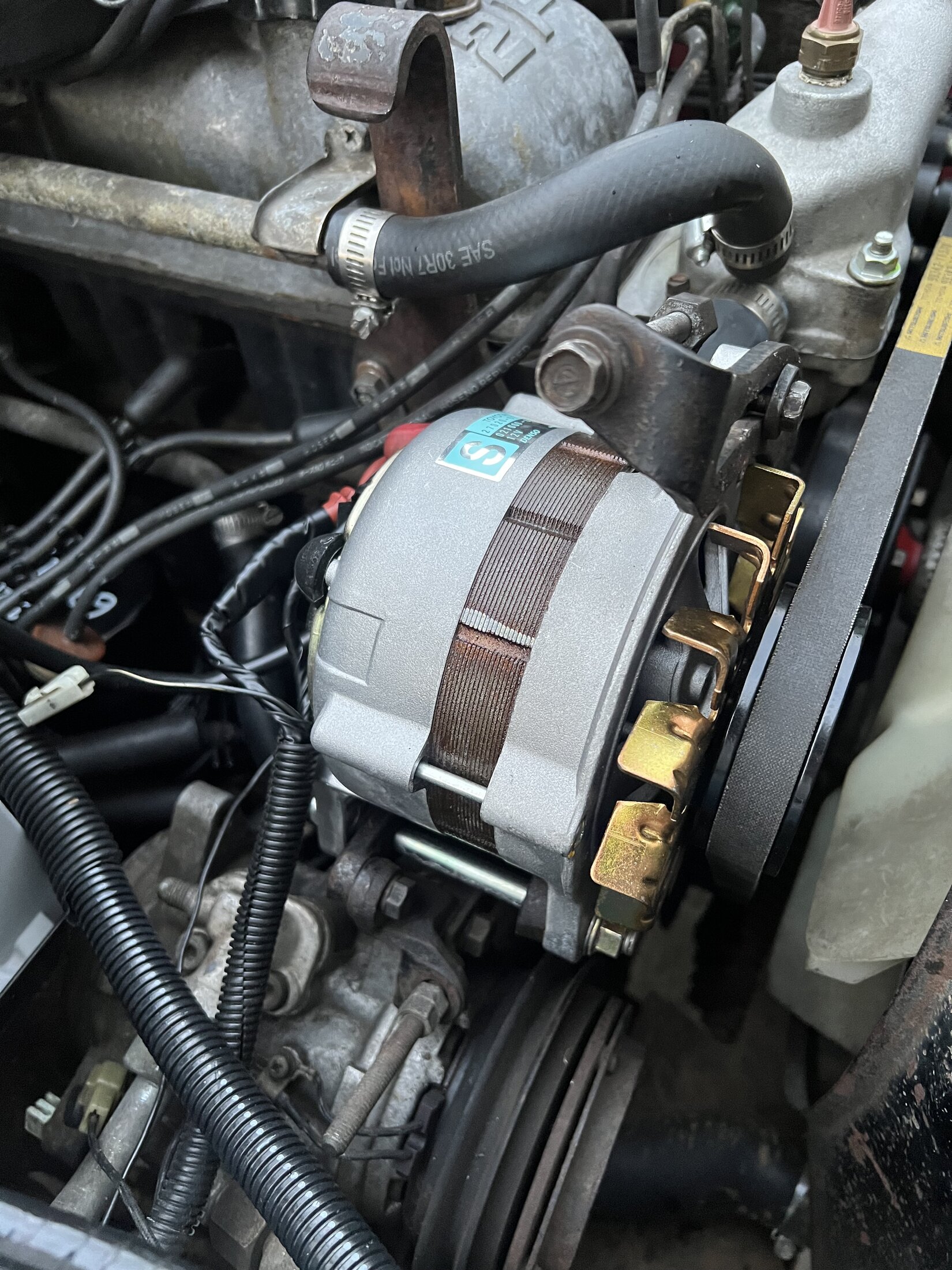

I got two stock alternators from @ToyotaMatt a couple years ago for both my 40 & 60. Not sure if he has any more but the price was right and the quality was good.
I got two stock alternators from @ToyotaMatt a couple years ago for both my 40 & 60. Not sure if he has any more but the price was right and the quality was good.View attachment 3825856View attachment 3825857
Thanks. I'll get with him.

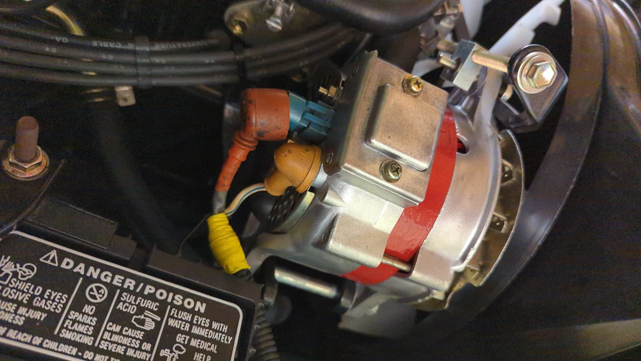

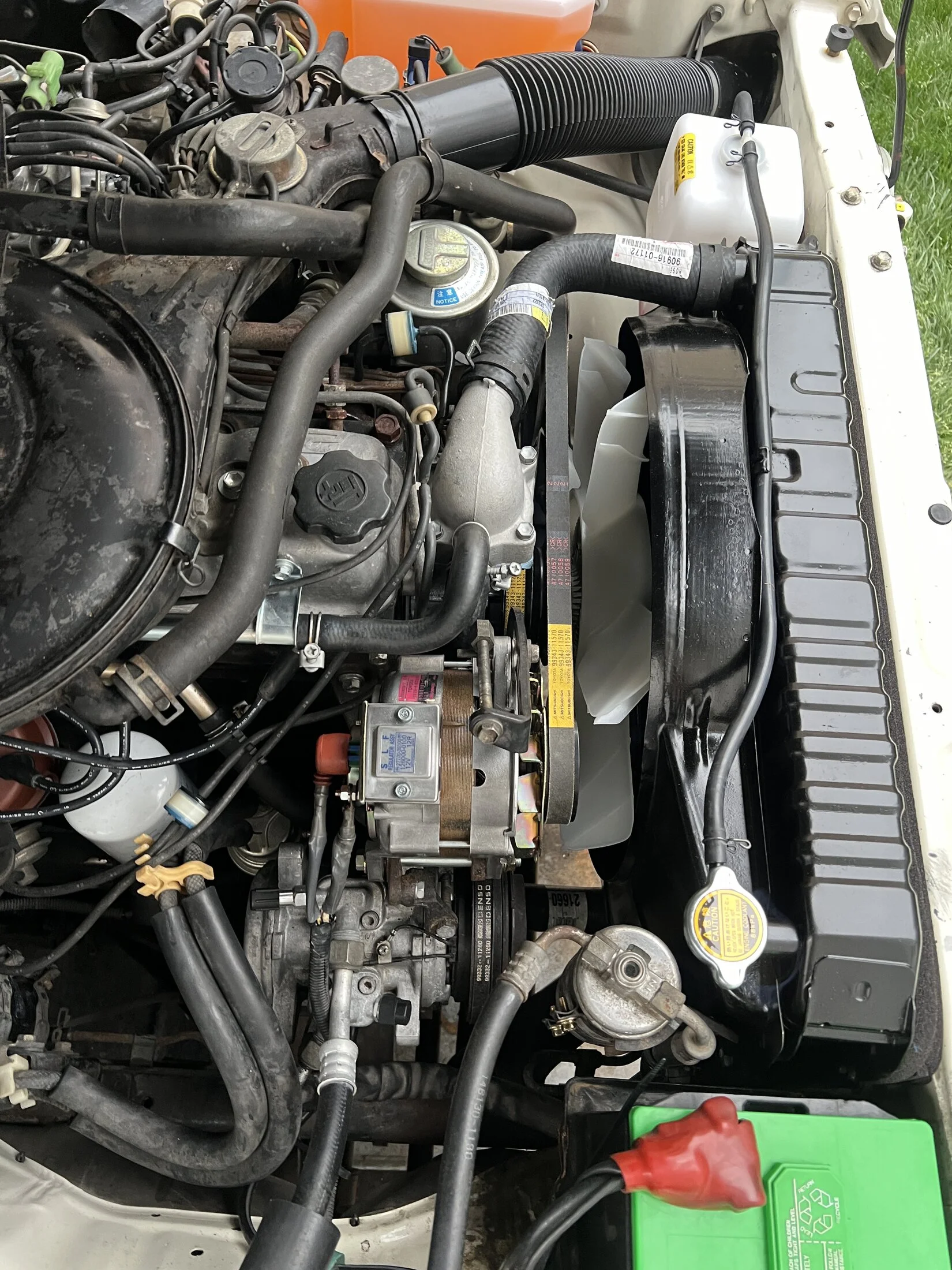

It's actually a 1980 Fj40 with an 81 wiring harness and 2F engine from and 85 Fj60 with an internal voltage regulator on the alternator. It's not an original FST, but I've converted it to one with FST parts.
good TECH pics , Thanks !
so what is wrong with this current set-up or that current self-regulated Alternator you have going on above ?
how come your needing or wanting a :
Fj40/60 Alternator with internal voltage regulator ?
matt
It's not charging my batteries. Had it worked on by an alternator hole in the wall and it still isn't! In fact now, when I crank and start it, the engine will not turn off unless I disconnect the battery!!

your words : when I crank and start it, the engine will not turn off unless I disconnect the battery!! ( this is a ⛳ ) ....and time to pause and confirm and verify several various key step by steps outlined in your TAN 2F Engine FSM ..........
- i think perhaps you have a non-alternator issue here going on , if i am correct this would also cause your currently in-place & hooked up 27020-61081 DENSO your sporting there not to correctly charge the battery also , & also not keep your engine running as it should when you remove the B+ Positive battery cable like you go over above .......

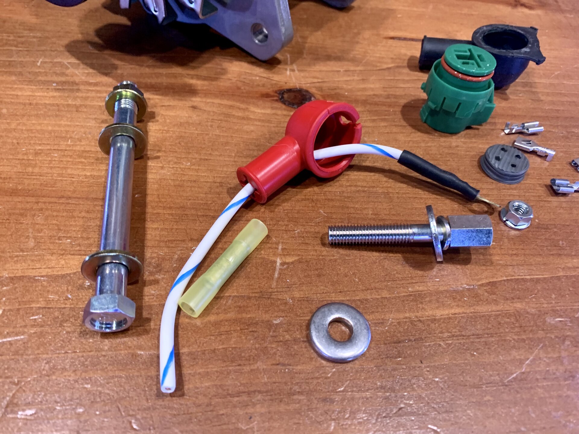

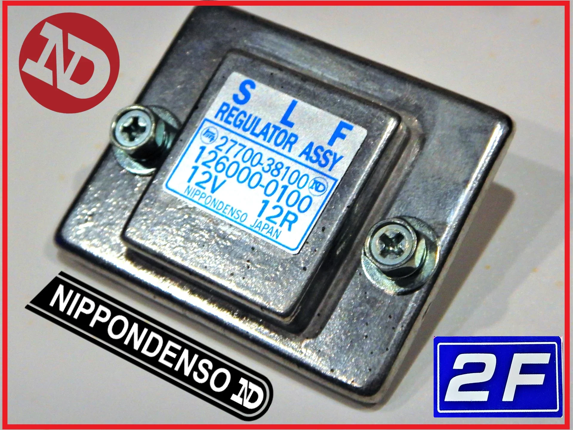

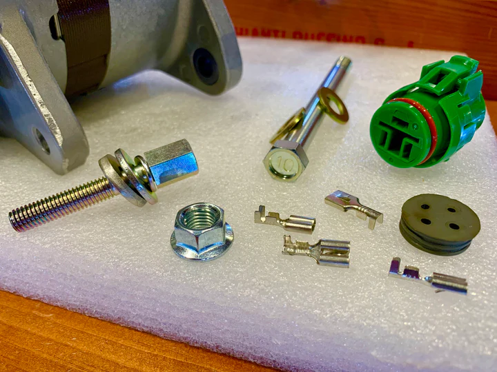

2-wire green plug OEM DENSO is in the realm of what i feel you should know , that things like that little square box saddled on the top piggy-back-like is your IC Voltage Regulator , so technically you do not a internally regulated one now ...... technically
this was the CIRA ERA in
NipponDenso charging system technology that they moved the REMOTE regulator BOXEs from the fire walls and fenders , but were not really sure and i say Scared yet to go Internal on them , so its a baby step to the BIG MOON Shot if you follow me here ......?
i personally : would UN-BOLT that little guy and do Exactly what you see me doing on and to every single 27020- , 27030- , 27040- , & 27060- that leaves my shop door to it's new forever adopted loving home / shop ....
if anyone suggests , or tells you any different then what i outline above and you see below ?
they are incorrect
it cost's ZERO imperial credits to confirm and verify if or if-not your
27020-61081 is faulty in one way or another ? a SOLID old-skool alternator shop or perhaps AUTO-ZONE / O'rileys will be able to pin-point the exact bad part / parts inside or ..........piggy-backed outside ..
then you will know , knowing is self-empowerment , and correct education is the path to it ......
