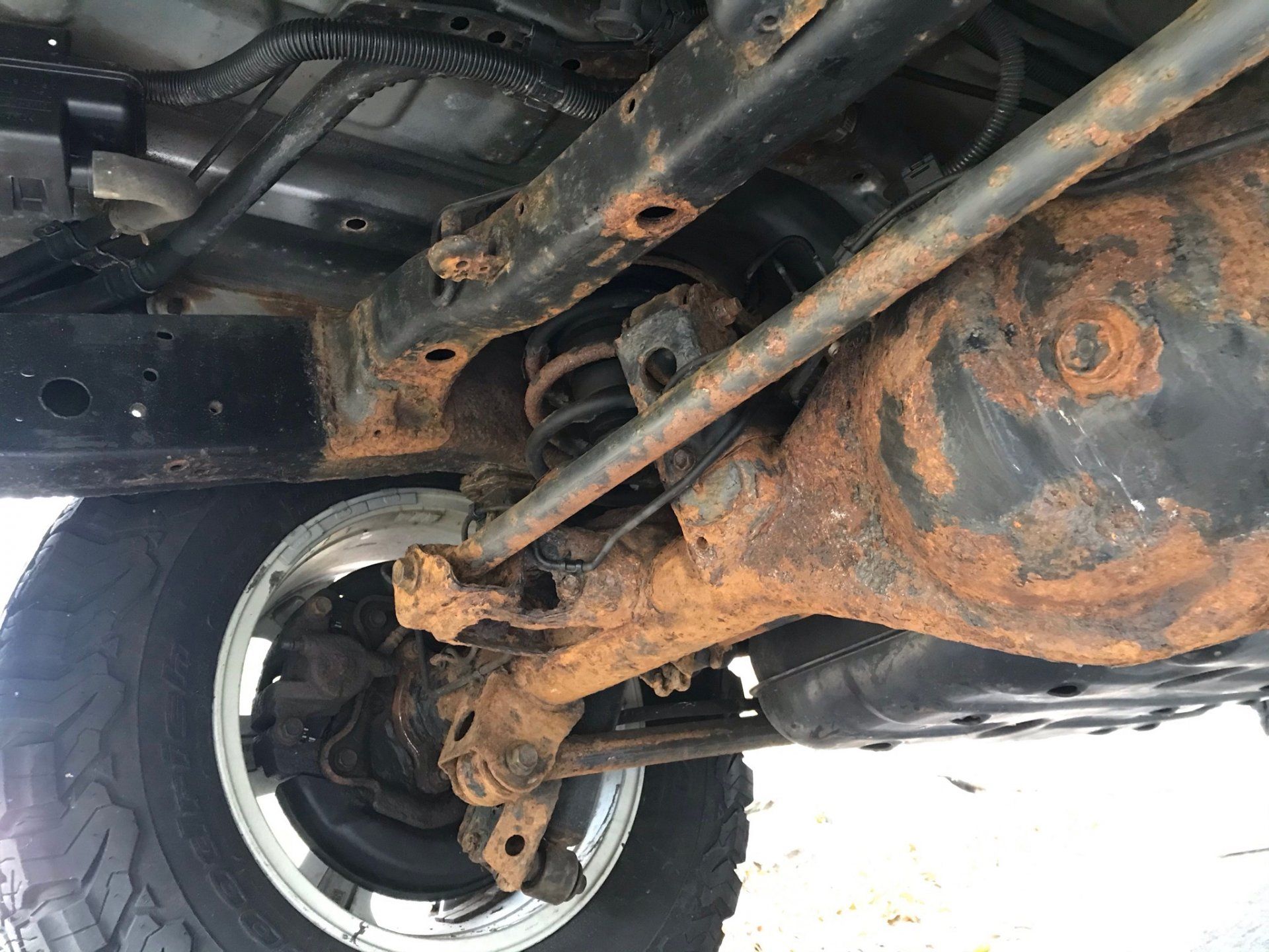

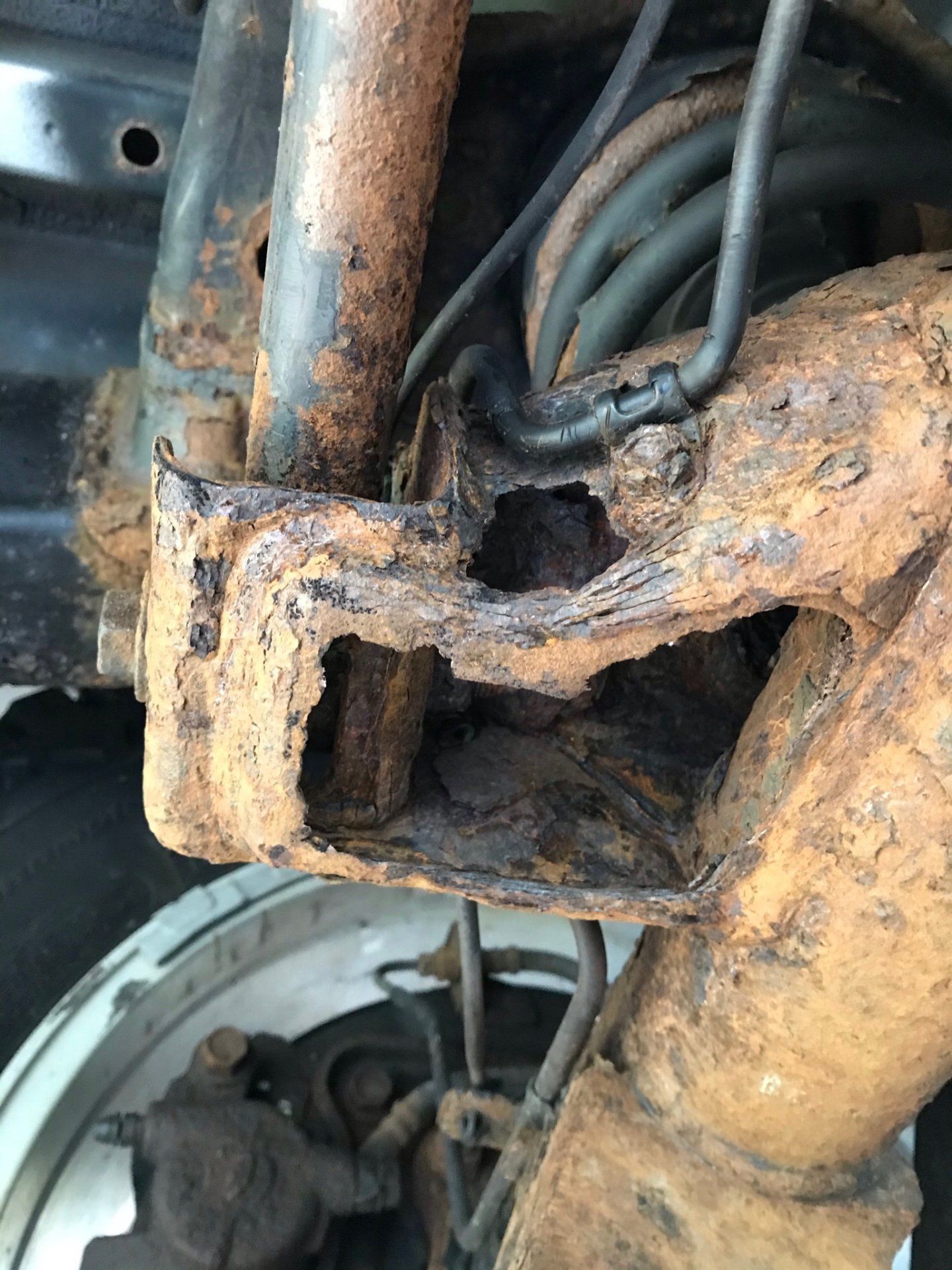

My 07 FJ is in the shop for frame rust repair and undercoating and the recommendation is to replace the rear axle housing so the hunt is on for a reman or used axle. The suspension cross member supports are toast. With 92k miles this 6MT is a keeper once the rust situation is addressed. Any experience with this and advice is appreciated.

Dear lord, where do you live? That is terrible.
I'm the second owner of my 2010, with the first owner (2010-2018) living right on the Oregon coast. There is zero rust.
Since buying mine, I coat the frame, axle and exposed fasteners with fluid film every fall.

A new housing is around 1200 from Toyota . I have one sitting in my garage but it has a bent shock mount .

I would be concerned about everything else under the FJ. That is a lot of rust.

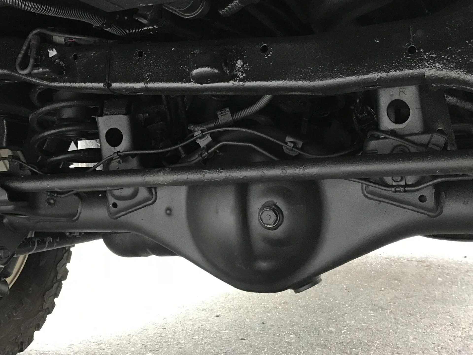

For sure, the rear end has the worst of it by far so we are thinking that a full treatment with acid etching and bed liner application to the underbody and frame will hold off the rust for a handful of years.
Good info - I am waiting to hear from the body shop this morning on what he could find for a housing but it helps to have a baseline in case he comes up with some astronomical price (which won't be too surprising).

Well - that axle end of the panhard mount is ready to bust off, I'd be worried when it does you may have issues keeping that street level look intact.
