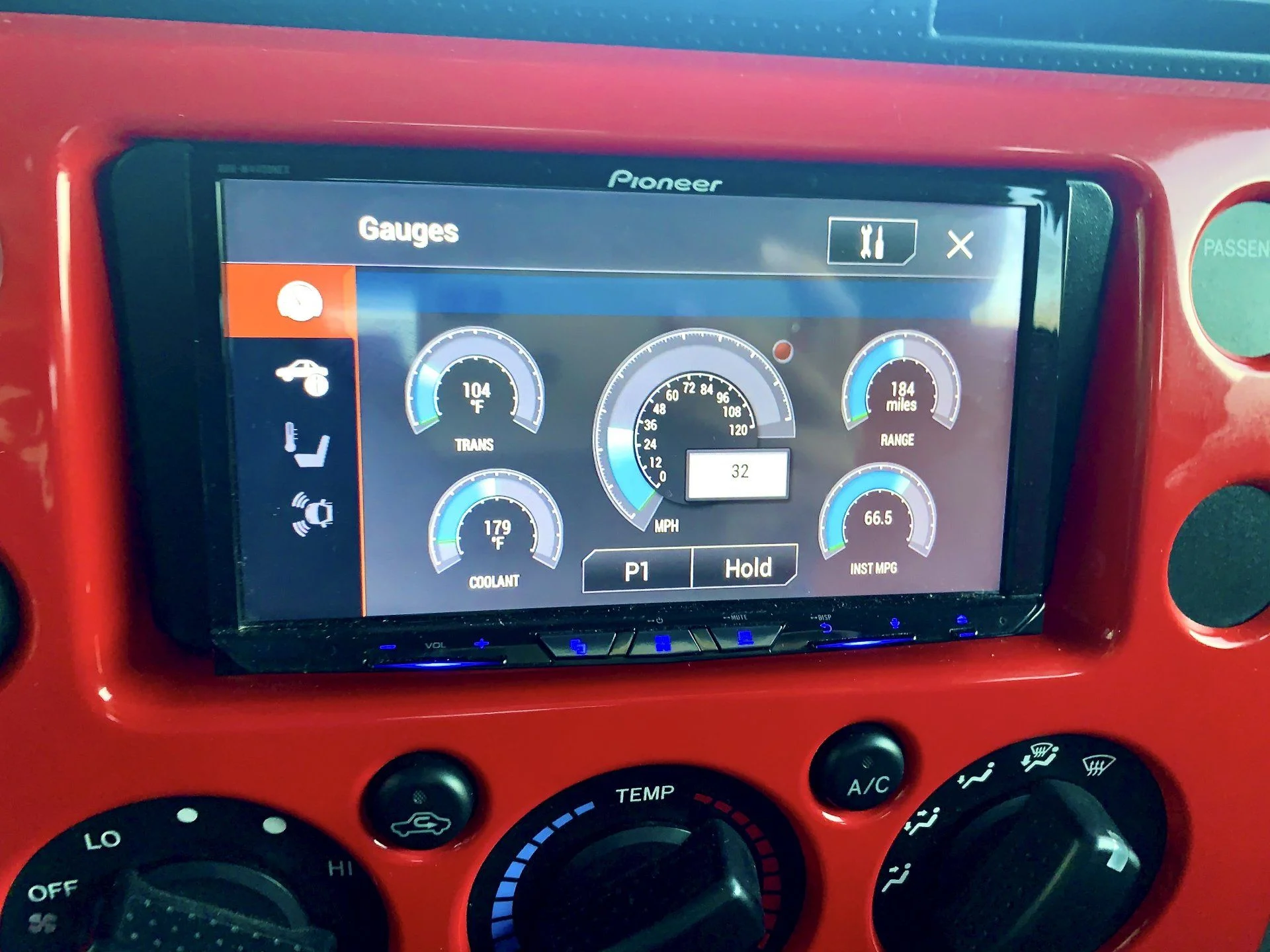

So this unit plugs into the OBD-II port?
Fully plug and play using maestro for steering controls and idatalink
everyrhing on steering controls works just like OEM

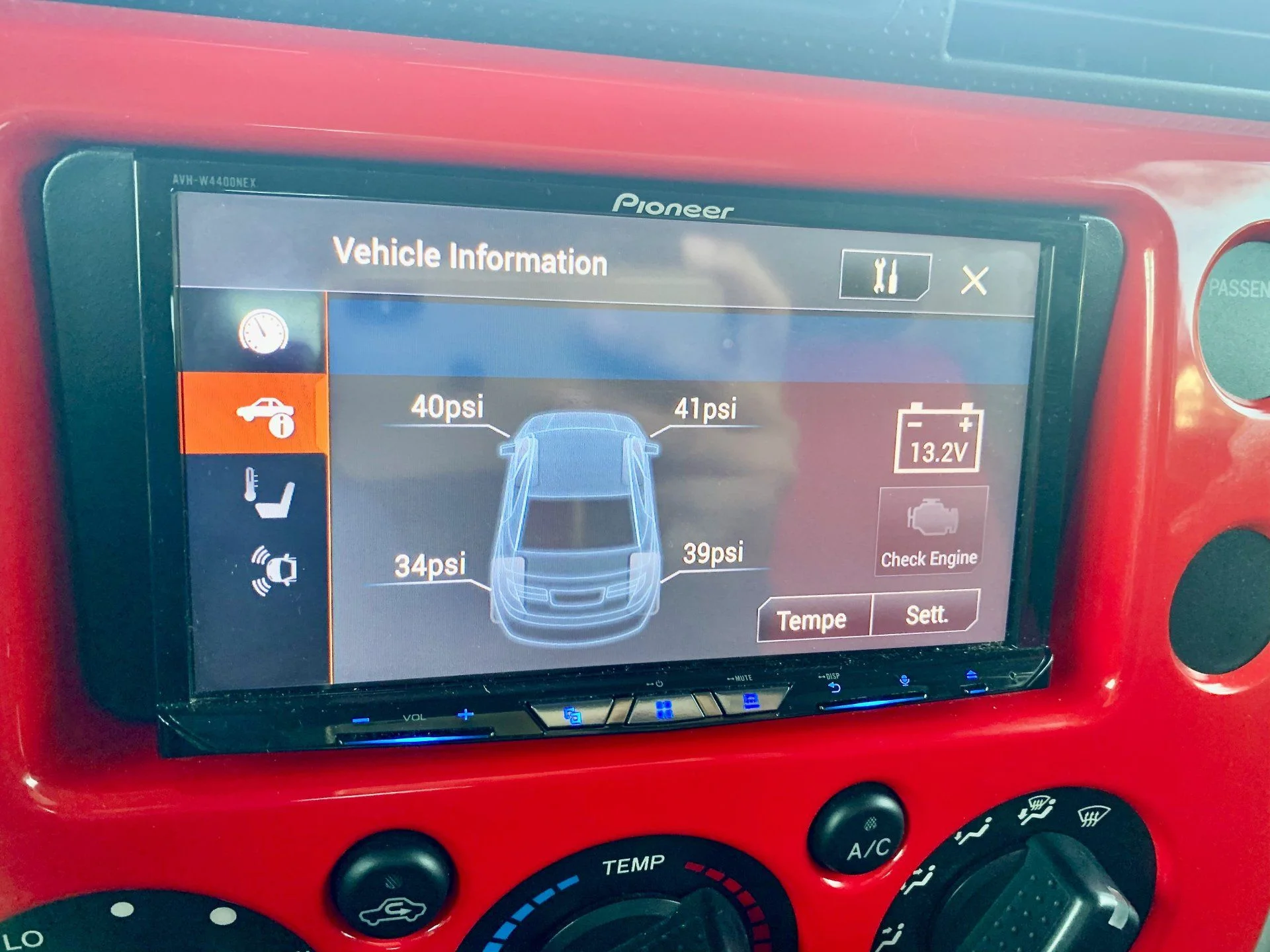

I get all the vehicle data - range/mpg and trans temp are what I use most. You can configure to much more data.
I get an additional rear camera display thats 7 inch in addition to the mini one in the rear view mirror
easiest install ever and best money I spent on “mod” as far as usability for my needs
I don't know exactly what that means (data interlink btw head and car's ECU I guess). I don't have steering wheel controls, so not worried about that. I have a Pioneer AVH-1440NEX headunit. I'm more curious about the data from the ECU and possibility of ditching the ScanGaugeII that I have. Does your headunit have the engine data app natively or its something you installed on your iPhone?
:banghead:Yes, I know how search works. I perused all their products for my vehicle. That site show products without explicitly stating what they do - if you are a professional A/V installer, it might mean something to you. I'm no electronics expert, so this ** is just a bunch of jargon. You guys aren't helping much by throwing links at me. I'm asking specific questions about @ryanCA 's installation, like how did you get engine data on your screen?
What you see in screens, nothing is from phone. All came "natively" as you said on the headunit. I plugged the head unit in the back. And walah, all data live.
I know 0 about electronics. I can do mechanical things all day long. I walked into best buy, bought the Pioneer, idatalink, maestro. Thats what hte guy told me I needed. Came home, spent 2 hours (first time in my life doing any audio work), installing it. Followed the how to. Plug and play meaning, I took the plugs and pluged into the other plugs that went into the old OEM head unit. No wiring, no splicing. As I don't know how to do those things with confidence.

I love the 7 inch backup screen. While playing with the unit, I found that it picks up all the things from the car's system, to show me. I tow my sand toys to the desert, havign the trans temp is handy.
Thats all I got buddy.
