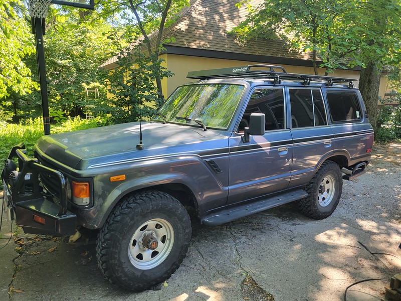

Here's my set up. 2" OME suspension with 255/85r16's. Slider are old redline step sliders I believe. Would be pretty easy to have something made like this. Protect your rockers and make it easy to get into and out of without re-doing your suspension.
