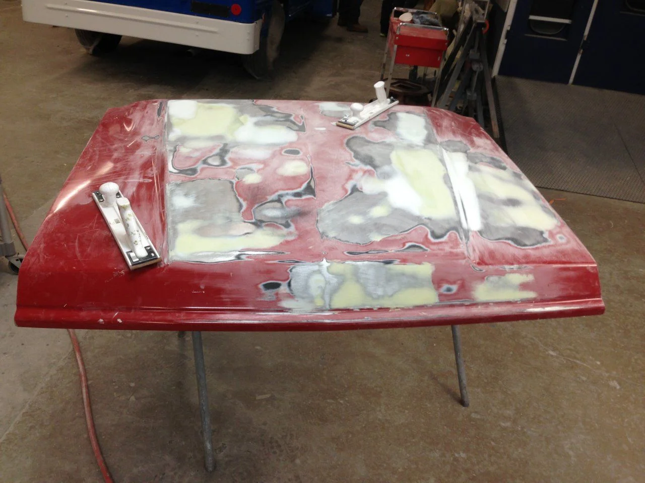

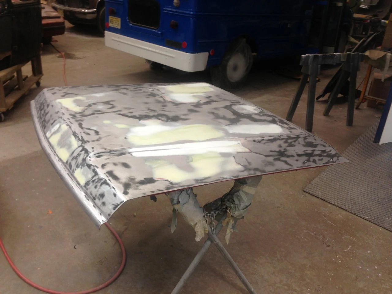

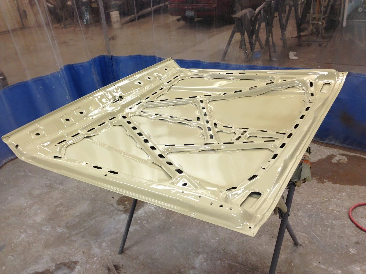

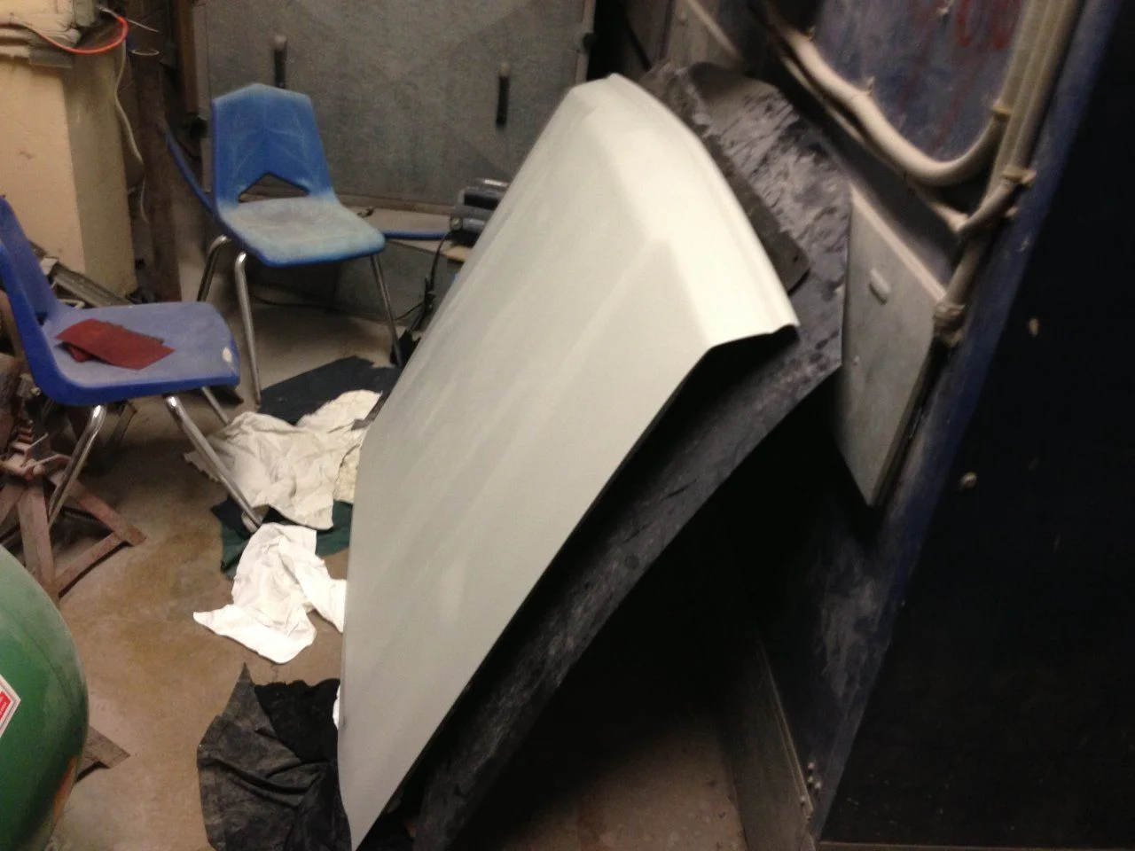

Hi everyone,
I picked up a used FJ-60 hood with no rust......but dents on almost EVERY inch of the panel. The hood was so dented that it should have been tossed, but I wanted body repair practice. My only guess is that an elephant walked across this hood.

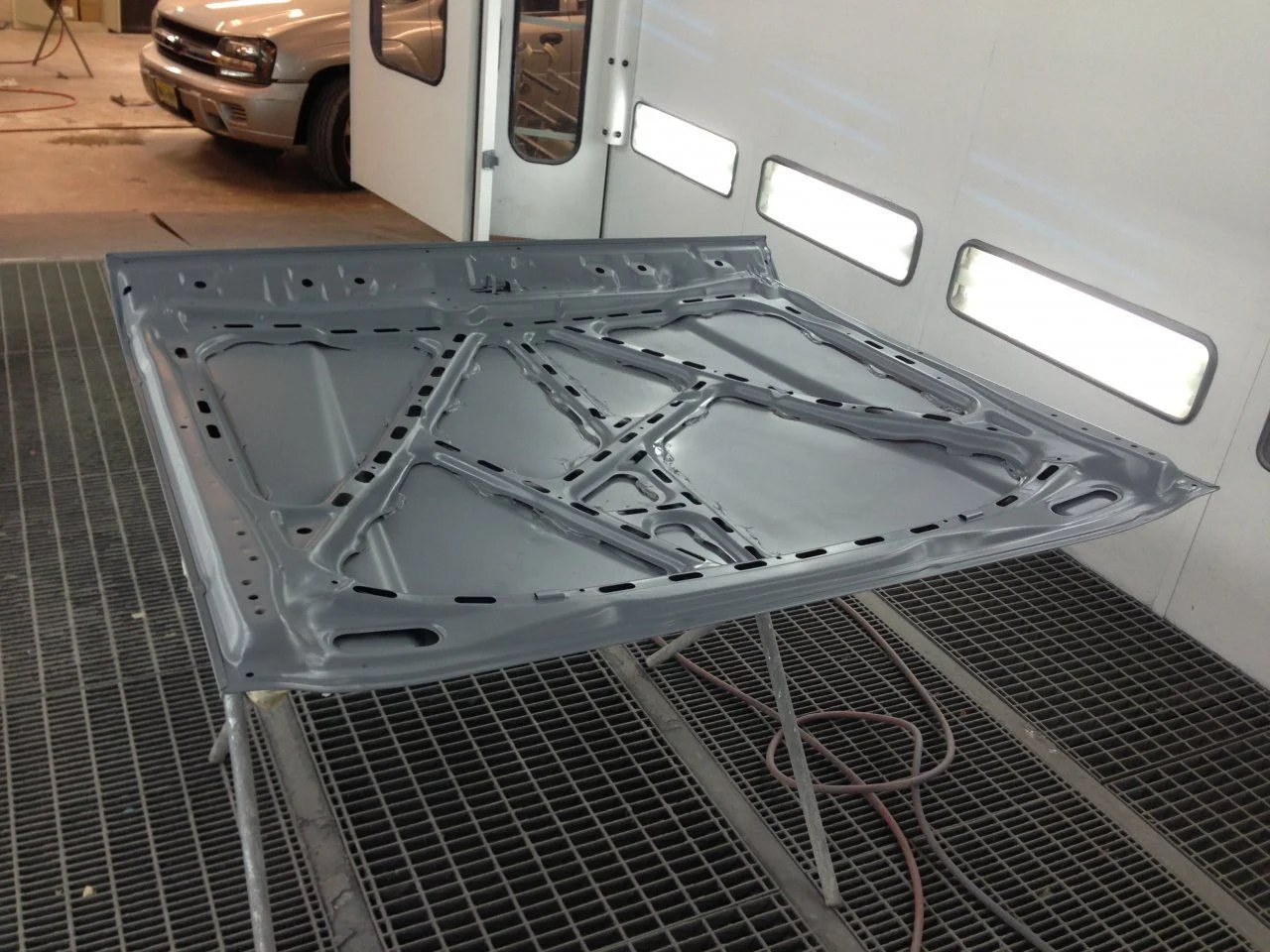

I set out to attempt to fix it. Given the numerous dents, some large and deep, filler was without question needed. The ribs of the hood were also separated from the hood frame, so they required attention as well. Hopefully in the next few days it will be ready for some 4E9 paint.
Zack

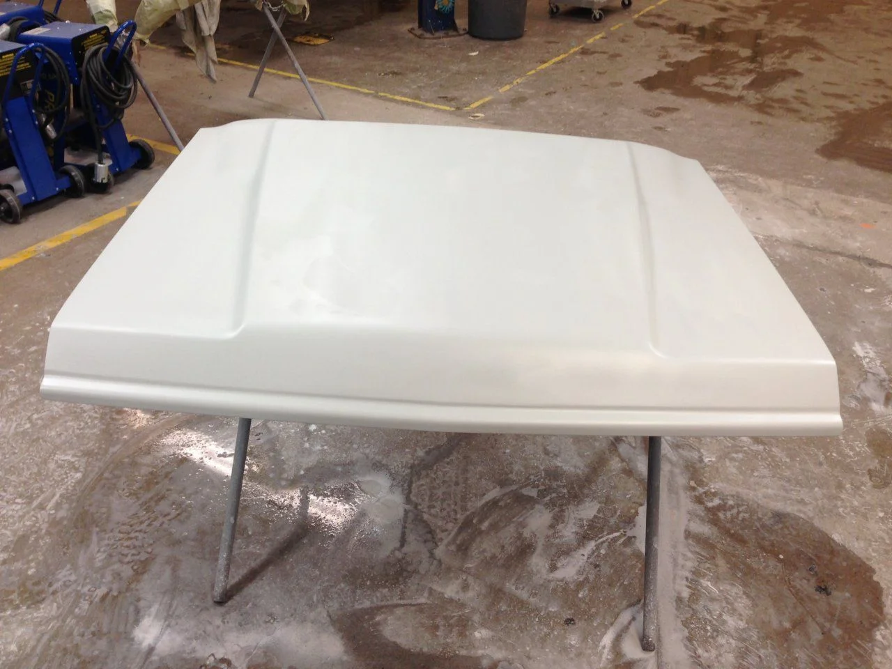

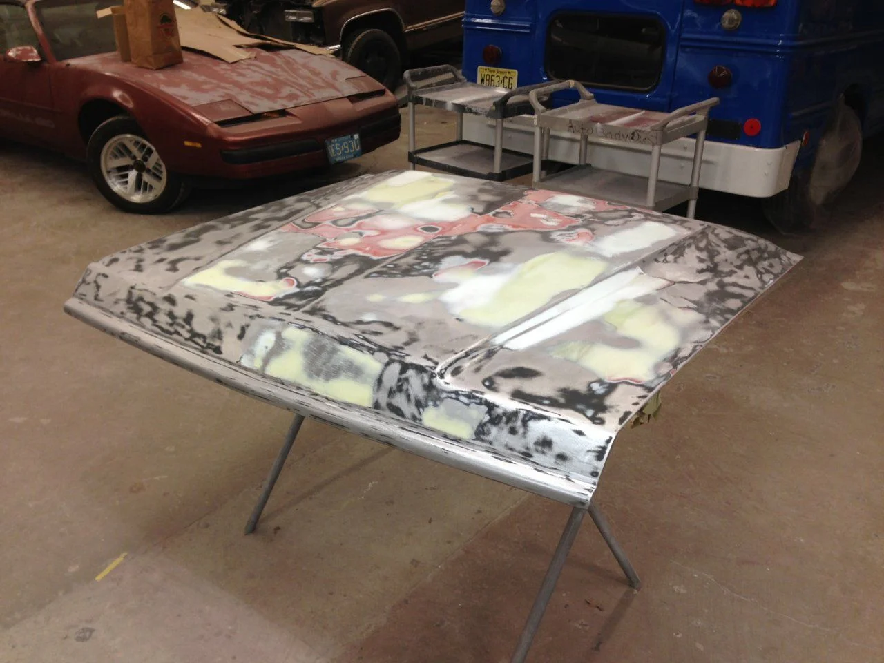

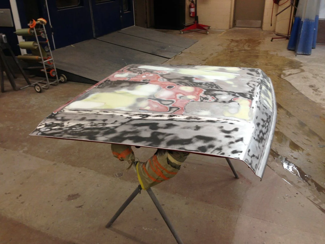

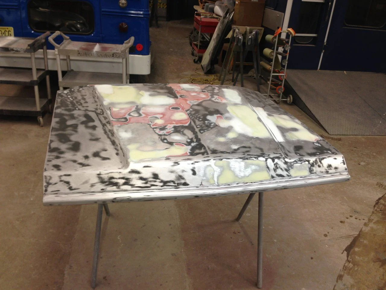

It looks like a major amount of filler, but the amount of filler on the hood is very thin. I did work the metal to get the dents out. My new favorite tool is the weld on stud puller.
Zack

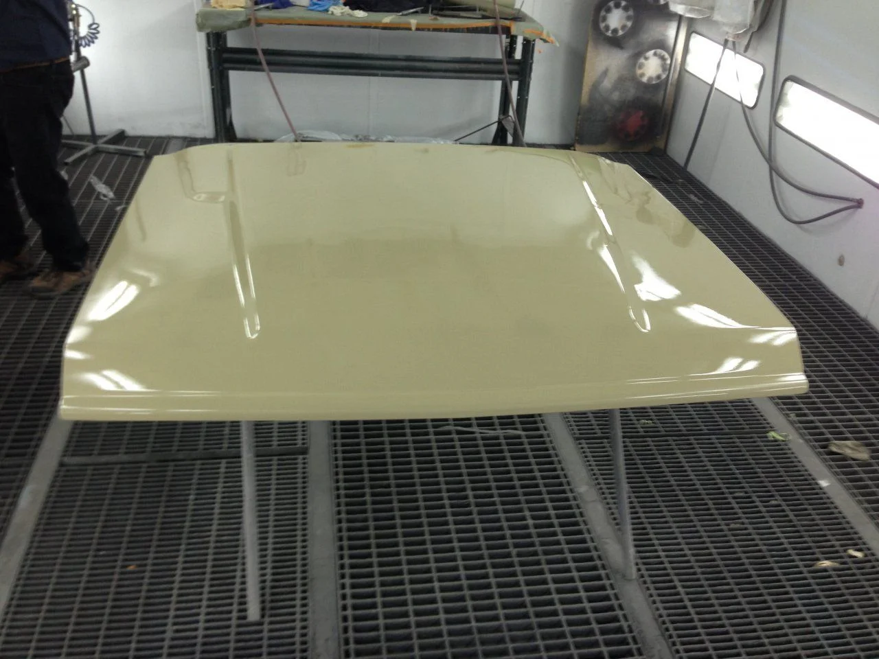

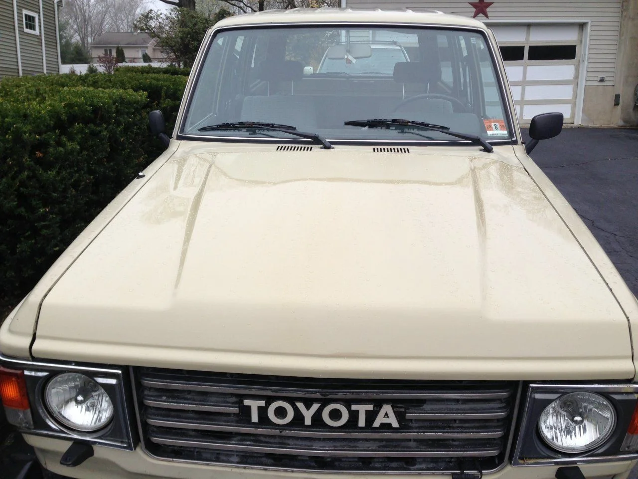

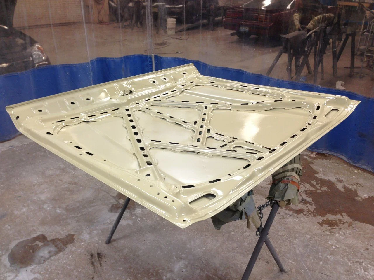

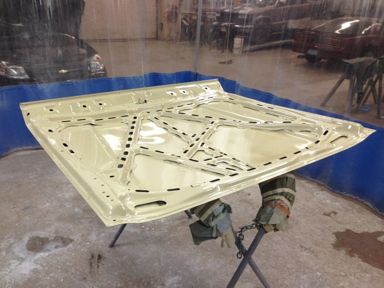

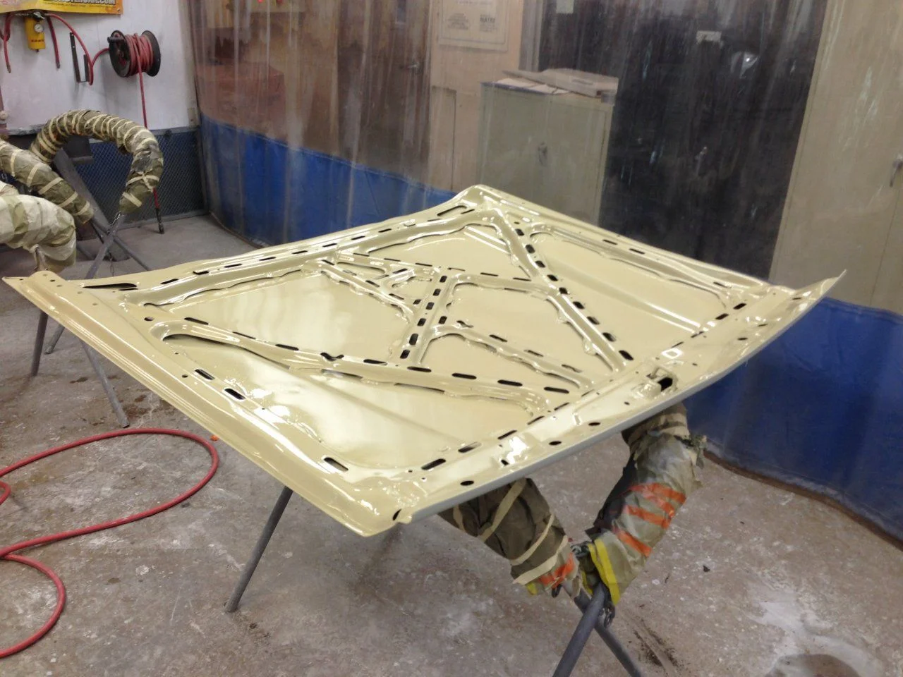

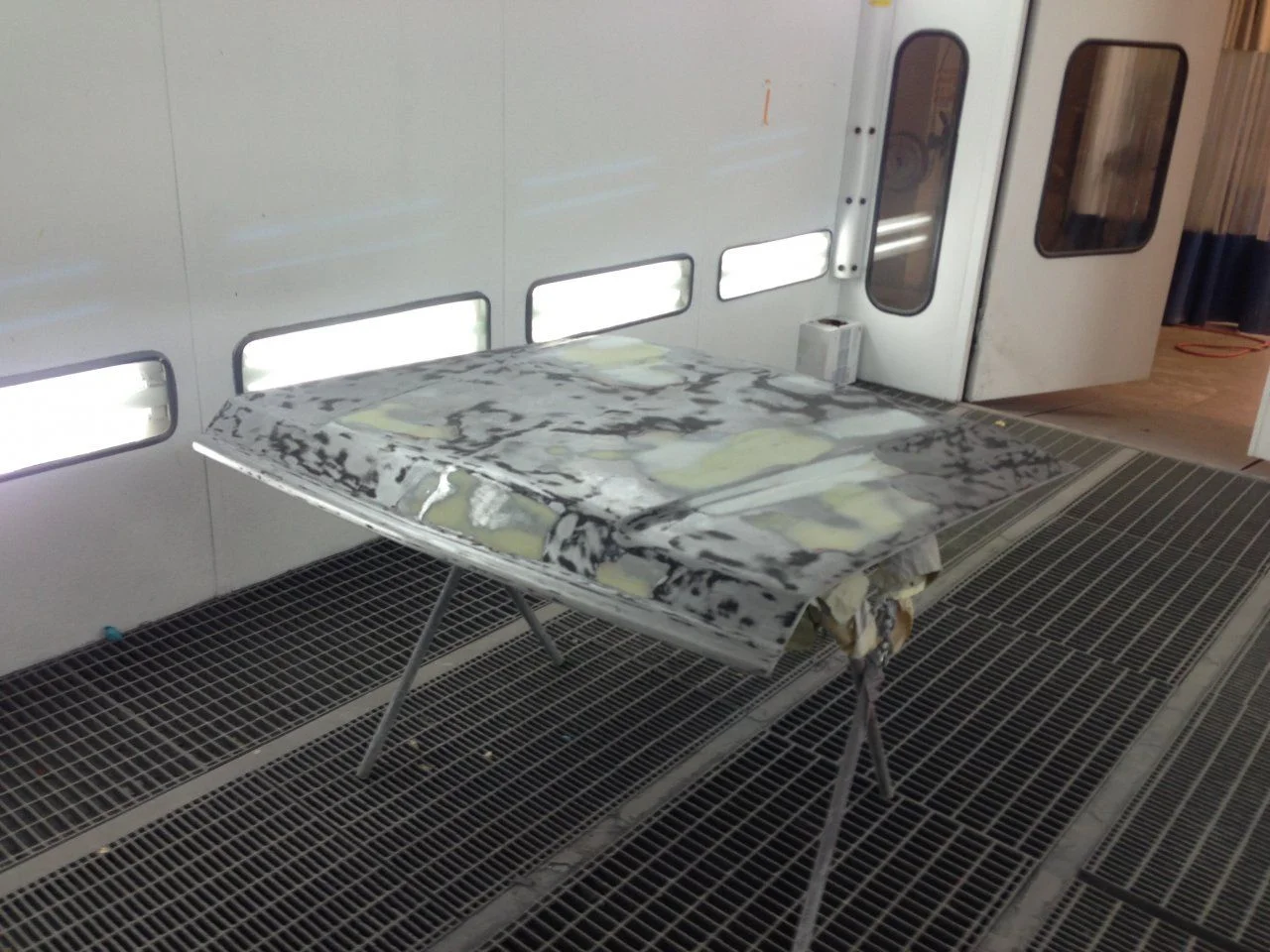

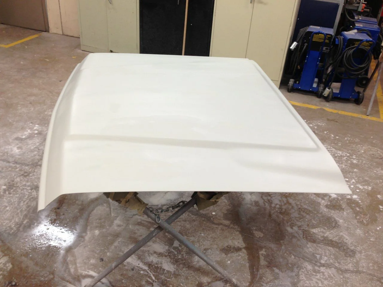

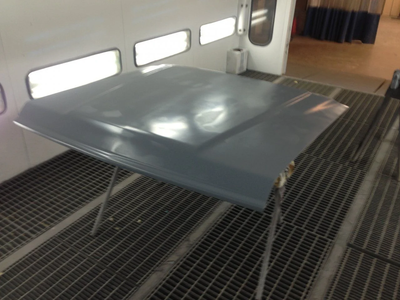

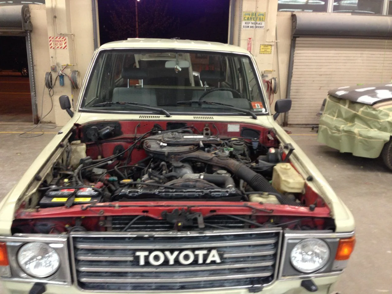

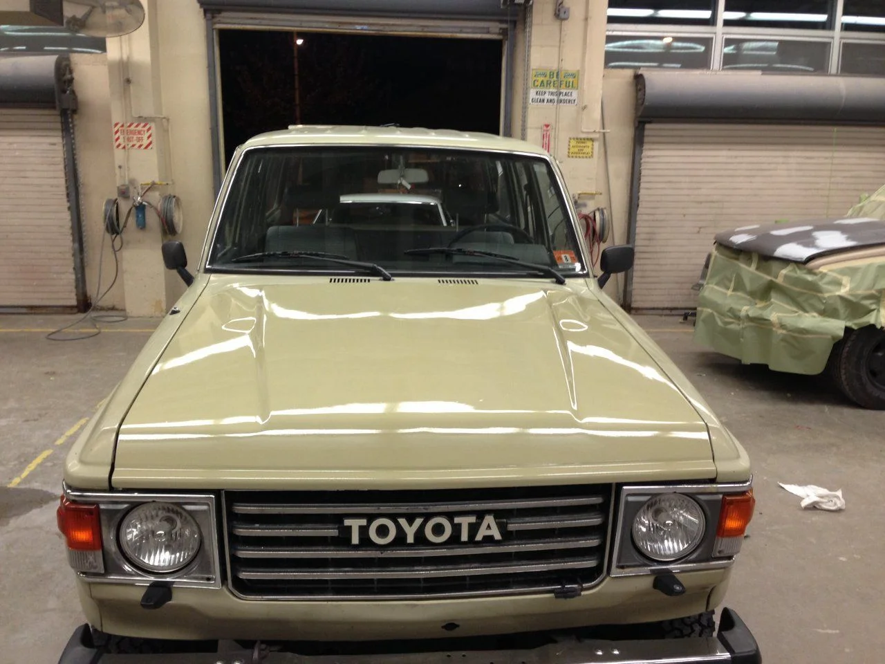

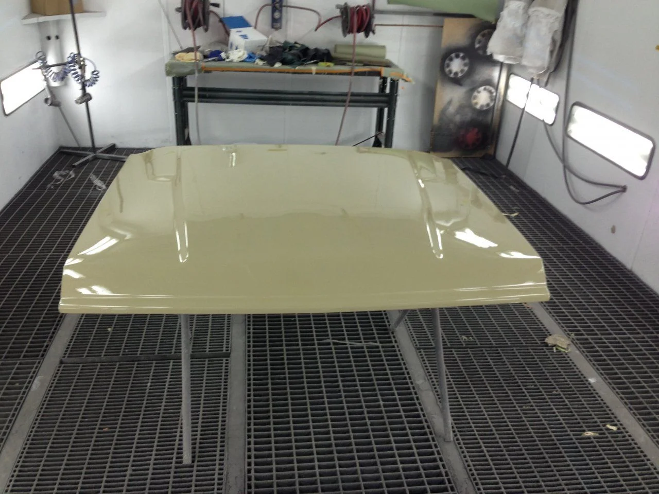

Ok well after a very long delay the hood is finally finished and installed on my FJ 60. I think it came it great, considering where it started from. Now the problem is that the hood is the best part of my truck!
I will let the pictures spaek for themselves.
Zack

Looks good. What product did you use to tack the support members back to the hood skin? Color code of the paint?
