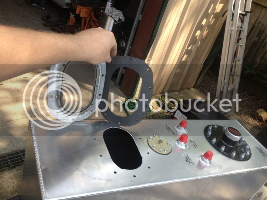

Thinking of using the stock Tundra fuel pump by cutting out an outer flange of the Tundra tank and bolt it down with a gasket on the RCI tank. Has anyone done this or know of any issues or concerns doing it this way?
Cut out the tank mount and a 3/4" flange, going to wait to cut the RCI tank for some clarification if it should work.

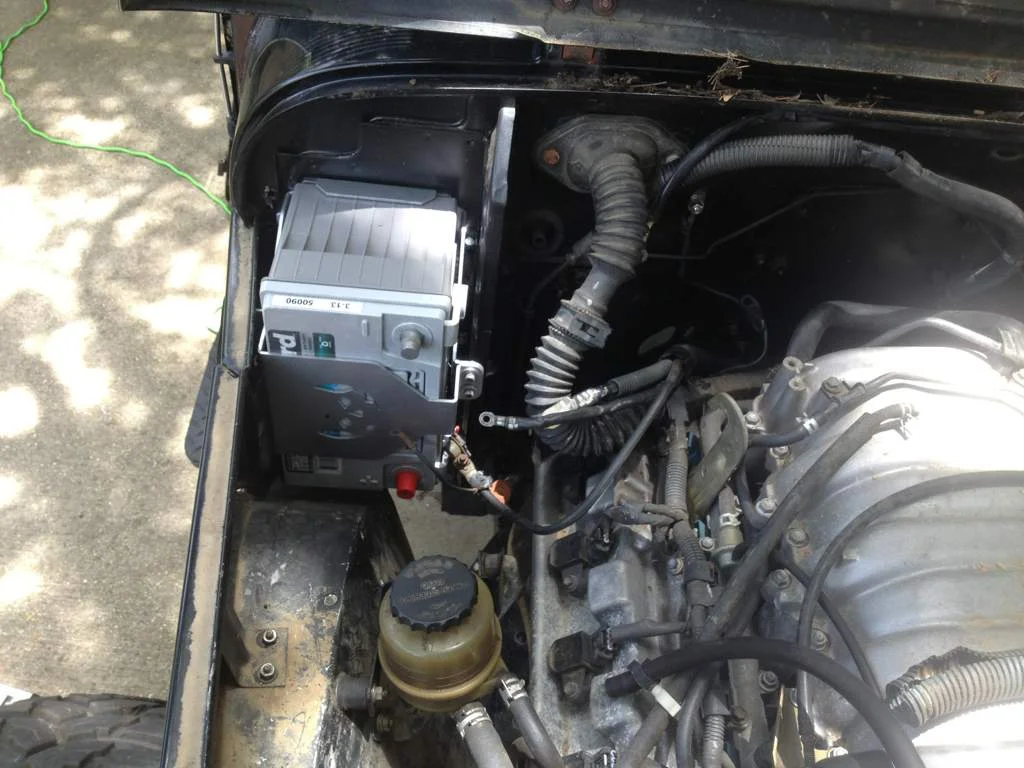

Finished up the air intake hoses and moved the fuse box down the fender some to make room for the evap canister. Fabbed up a bracket for the canister to slip into that bolts to the fender, which allows the sensor connection and hose connections to be made easily.

Found some gasket material at Napa that is 1/16" thick and designed for fuel pump use. So I cut out a gasket and a hole in the tank, before bolting it down to the tank. The hard section of the fuel pump sits about 1/2" from the tank bottom and the sock section can flex down enough to touch the bottom.

hope you are right about the application use the list of other items makes me think of mechanical fuel pump the ones on the block.
take a pice of the material you cut out an immerse it in a container of fuel c how it does.
if it swells& deforms like I think it will.
go to acadian a rubber & gasket on Simcoe they can fix ya up.
I have a small roll of rubber gasket material from Acadiana Rubber and Gasket John I'd be happy to give you a piece for your needs. I used a manual hole punch and this material to seal a few sending units among other things and it holds up well.

Submersed a couple of pieces in gas for at least three hours without any changes to the material, but if Larry can spare 5"x8" section of the other one I can make a spare.

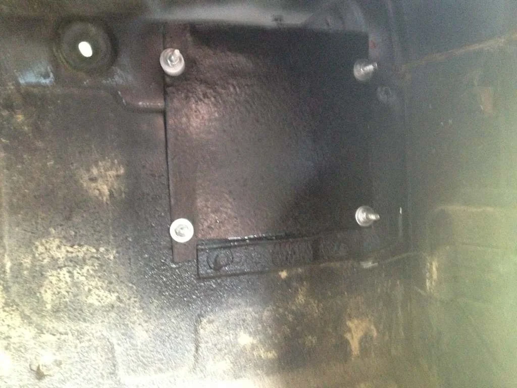

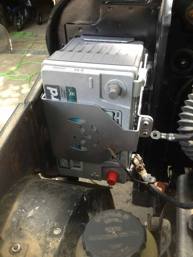

Battery mounted with a cover plate for the old blower fan use to be. Pulled the main power wires across ready for termination with GM style connectors. Do not suggest the hinge style battery box, I will have to unbolt the whole thing to get it out.
