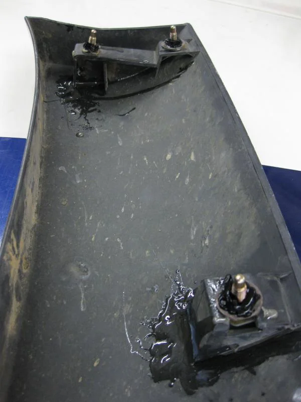

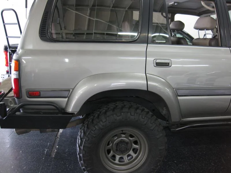

Then I fixed a used rear flare I purchased with some epoxy. Used some more silicone around these mounting points also. Inside and out...
Sooooooo much better with the missing flare replaced! I am really happy.:cool:

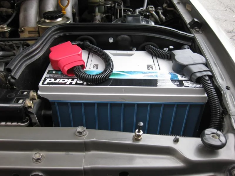

Started on my dual battery installation. The main purpose of my second battery will only be for an emergency jump. My fridge and other ACC's will run on the starting battery. I will not be installing a self jumping switch, but instead rely on jumper cables that I always carry.
Parts list:
Optima RedTop Starting
Sears DieHard Platinum Marine Battery Group Size 31M

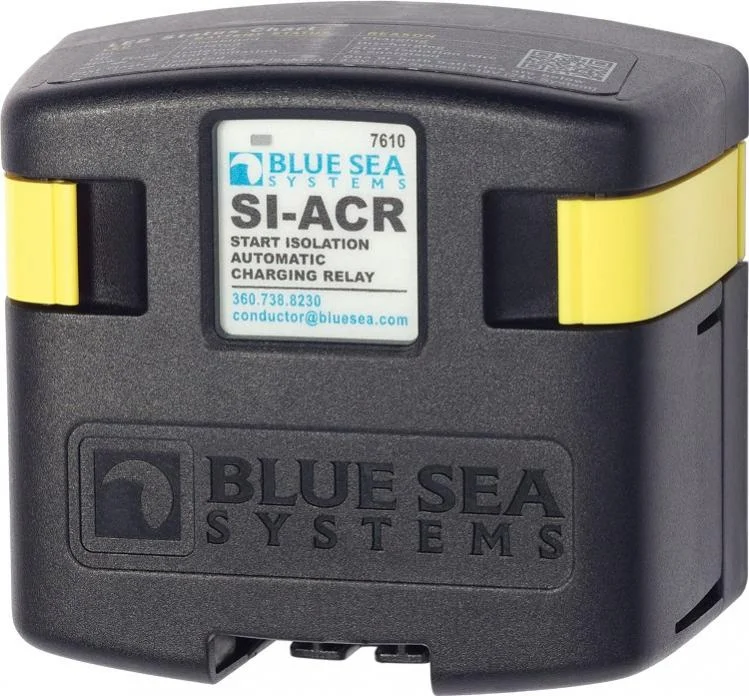

Blue Sea Systems Solenoid SI Series (120A 12/24V ACR)
Slee washer bottle relocation kit
New OEM passenger side battery tray

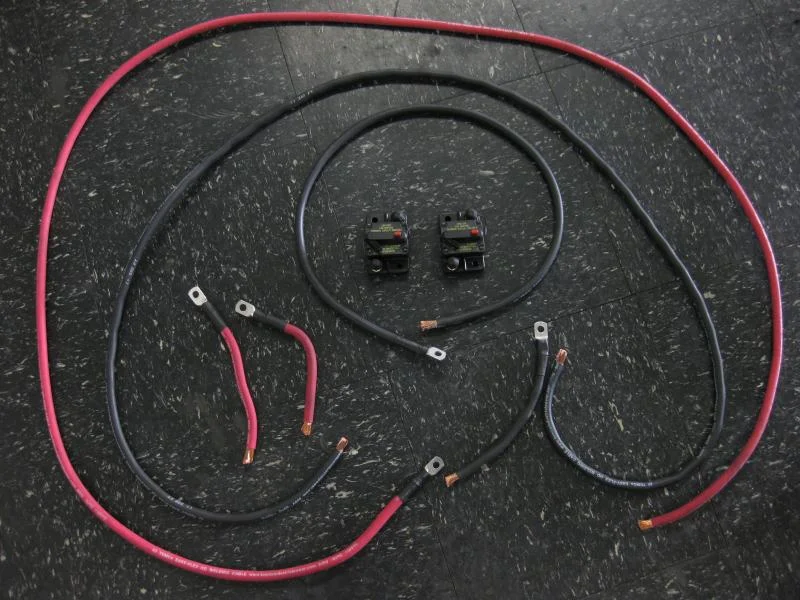

2 AWG welding cable
16 AWG wire for Isolator ground
Two 100 amp Bussmann circuit breakers
1/2" split loom to protect cable
5/16" and 3/8" battery lugs
Four military style battery terminals

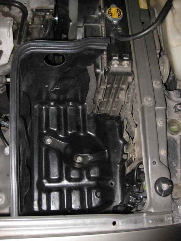

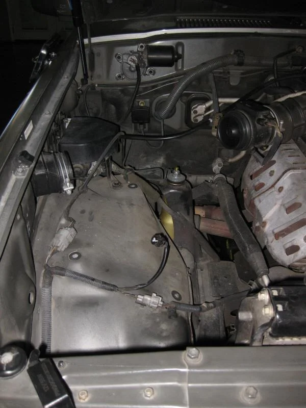

Removed necessary items.

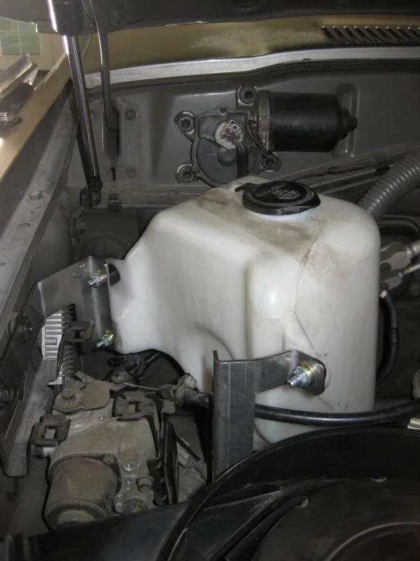

Relocated washer bottle.
Installed battery tray. Only three bolts installed as of this pic. The battery tray kit was supposed to come with all the hardware, but the five bolts for the tray were missing. Replacements are on their way in the mail.

Which Blue-Sea isolator are you running?
Sent from my iPhone using IH8MUD
Great, that's the one I am looking at. Subscribed.

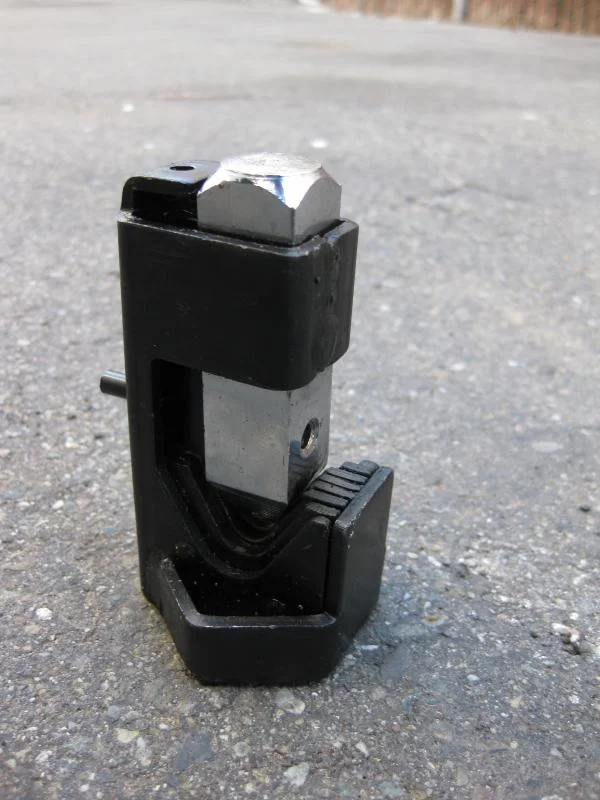

I am using this lug crimper for all the cable ends. Makes for a really strong crimp.
Measured, measured, then measured and cut all the different cable lengths that I would need. All the 5/16" lugs installed, waiting for my 3/8" lugs in the mail.

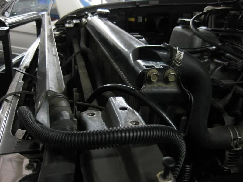

I removed both battery trays and the center radiator support. This will make it easier to install all components and run the cable from one side to the other. My ground for the second battery will be connected directly to the primary battery. Both the + and - cables will run through here.

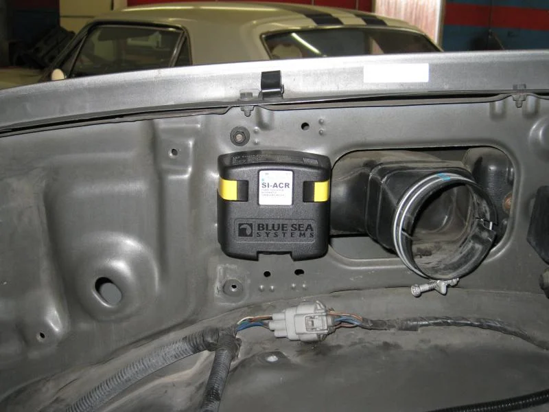

The Isolator mounted to the fender.

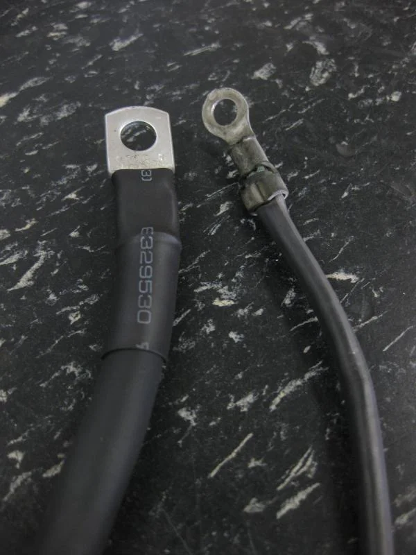

Bent the lug to match the factory block ground lug.

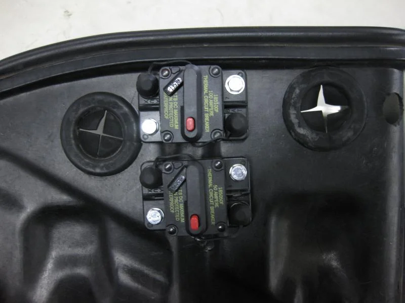

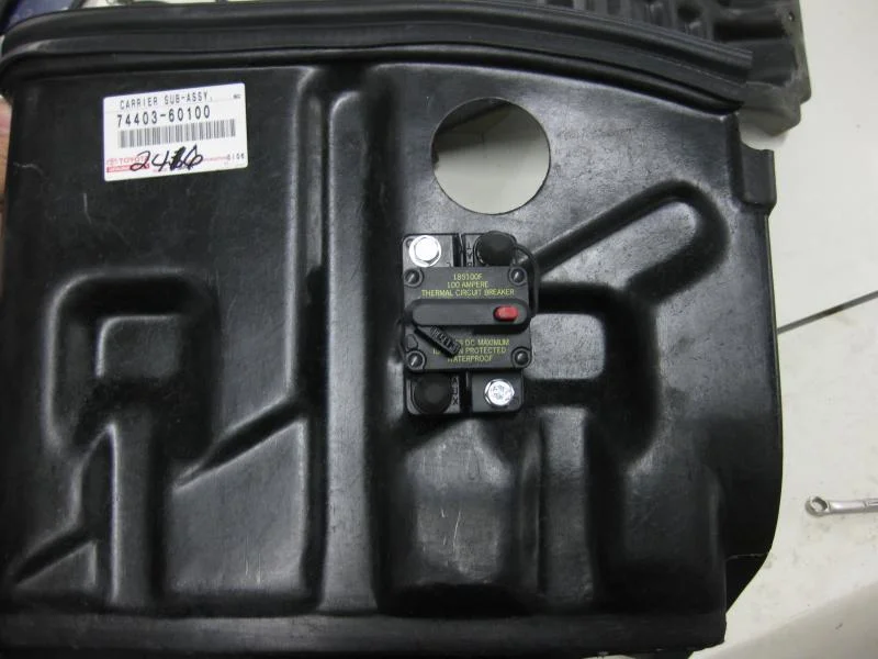

Mounted relays to battery boxes.

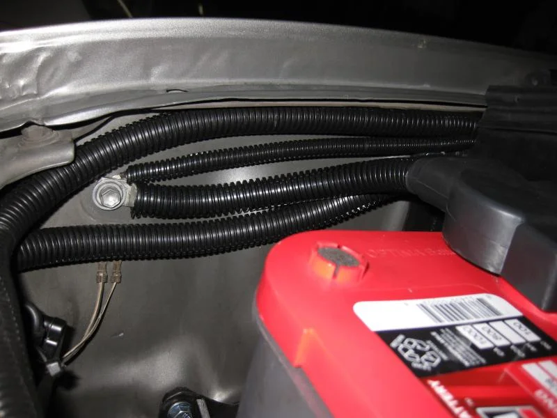

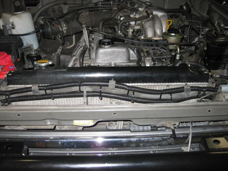

Finished routing + / - cables and reattached OE clips to secure to center support.

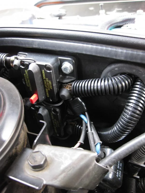

Relocated fusible links to battery side of relay. Way less strain on the wires now.

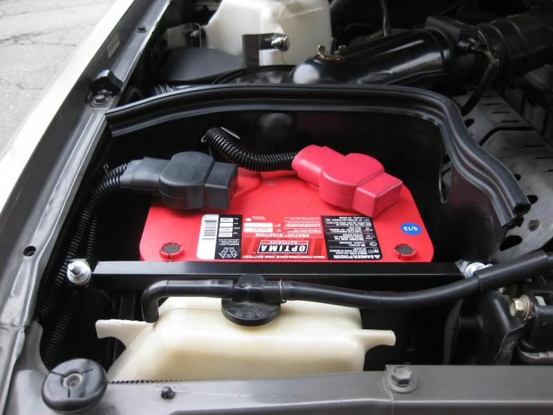

Finished install. Works great!

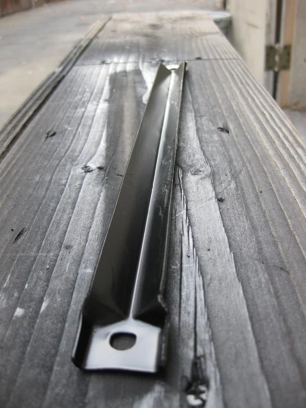

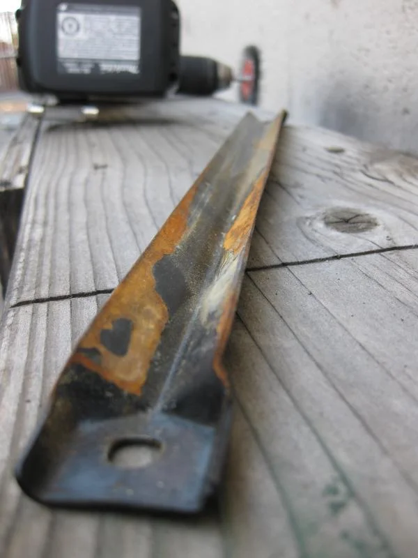

Refurb'd factory hold down but doesn't quite fit the new battery. Purchased longer J-hooks, but they are standard thread. Anyone know of an OE equivalent J-hook that will work for this 31M battery? Going to make a hold down. Field trip to HD!
