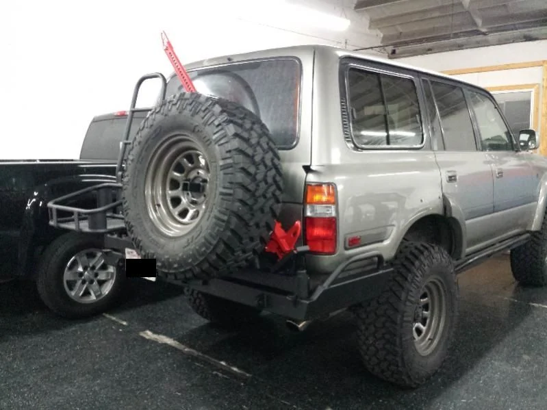

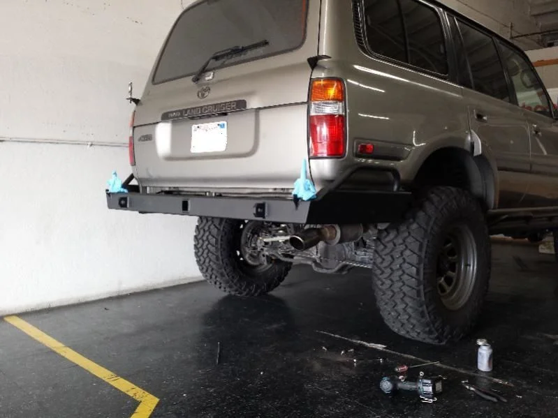

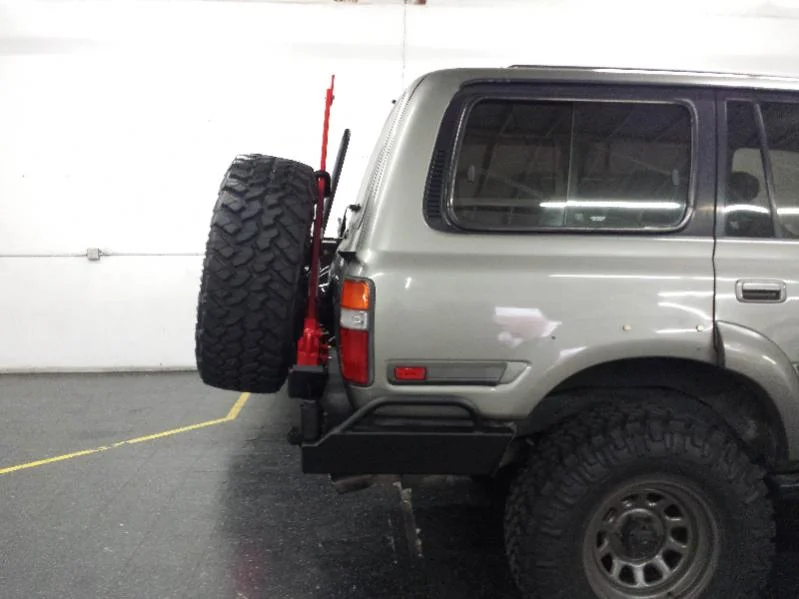

Had a chance to install the main bumper. I can't wait to finish it tomorrow!
nice!! who makes that bumper like username wise??
Sweeeet! Can't wait to see the finished product!
Tease! I thought you would have had it all done by now :) You pick up your spare tire/rim yet?
Oh, I finished it yesterday!:D
I had the spare rim made last year. It has been sitting lonely in my garage waiting for a home.
I was installing it during working hours, but had to postpone because it got busy..:frown: It was sooooooo hard just to look at it and not get to drive it home!

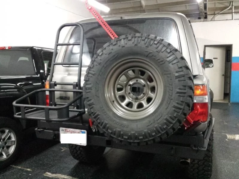

Drum roll please............
Side shot....
This bumper is built nice!!!!
it look amazing. love how it sits nice and tight to the rear hatch!
Thanks man.:beer:

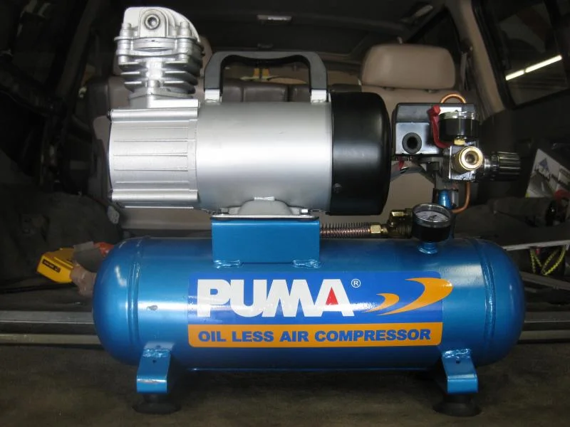

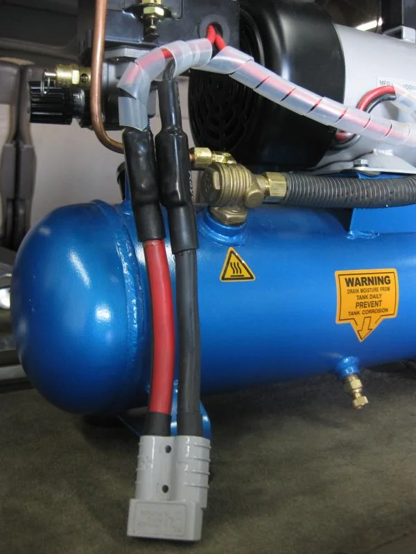

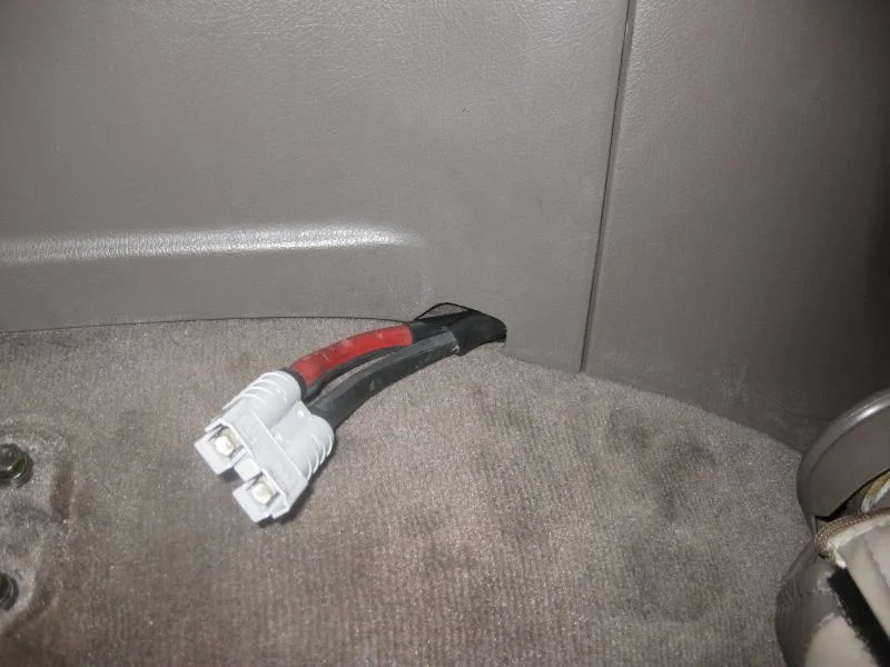

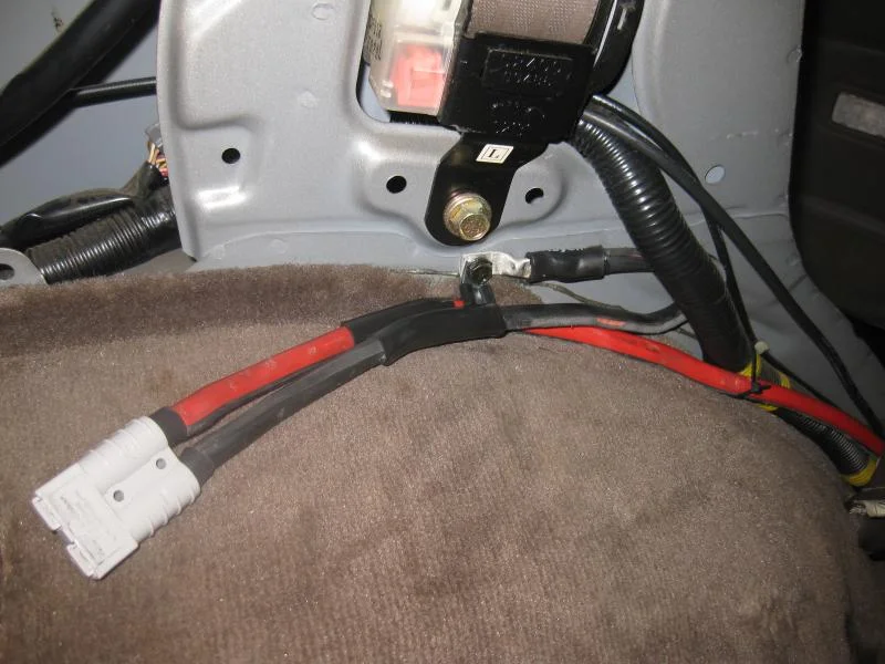

Puma compressor, added an anderson connector to the pump with 4awg wire. I used jumper cable wire and butt splices from Home Depot.

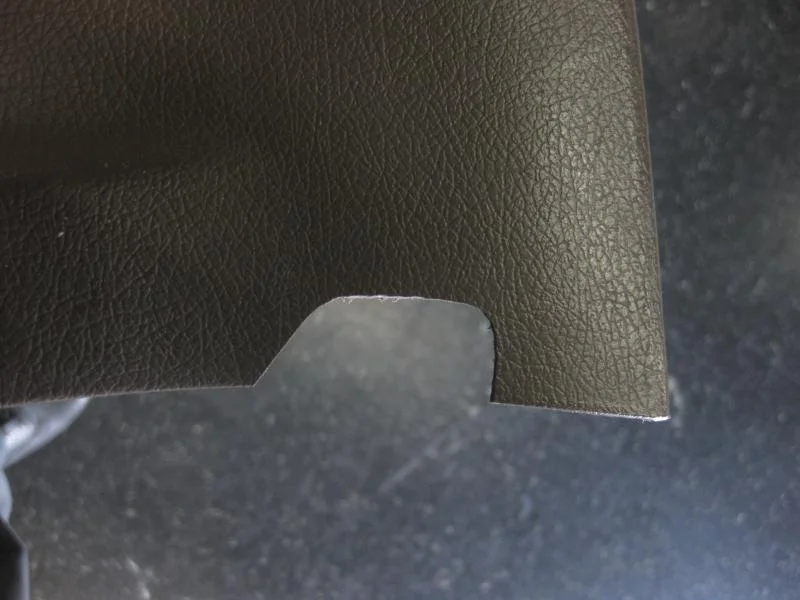

I have finally gotten around to running the cable from the main battery to the drivers rear corner panel. Cable runs through an existing firewall grommet and under the door sill..
Then notched a hole in the cover for the cables to stick out of....
I installed a 50amp breaker on the battery box and grounded to the rear body panel.
Nice and tidy with the cover on!:bounce:
In the future the Puma will be mounted on the wheel well.
:beer:

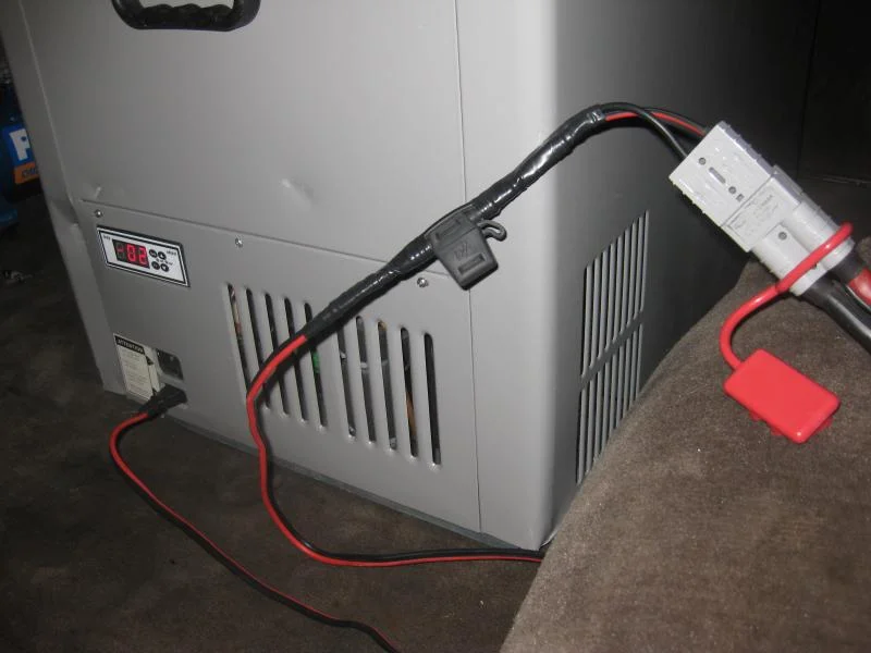

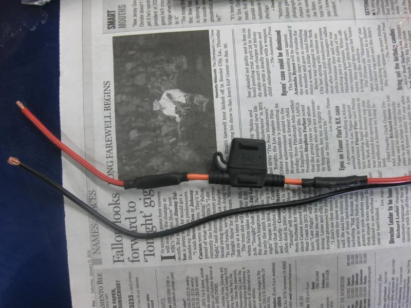

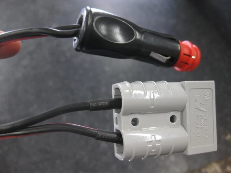

I will be using the existing Anderson connector for the Puma, to power the fridge. I cut off the fridge cigarette adaptor and added an Anderson connector with an inline fuse holder of 15amps.
I also installed a connector on the other half of the cigarette adapter. This way if I need/want to use it in another vehicle, it can be plugged in.

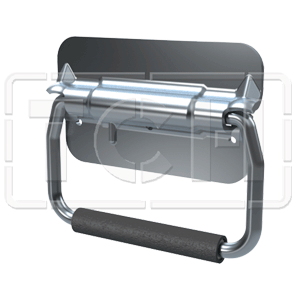

After reading and first hand experience, I've confirmed that the plastic handles on this fridge are very weak. The handles can easily seperate from the base, causing it to fall to the ground. If you secure the fridge to the truck with straps running through the handles, you could see where this could also be a problem.
I can't find who to give credit for the idea at the moment, but below is the link and a pic of replacement handles. I will feel much better carrying the fridge around and securing it in the truck with the new handles.
http://www.tchweb.com/tchstore/prod...ce-Mount-Handle--without-Mounting-Holes-.html
Using the old handle as a guide, mark and drill holes in the new handles. Then mount with existing screws...
I will add more pics when they arrive.

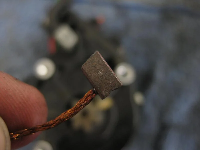

Left rear power window has never work right since purchasing the truck. The window would only go up or down an inch or two before stopping, or further with the aid of physical motivation. I lubed the seals with Gummi Pflege Stift. This helped speed things up on the other three windows,..... but not this one.
I removed the motor and tested it, only to get the same results. Upon disassembly, I noticed the brushes were pretty worn down.
Replacing them would not be cost affective, so I ordered a Dorman brand motor off of Amazon.
Dorman motor R/F and L/R: http://www.amazon.com/Dorman-742-600-Window-Lift-Motor/dp/B000E35WEC/ref=sr_1_1?ie=UTF8&qid=1391558353&sr=8-1&keywords=Dorman 742-600
Dorman motor L/F and R/R: http://www.amazon.com/Dorman-742-601-Window-Lift-Motor/dp/B000E323F8/ref=sr_1_1?ie=UTF8&qid=1391558393&sr=8-1&keywords=Dorman 742-601
Top one is the new motor and bottom one is old. The screw holes are not threaded on the new motor housing. Instructions say to use the OEM screws, and they will self tap new threads. I was a little hesitant, but I must say it worked out great.
Came with an assortment of attachments, with the yellow one fitting the truck.
After installing the motor and testing it worked great! HOWEVER, after installing the door panel, I realized they wired the connector backwards. So up was down, and down was up.:doh: I took the panel back off and reversed the terminals inside the connector. Now it works perfectly! :cool: Only thing now, this is the fastest window on the truck...:hillbilly:

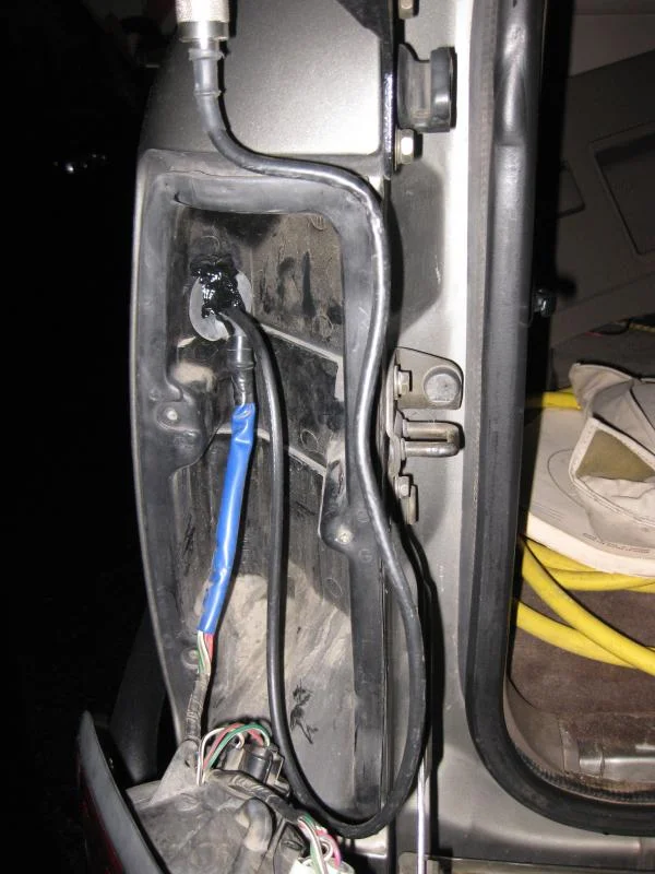

I permanently routed the CB wire through the L/R light housing. No more squeezing it between the rear hatch.

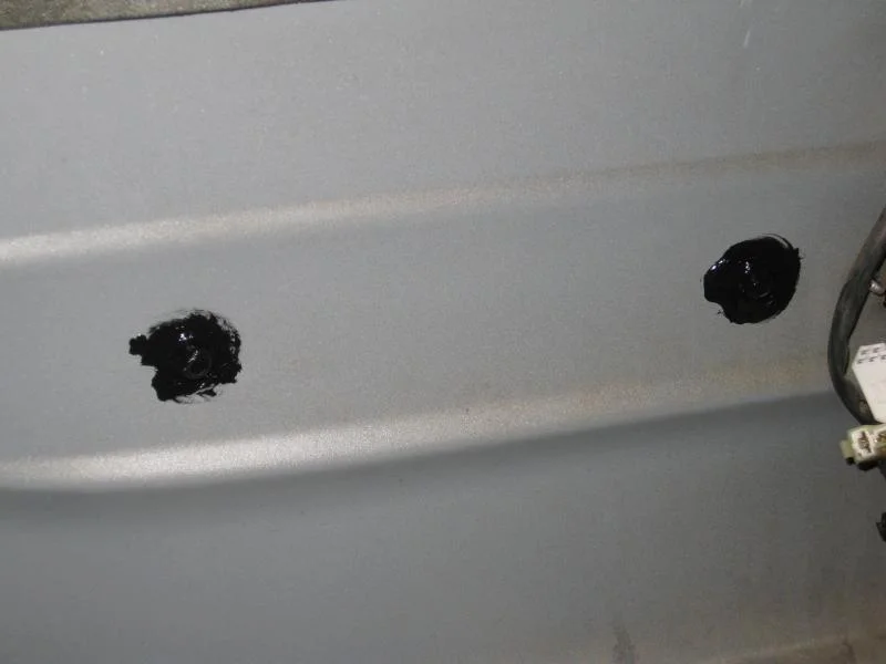

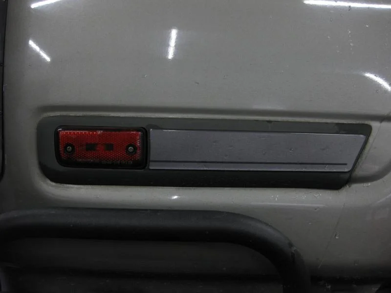

Fixed some water leaks coming from the side marker holes/clips. I used silicone around the side marker light and re-installed. Then also put some around the bolts/holes on the inside of the panel. Nice and dry now!
