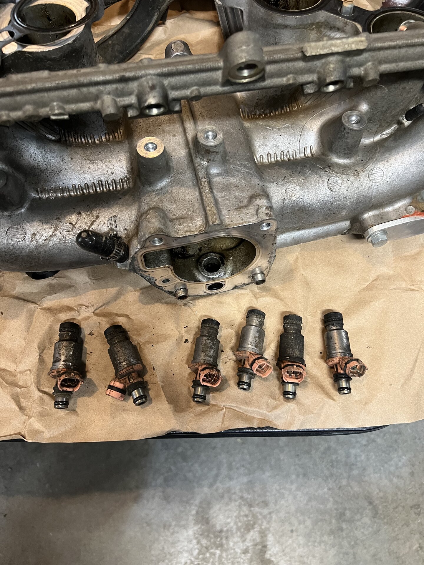

I got the injectors out. All the seals were as hard as rock. Not surprising, in retrospect. Sending them out today to be cleaned and rebuilt.

Did you break any of the wiring harness connectors at the injectors?
It would be a miracle if you didn't.
Haha... Yes, I broke the one on the #6 injector. Surprisingly the other 5 survived. They're all brittle though.
Fortunately I bought new connectors from Ballinger Motorsports that I plan to use to replace the old heat damaged ones.
I broke the nub off of 3 of my injectors when I removed them. Didn't notice until I got them back from WitchHunter and went to install them. So I have 3 new injectors and 3 originals.
