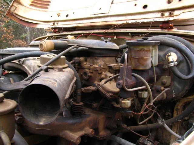

Hey I found a picture:

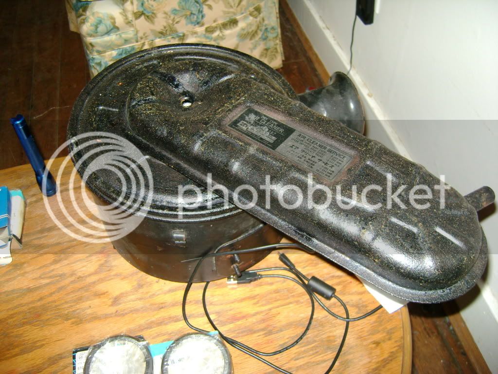

Here's a couple of pics of my setup. First pic is with everything snugged down. For the second one I loosened all the clamps and wing nuts and gave things a shake. The AC lid still looks level to me. What I don't remember is whether I used the '77 or '85 insulator and that could be why the AC lid sits level.
At this point it really doesn't matter because this setup has been working for me.
My original question was for the benefit of BBQ Boy as he needs an air cleaner and I have an extra but it's from a later 2F.
You are right, it all looks like it lines up perfect.
So apparently something is dropping the 77 carb enough that it is the same height as the shorter 81 carb. :hhmm:
