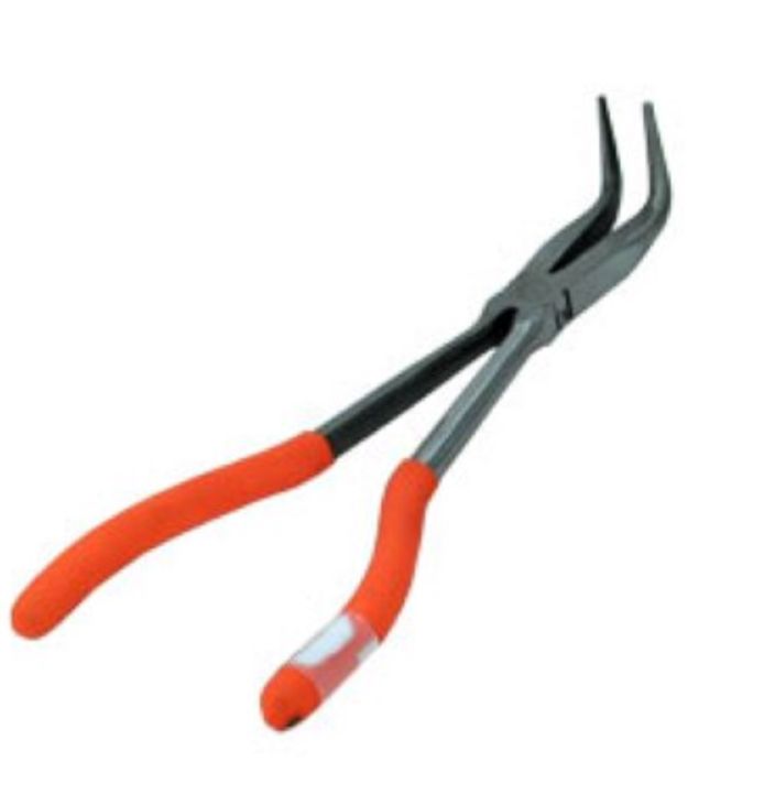

I think I’d try something of the below variety and if not successful go with #2.

I would try some tweezers or angled forceps as @taccruiser97 mentioned...otherwise I think the plastic is soft enough that if it gets caught in the gears it's going to mulch it.
