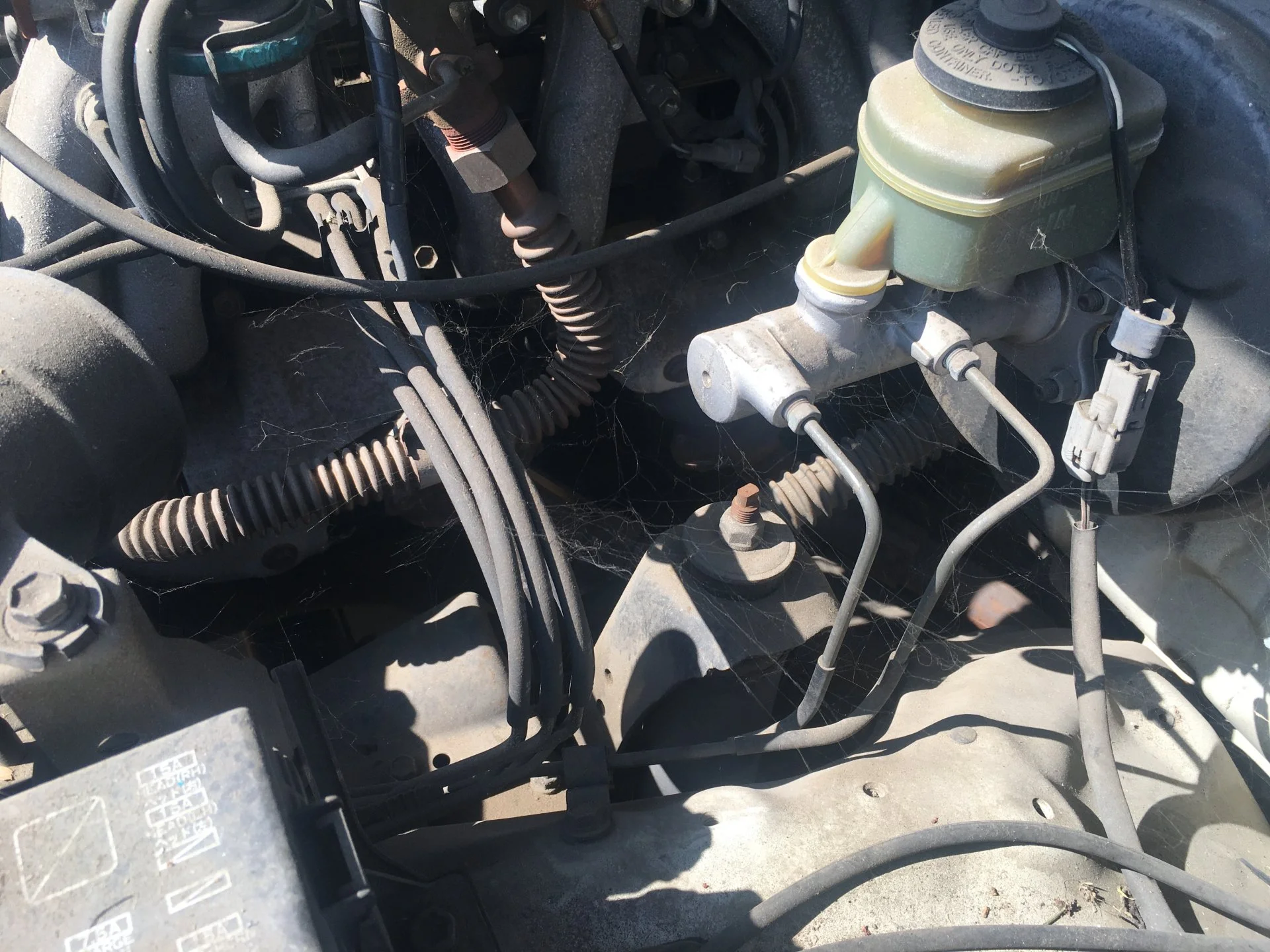

where can I get a good copy(hard or digital) of the FSM? also i was thinking of removing the spark plugs and boroscoping the top of the cylinders to make sure the rings havent rusted in case of any H2O that got into the cylinders (maybe head gasket went bad while sitting)

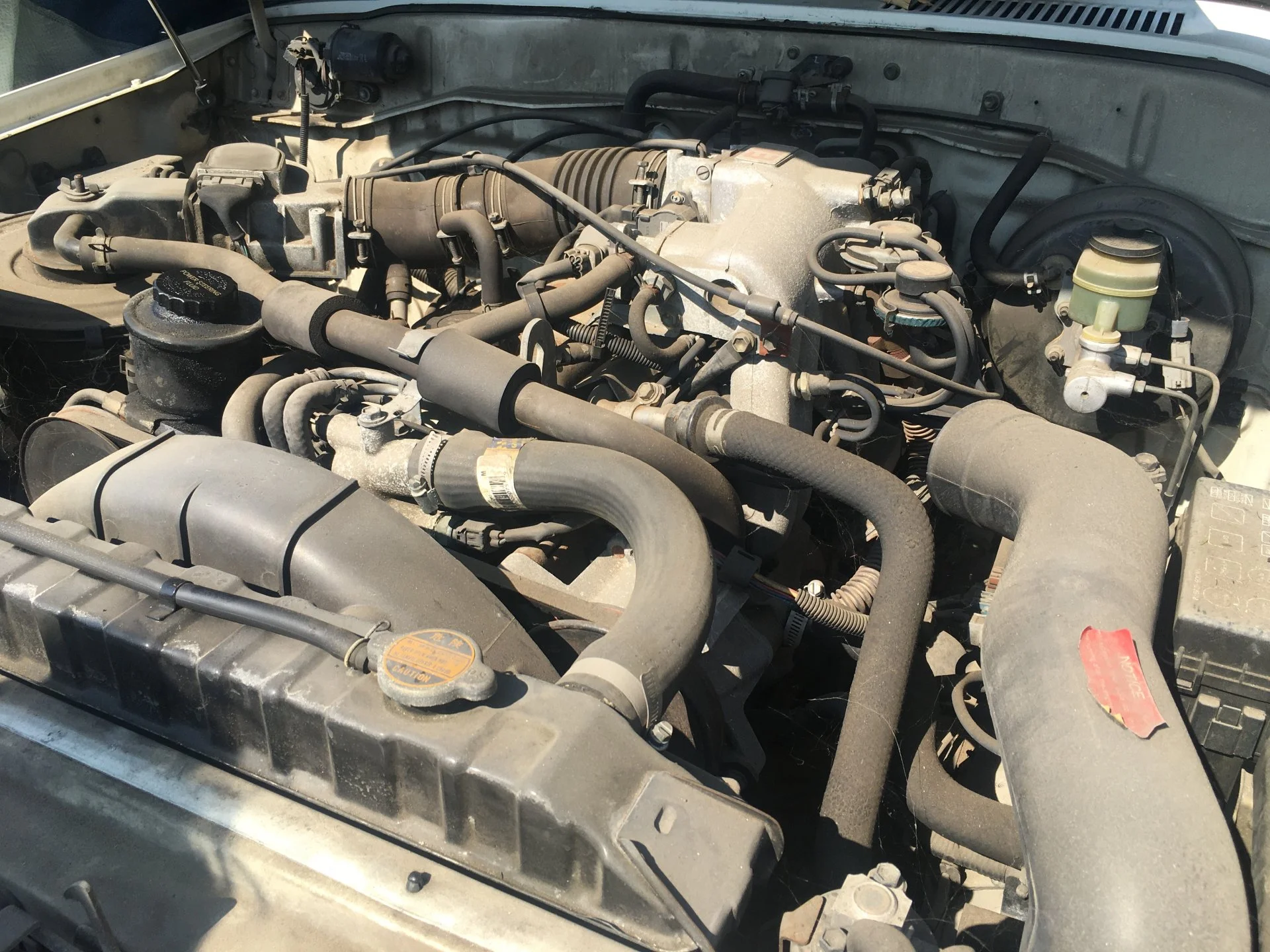

Dusty but very clean/intact engine bay. You still have the red cooling fan sticker on the fan duct, nice. Lots of info on mud about baselining your truck. 91 or 92?.

If that engine has not turned over in 6 years I would not try to start it now. Pull the plugs and squirt a small amount of thin synthetic oil in each cylinder and let it sit a week or so to soak/free the rings. Then, after a week or so, with the plugs out, take a breaker bar and turn the crankshaft by hand a few revolutions to make sure it will rotate freely and easily. After that, install plugs and REMOVE the coil wire and crank it a few times (after the oil change). If it sounds good, crank it so it rotates the crank a dozen times or so. You are trying to pre-lubricate everything you can before allowing it to run. I would do that two or three times with a minute or two between cranks then let it sit overnight. Do this one more time and only then would I re-install the coil wire and allow it to run for a minute or so and then shut it down; allow it to sit and let the oil do its stuff overnight. Then I would run it no more than 500 miles and change the oil and filter, just like breaking in a newly rebuilt engine.
I would also review information online about starting any motor that has not operated for a few years before starting and alter the above accordingly.
You don’t have a PHH or pesky heater hose. That being said I’ll replace as much old rubber under the hood as possible. Starting with anything that has coolant on the inside.
