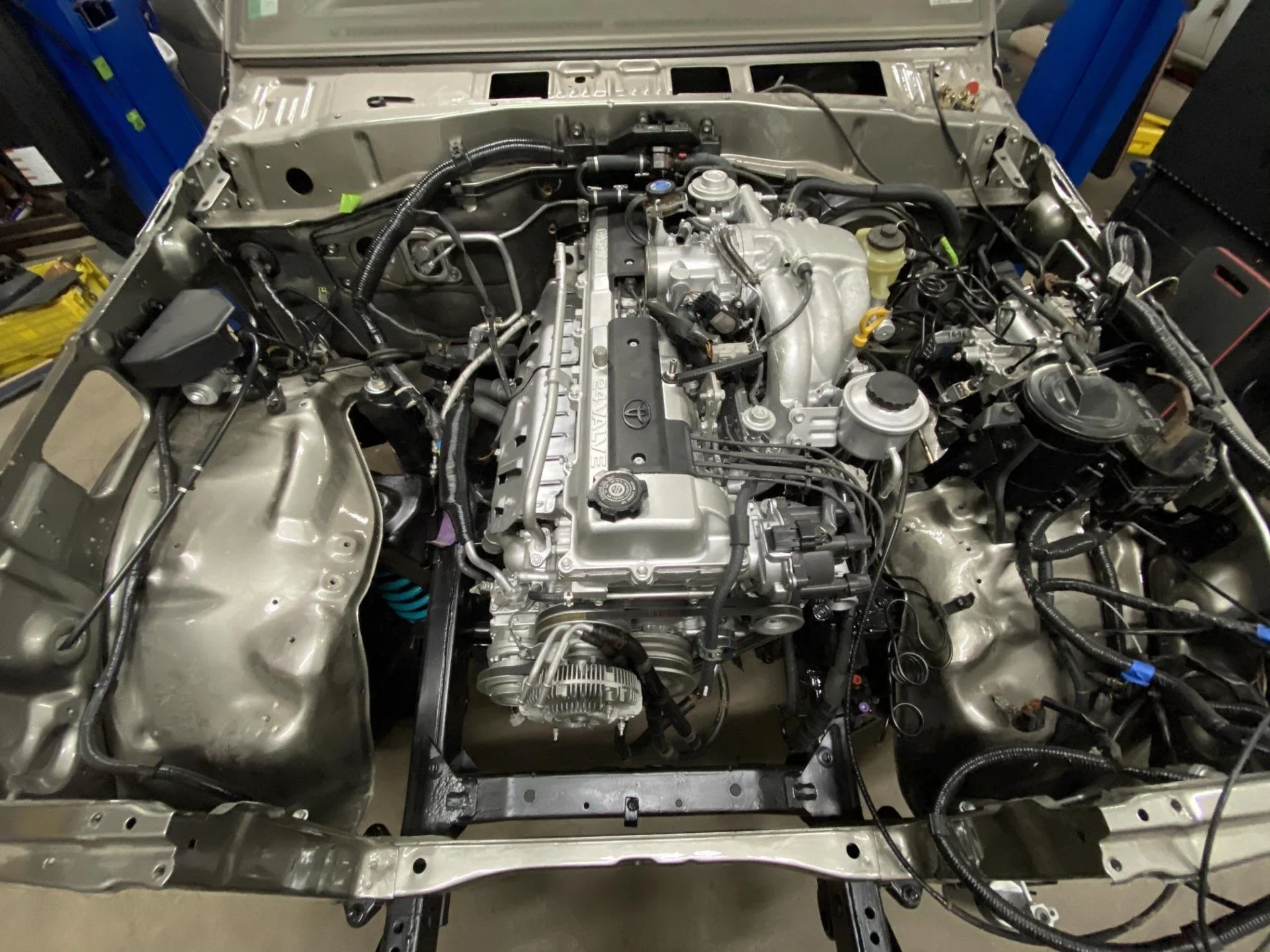

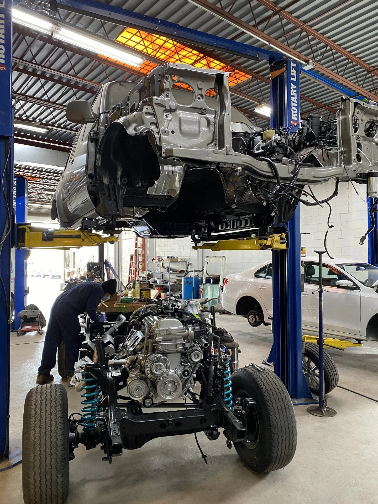

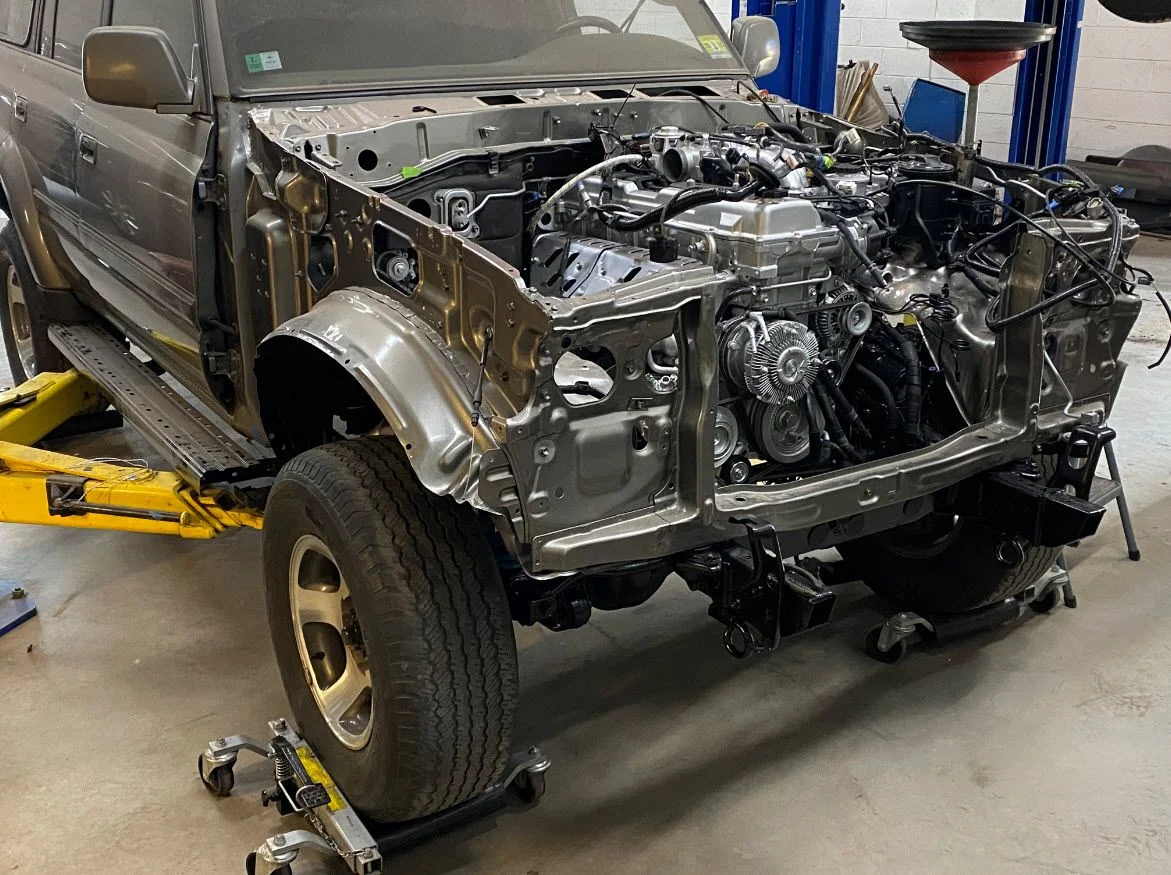

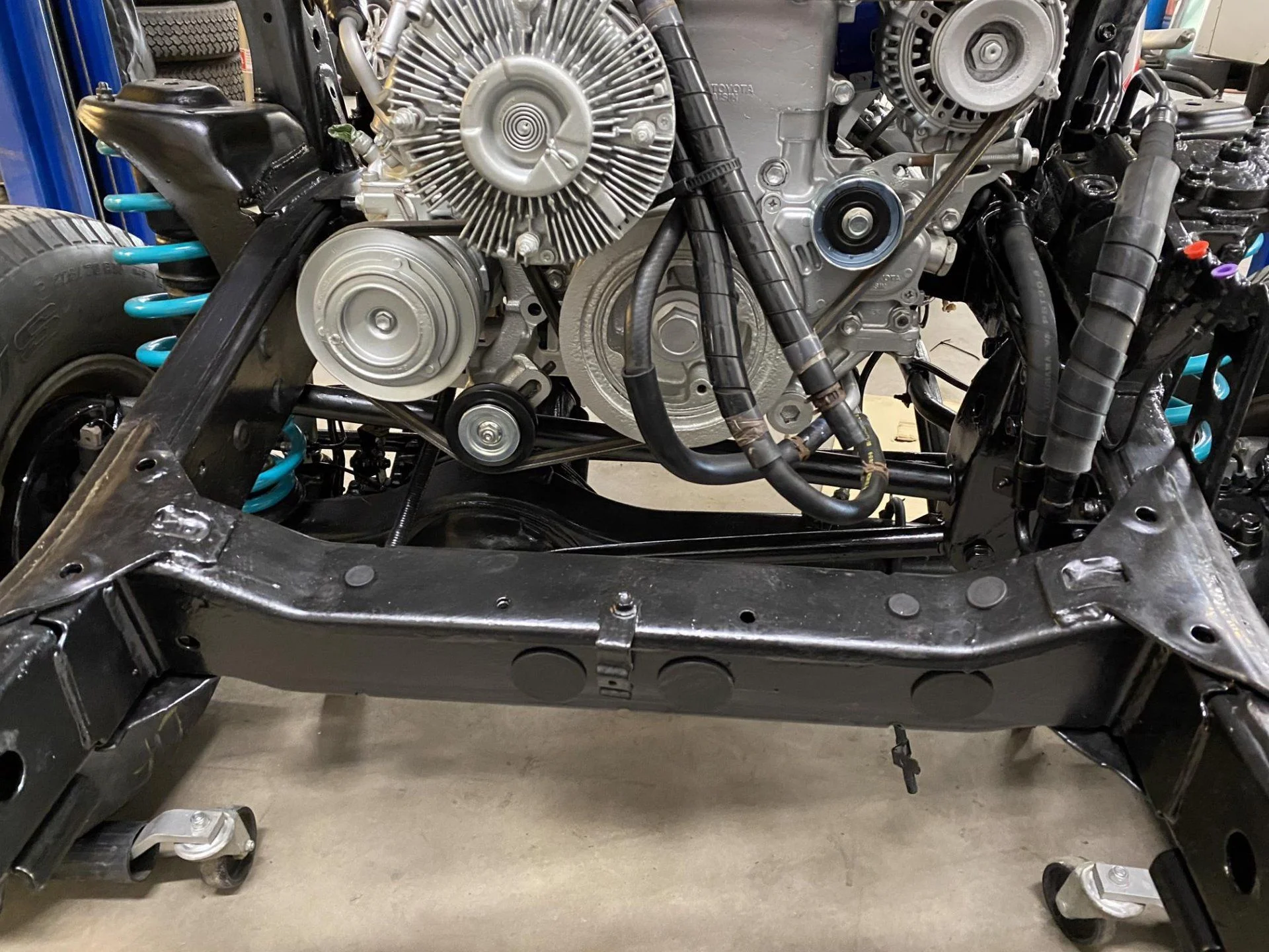

First FZJ80, 97 40th Anniversary

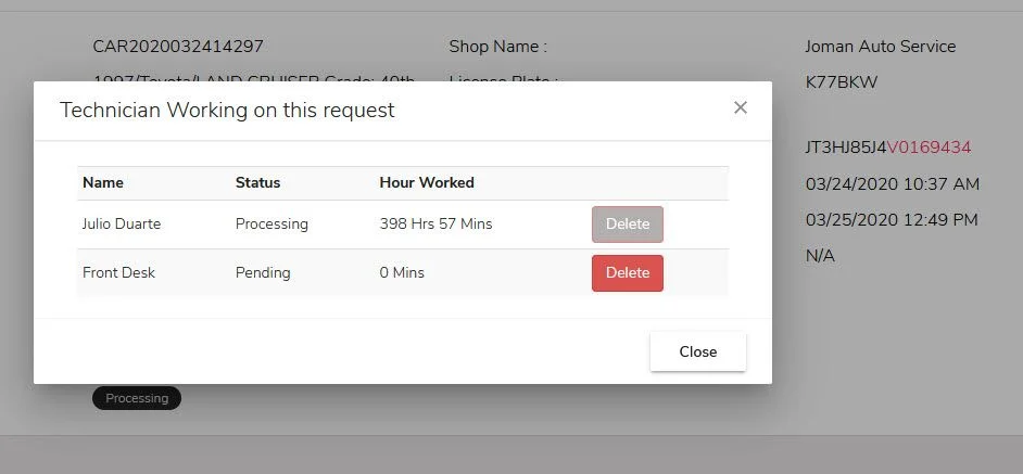

Labor equation for those curious.... I'm sure there are hard labor hours unaccounted for here, but this is a solid picture on the time involved.
Hours definitely not included in here: research, ordering, and negotiation.
Labor equation for those curious.... I'm sure there are hours unaccounted for here, but this is a solid picture on the time involved.

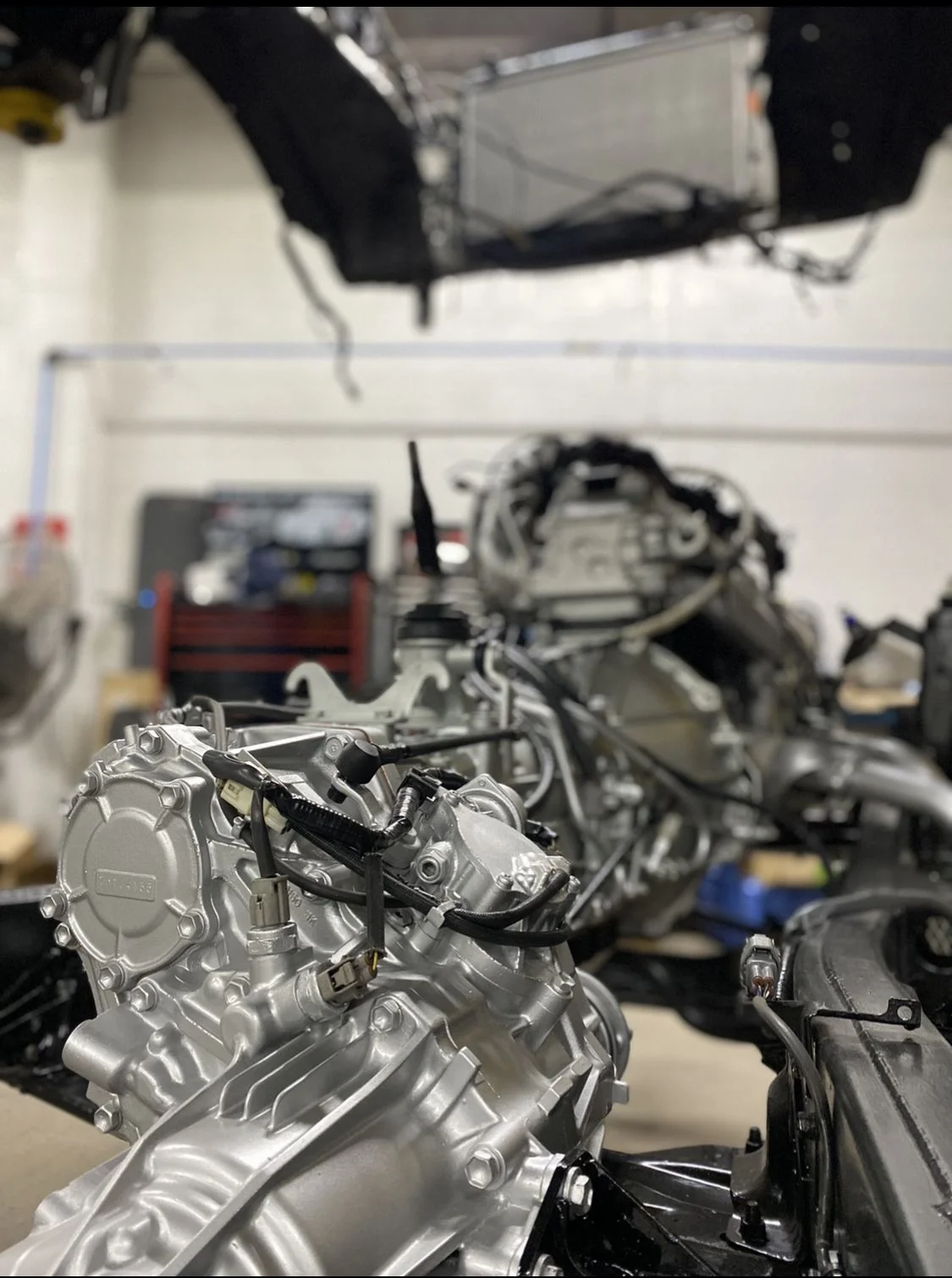

This is greatly appreciated. You're going to have an amazingly clean truck. Ready for another 20-30 years!
Sweet baby Jesus! 😍

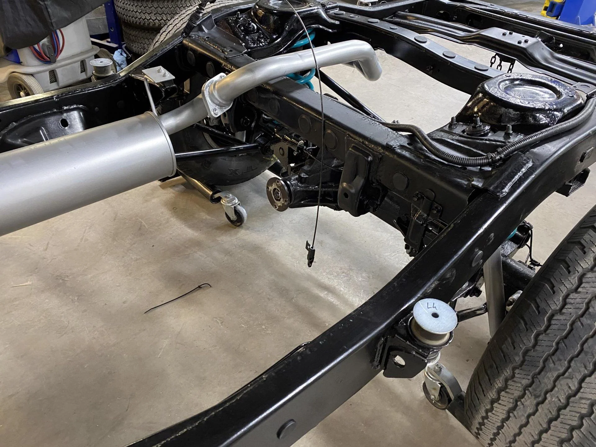

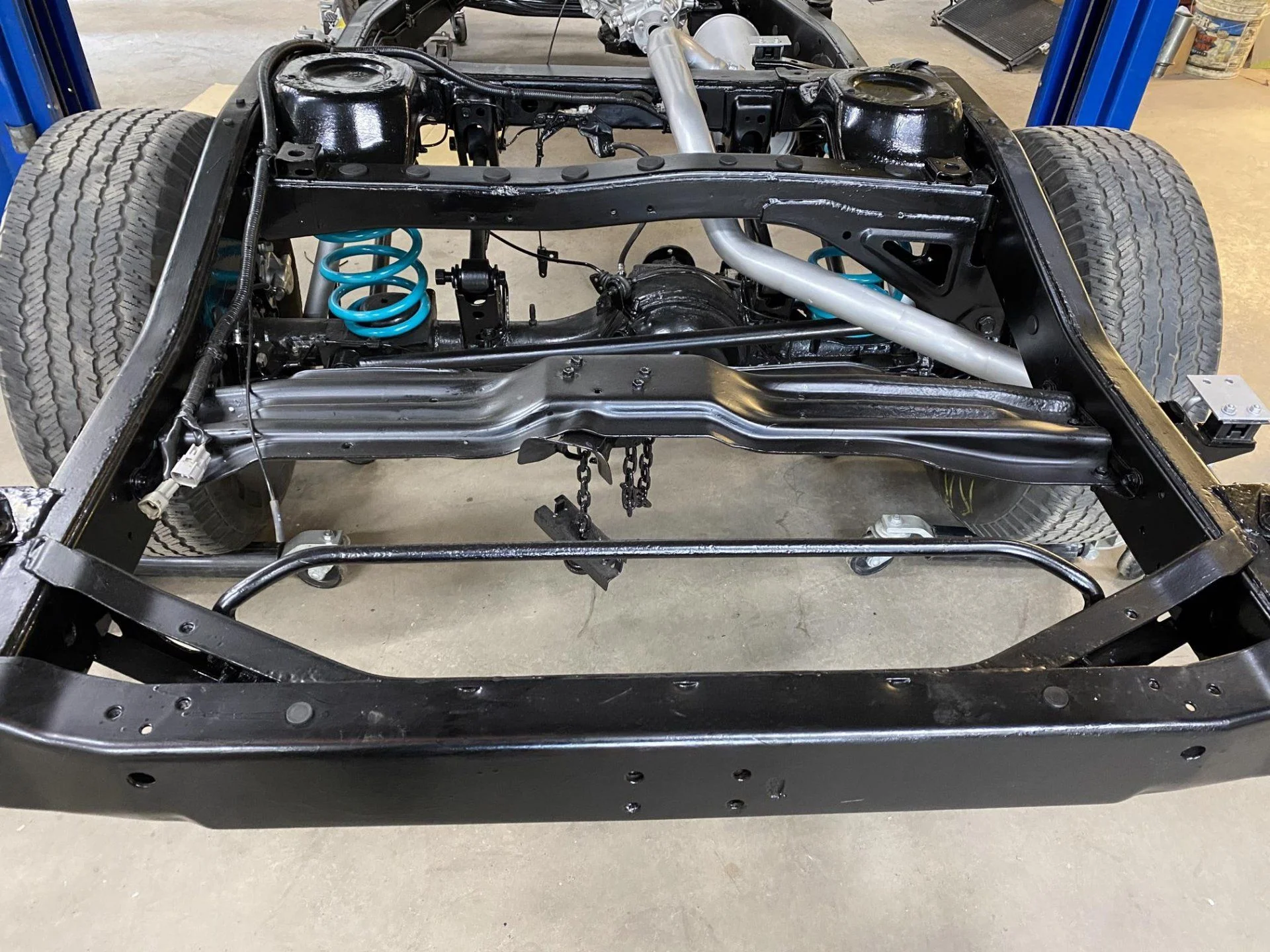

Will there be enough clearance on the exhaust pipe that hurdles the rear frame member? OEM is squished for a buffer zone....
I noticed that the other day. Time will tell if I'm removing the exhaust to flatten that section. Since the exhaust was completely rotted out, I had no choice other than full aftermarket.
