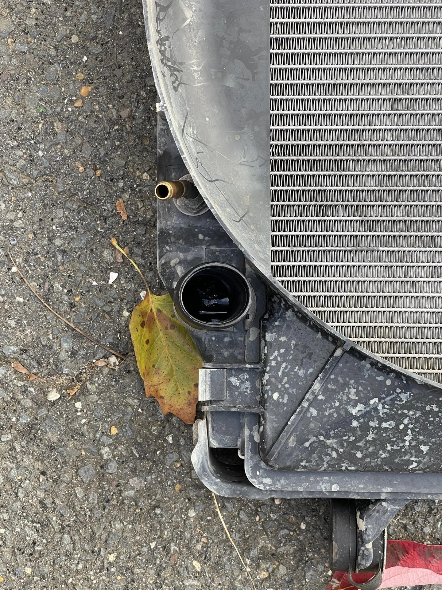

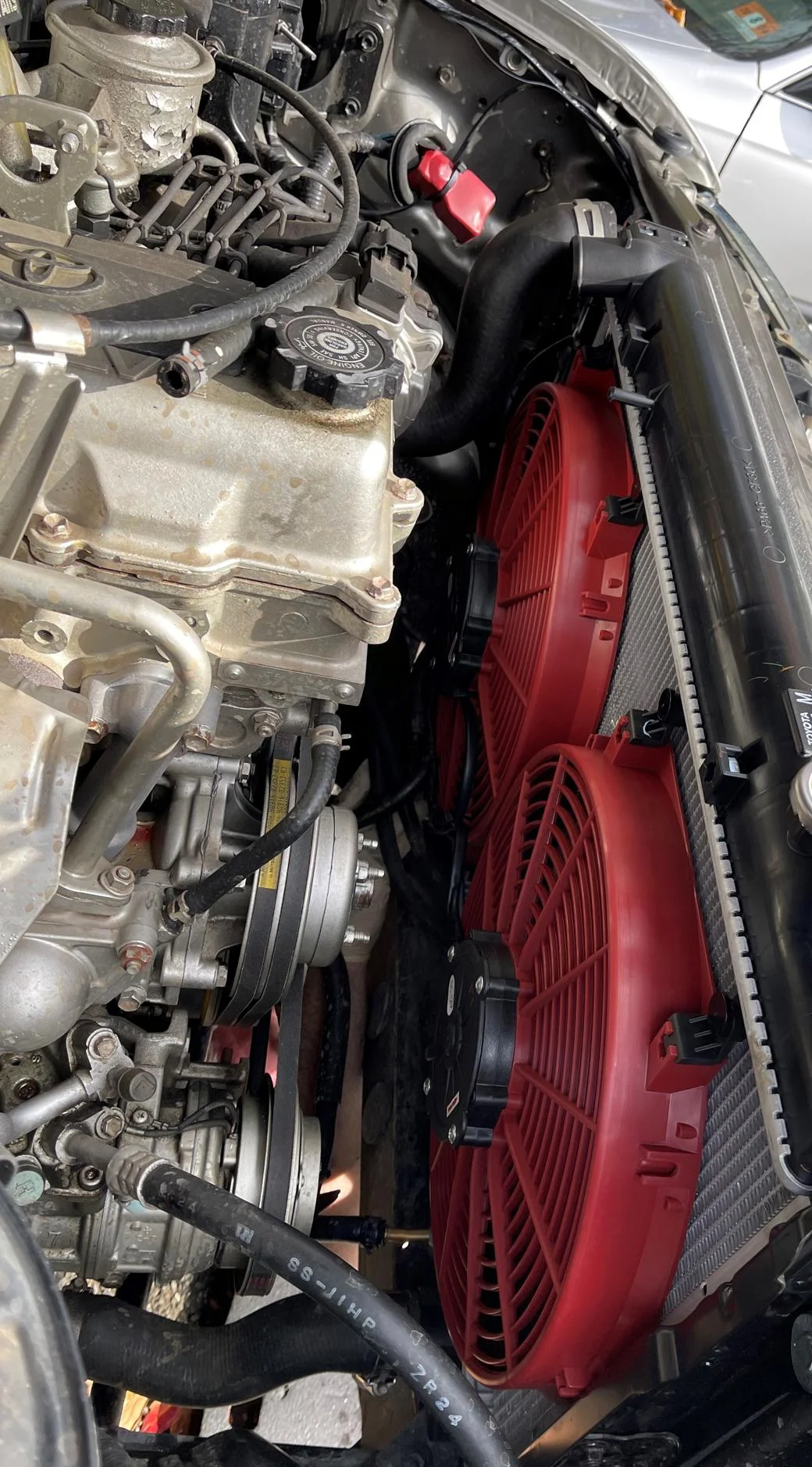

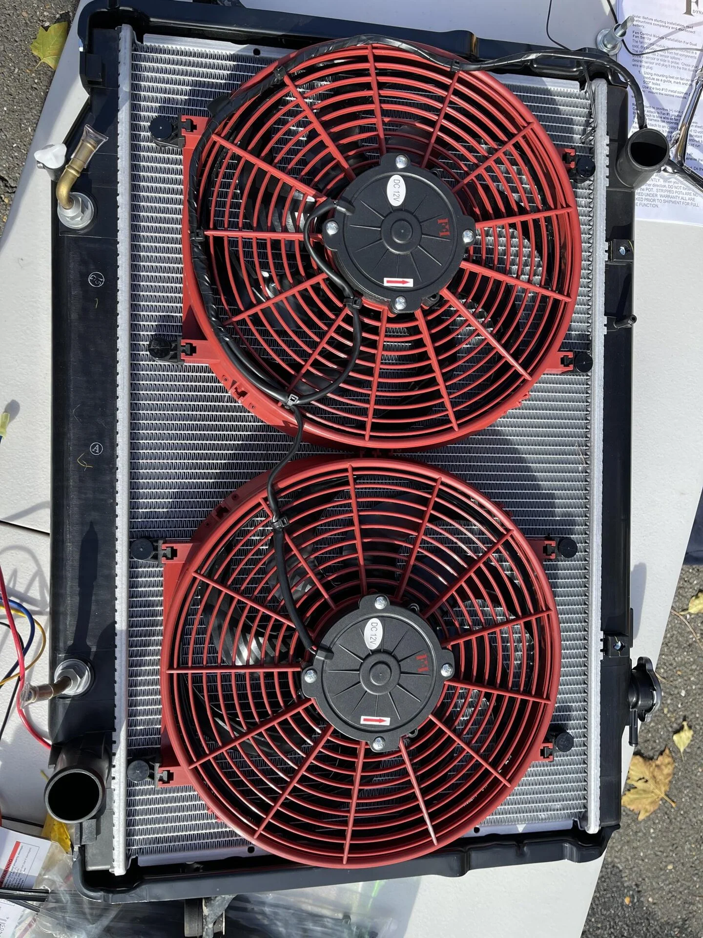

After getting the vehicle back to the house, I ordered a new Radiator and decided I wanted to change my cooling fan to an electric setup as opposed to the clutch style.
After receiving the parts and tearing the truck down... we determined that the cooling fan clutch failed and that lead to the rise in temperature... from the stress of beach driving. The radiator (CSF unit IIRC), did not like this temperature change and it inevitably gave way at the lower radiator hose and ovaled the lower hose mount.

This was unfortunate.

So upon installing the new OEM radiator and the cooling fan assembly, we knew I had to order an independent power distribution block to do the job correctly. Drove it 40 minutes from house to shop with no cooling fan operation and the temperature did not even budge. Ordered the Misc items needed and proceeded with dual electric fan install and setup. Monitored temps and dialed in the fans to start at around 178 degrees.
