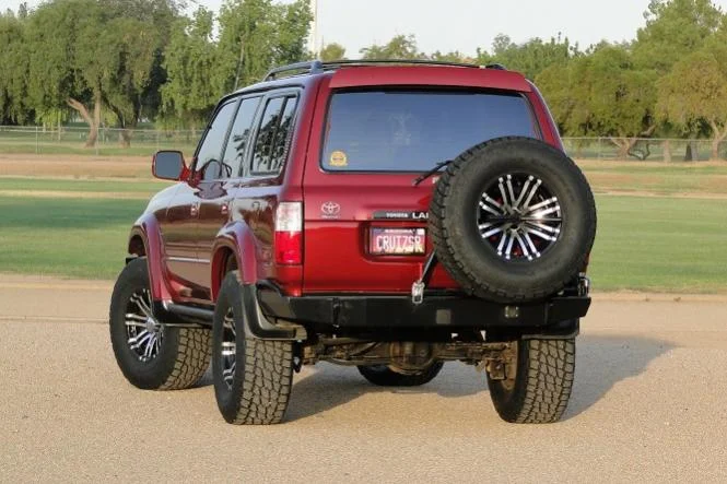

finished rear bumper/tire carrier

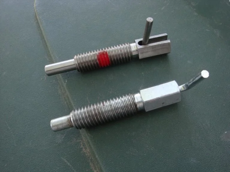

Follow up: I was able to locate through Rutland tool (like Slee hinted at) a Stainless Steel pin set up. This is a stronger pin that wont bend as easily. The handle/latch is also designed differently :)

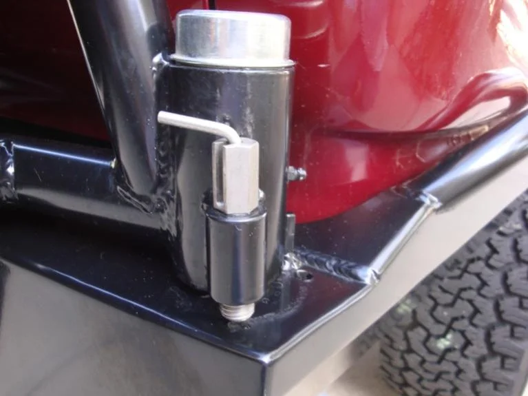

Ive noticed that the times that when the pin has bent, it has been when other people (car wash, wife, etc) open the carrier and dont understand the latch and muscle it around while it's latched :rolleyes:. The original design had the pin constantly under load to latch when it came to the matching hole. This new pin allows the handle to be positioned where you can hold the pin up (so it wont latch) buy swinging it to the side (see second pic) or set in the slot to automatically latch upon opening by constantly pushing the pin against the surface of the bumper. Good option in my opinion. Hope this info helps anyone else's build.
Pic is new style on left, the old on right. Also, the new pin in the carrier with the handle set not to automatically latch when meeting up with the hole.

nice job on the bumper (and on that amazing wax job too)
but watcha gonna do when you decide you want bigger tires?

Ive found that if you take care of the paint on a Toyota (and the PO did before you too), the pinstriping will almost always buff right out. I'm afraid Ill end up buffing the paint off one day :hillbilly:
Since I currently have minimal spacing to barely fit in my garage, I will end up staying with the 35's. 37's look better but Im happy with the 35's. BTW, the bumper builder said he can easily cut and reweld a different hoop if I ever change my mind for a larger tire.
Thanks :cheers:

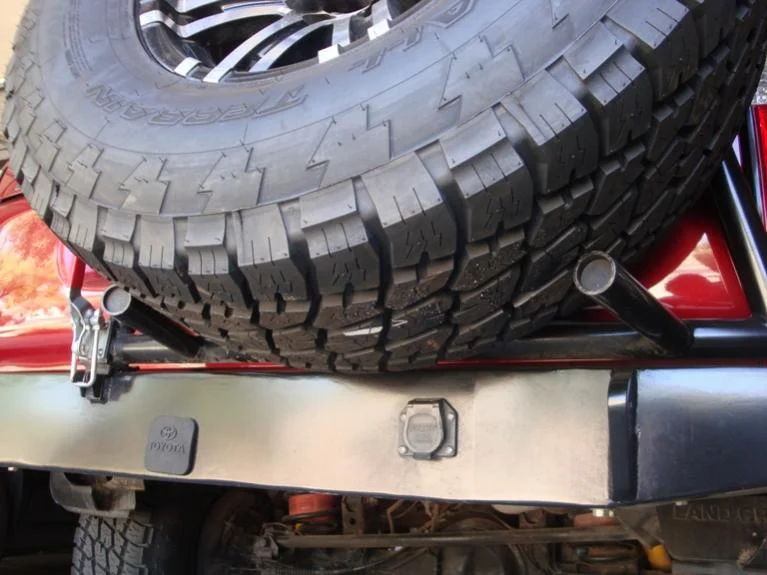

Well here we are two years later and Ive decided to move up a size from 315/70R17 to a 325/70R17 which is taller and quite a bit wider. I knew that the new tire would not fit in the cradle (and didnt) so out came the sawzall :hillbilly:!
Being that the rear cradle angled up, I measured where I could cut off the rear part of the hoop and leave part of the arms intact where they can still support the tire and allow it to sit down to where the wheel lined up properly to the center mount.
I touched up the metal area where cut and plugged off the ends of the tubes.
It fits well and without the bottom being pushed in has decided to have a more distinct rake to it (top leaning in) which Ive decided I like better.
Still one of the best bumpers Ive seen on mud.
Looks like a semi easy fix to get the tire to fit. Personally I like the tire leaning look better too.

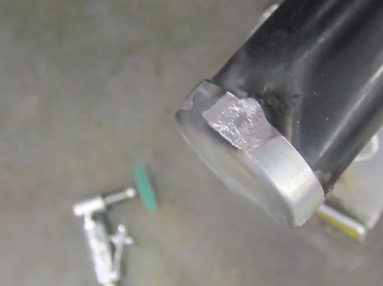

I ended up changing the look of the cut off tubes by spot weldin on some freeze plgs on the end of the posts, grinding smooth, and painting. It looks more finished and will keep water/mud/etc out from getting into the carrier assembly.
