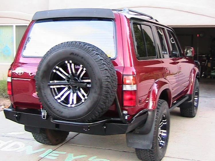

After researching the forum on rear bumper/carriers, a friend of mine introduced me to a custom fab guy ~ I finally took the plunge! My rear bumper was 90% finished in time for the recent Payette club run and I had some final tweaks wrapped up last week. The guy who fabbed it for me was very accomodating about building to the specs/options I was looking for. He used 1/4" steel - which after seeing the 3/16th's ARB front get dented - was desired. My requests: Mount the tire to the right (personal preference/smaller carier mechanism/less restricted view) and on the low side. It turned out a little too low and since he has repositioned higher up to where the bottom of the tire is just above the top of the bumper. He designed the carrier to have a cradle and a large center coarse threaded mount which a poly cone and spinner handle was used. The unit is secured down by a hole drilled through the assembly in the rear and locked. WAY easier to remove/install the big spare with this design! Under the rear corners I had him add extra plating underneath (since thats where I seem to hit). The exhaust was then cut and rerouted over the frame rail (keeping the resonator) and exited out the bumper itself. A different mount was built to correct the ocassional pipe rattle. This keeps my exhaust out of harms way now. I included an integrated receiver and had the electrical trailer connection built into the bumper as well for clearance and protection. Also added rocker protection hoops. He added the swing carrier locking pin and stop after the Payette run also. (dont realize how much you need those till you are parked on an incline!). The recovery points are actually plating that mounts to the frame then sandwiched by two metal layers to give it thickness. This way you are pulling direct to the frame vs a weld. In all, the bumper I always wanted at a much more affordable price. He has also done alot of custom work for several other guys I know and he does it very well. Just wanted to share :)

Nice. Really Nice!

Very nice bumper Eric. Nice to see something different and well thought out.

Very nice. Did this design require cutting out your rear cross-member?

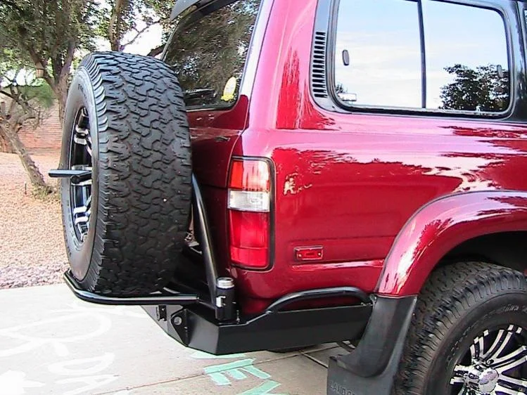

X2. I'm looking to do a bumper that keeps the cross member. I really like the exhaust outlet. Can you post more detailed pics of the receiver hitch?
No, it does not.

Dave, heres a similar link posted in the 80's forum that includes several hitch pictures and went alot farther exploring different lock pins, etc. It starts the same but keep going! >> https://forum.ih8mud.com/80-series-...e-carrier.html?highlight=finished+rear+bumper

The way you rerouted the exhaust through the bumper leaves the muffler pointed down. Will/has this effected water crossings?
Cook
Pete, the tailpipe is angled down right at the exit point not unlike the stock tailpipe. Matter of fact it is almost the same shape other than it is mounted up higher. Ive experienced no issues even though Ive had it under water before. Ive left the engine running each time though.
