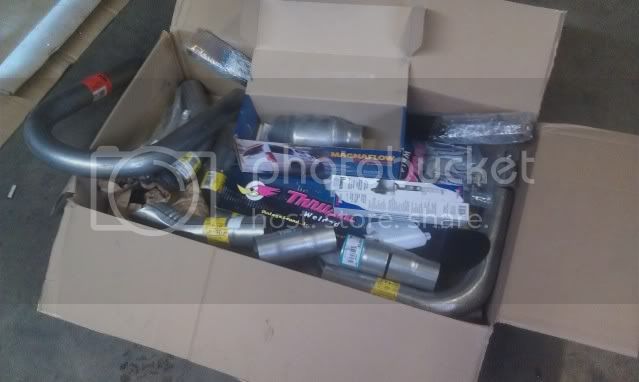

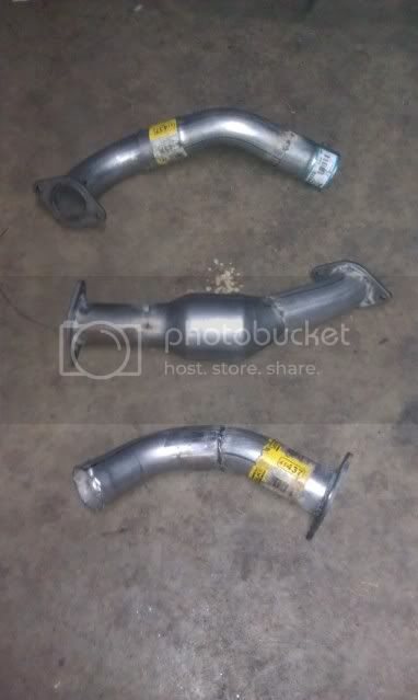

I have been living with code PO420 for awhile now due to some bad aftermarket cats, and leaking piping. After reading tons of threads on exhaust options I decided on buying parts and re using from prior projects to build my own the best I can.
- Magnaflow spun cat
- thrush muffler
- assortment of mandrel bends
- Slee O2 sensor bungs
- Exh. couplers
- few clamps
- few ft. of exh. pipe (2 1/2")
- 2 sets exh. flanges
- Couple 6" grinder cut off discs

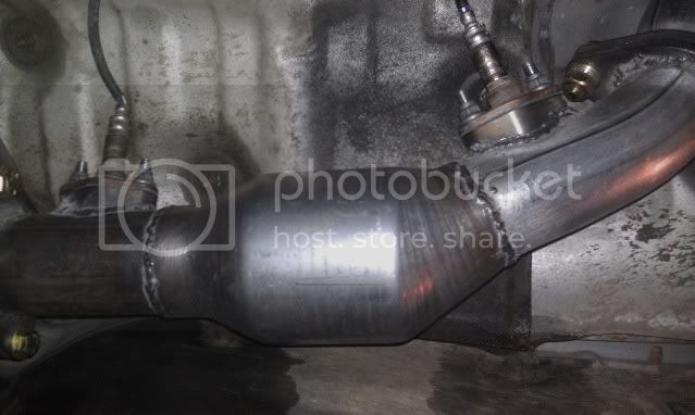

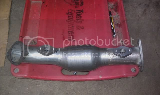

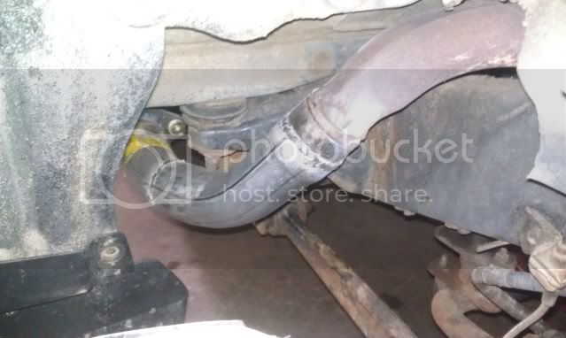

Overall around $400. I cut the exhaust off right after first weld joint in downpipe where two pipes connect. Took everything out but left the tailpipe (for now). Spent some time cutting mandrel bends, mocking up, and tack welding all the sections working my way back. I piped the cat with flanges at both end for easy dismantling. And yes I did go over the frame. Not the easiest without an actual mandrel bending machine. Oh well. So tomorrow I will be welding all the sections I made. Installing Slee O2 bungs. Weld downpipe section on. Weld in some hangers. AND fix those nasty rusted rear heater lines. Check out the pics below. I do have a couple questions for the exhaust pros:
1. Is it ok to locate the O2 sensors directly before and after the cat? See last pic for my location. I can also move the rear O2 back about a foot into next section if that is better for some reason
2. Should I have incorporated a flex pipe in the front maybe on downpipe? I see some people use them and some don't
Looks great! I love the mandrel bends and that spun cat. I didn't know spun cats where available with an angled exit like that.
I think the 02 bungs will be fine where you have them.

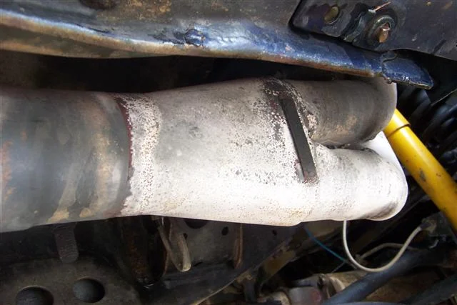

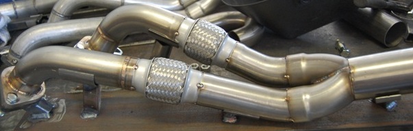

The bad thing about the stock Y is that it pinches the flow. It forces the exhaust pulses to have to squeeze against each other into the down pipe.
The EMS exhaust opened the Y and used a larger diameter down pipe which relieved the restriction:
This is how I ran mine together after the headers 2.25x2 into 3":
attachment.php
I had EMS add their curly pipe over the frame after this collector.

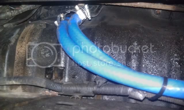

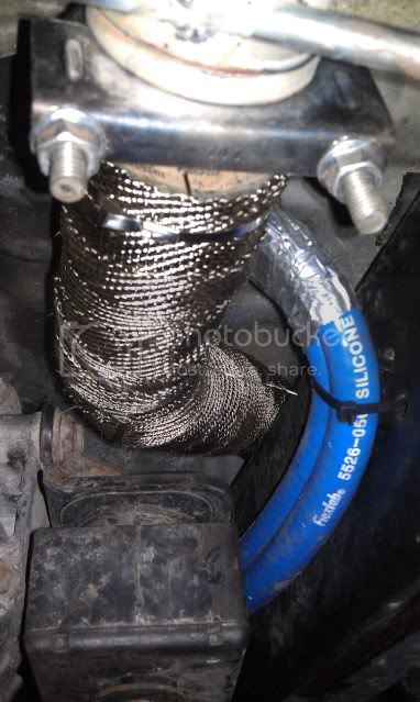

Those are going today for sure. Just going to run heater hose instead and leave the old lines there. They didn't leak to I start aggravating the area. Better now than later.
Custom Exhaust with Pics
Well I finished it the exhaust up today. That was a lot of work for sure. Glad its over. I also repaced my rear heater hoses with silicone hose. Overall I am happy with the turn out. It sounds great!! Not too loud, not to quiet. I will still be adding one more hanger, and header wrap in a few areas (by heater hoses, and over the frame area). Check out pics
Nice work on the collector on your exhaust. The EMS one is very nice.
Drove the truck around a bit today and it runs sooooo much better. smoother idle, more power overall, smoother through rpms. Glad I have this one under the belt. Next oil pan gaskets or/and rear mail seal leak fix
pretty nice .. did you ever consider using slip on sections instead of regular mandrel and weld .?
I didnt want to have more possible leak points on the exhaust. Plus I dont think there is enough room to use slip joints. It was hard enough to get the over the frame part perfect so there was no rubbing or banging around welding it together. Also to make it easy to take apart with simple flanges.
