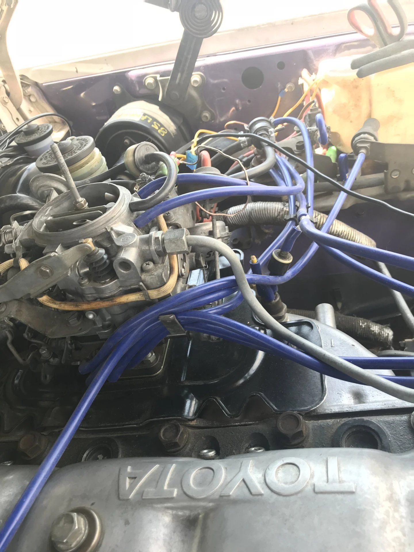

Pictures of vacuum hose routing before putting air cleaner on (the lighting kinda sucks):
Passenger side vacuum routing:
Jim’s brass plug replacing egr:
And silicone hose with homemade plug to go over exhaust check valve. May not technically be needed, but this way it stays clean and ready when I have to smog it again:
Fired right up and sounds amazing! No clacks, squeals, whistling, or whining anymore! No exhaust overwhelm when I have my head in the engine bay. Also, no increase in vacuum, something I was hoping for. Still so excited!
I forgot my burping funnel so I did it the old fashioned way and will do it properly with the lisle funnel tomorrow, and then will drive it to test if there is improvement in driving.
All together again with lots more room:
