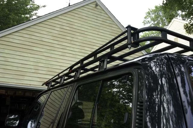

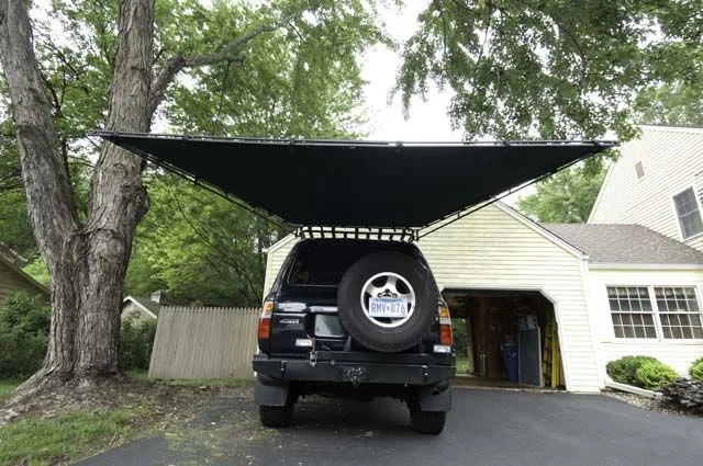

Well it's only been two years since I started this project on a whim and short of time. I wanted a free standing awning that was very easy to put up and take down and that had no poles to get in the way. I also wanted it to be high enough to be able to walk under with out hitting my head on the supports. Water tight and green like my truck and trailer.

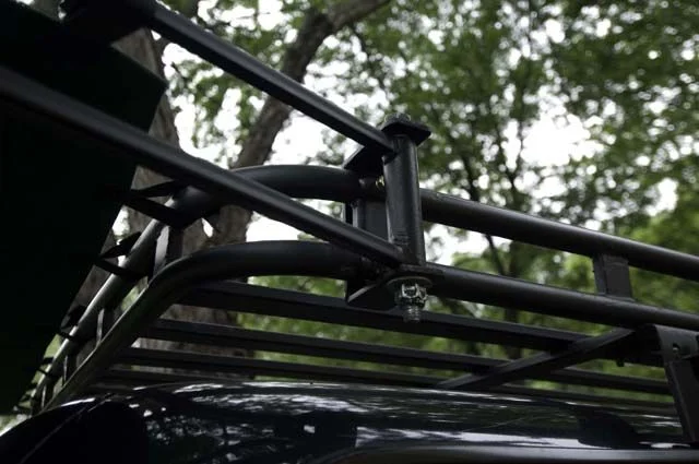

I built the supports out of 1/2 square tube with a taper to aid in water runoff should it be needed. They fold back from the roof rack for assembly and stow with some hook and loop.
It measures four feet at the truck, ten feet at the outer edge and sticks out a little over six feet from the back of the truck. The material is heavy awning material and it attaches with hook and loop all the way around so it can really be snugged up to shed water and not flop around in the wind. It really wasn't meant for really heavy duty applications, just to add some protection from mild rain or harsh sun on hot days. It works great with the upper hatch up and the tailgate down for a quick lunch or to cook off the tailgate for a simple dinner and happy hour.

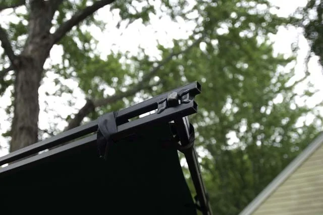

Your gonna plug up those ends right? Don't want water getting in there.

No, not going to plug those ends. They are a part of the outer edge that breaks down into three pieces. The center two foot section is an oversized section that slides over the outer sections and holds the two end pieces together. There are eight 1/4 20 thumb bolts that secure the unit together. I'm not concerned about moisture getting in there enough to make me want to seal the ends. Good thought though.

Well, it worked perfect and deployed in minutes. It stood defiant in a 15 mph cross wind and supplied shade and protection from the very little rain there was. I couldn't be happier with it, it worked perfectly for what it was designed for. Thanks for the comments!
Materials from a steel yard for the frame and an awning shop for the fabric. The fabric is typical medium heavy awning material.
