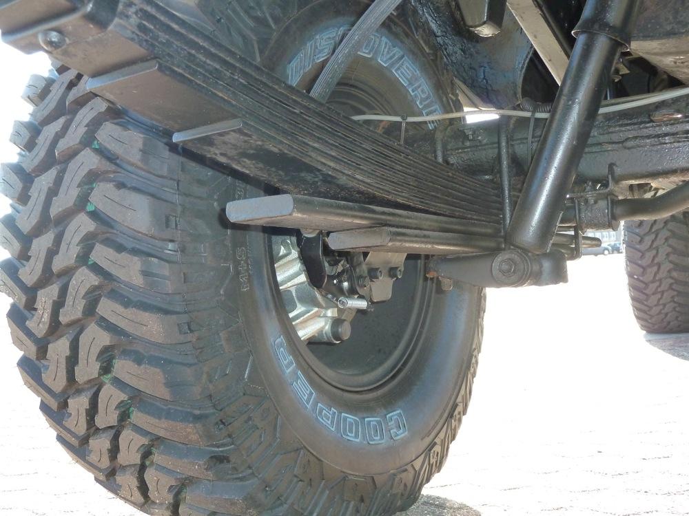

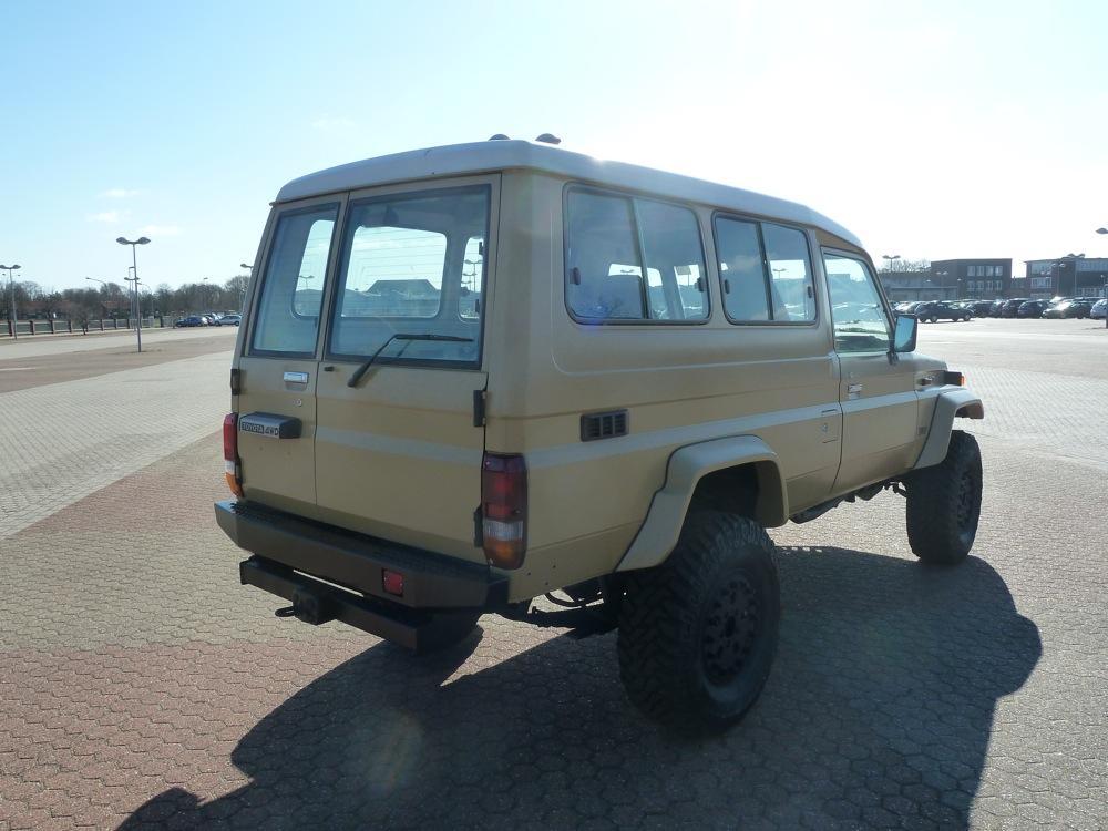

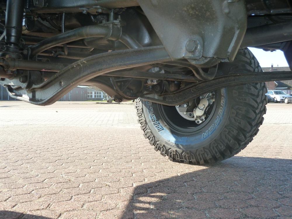

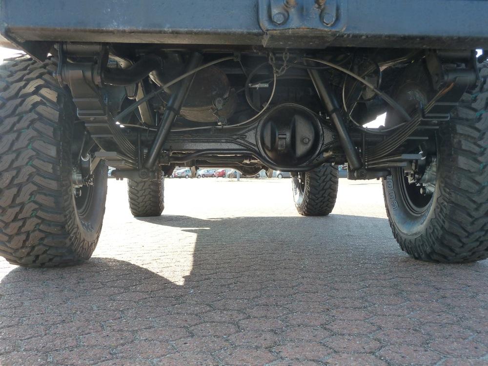

Finally, my HZJ 78 on Bolt on Portals!

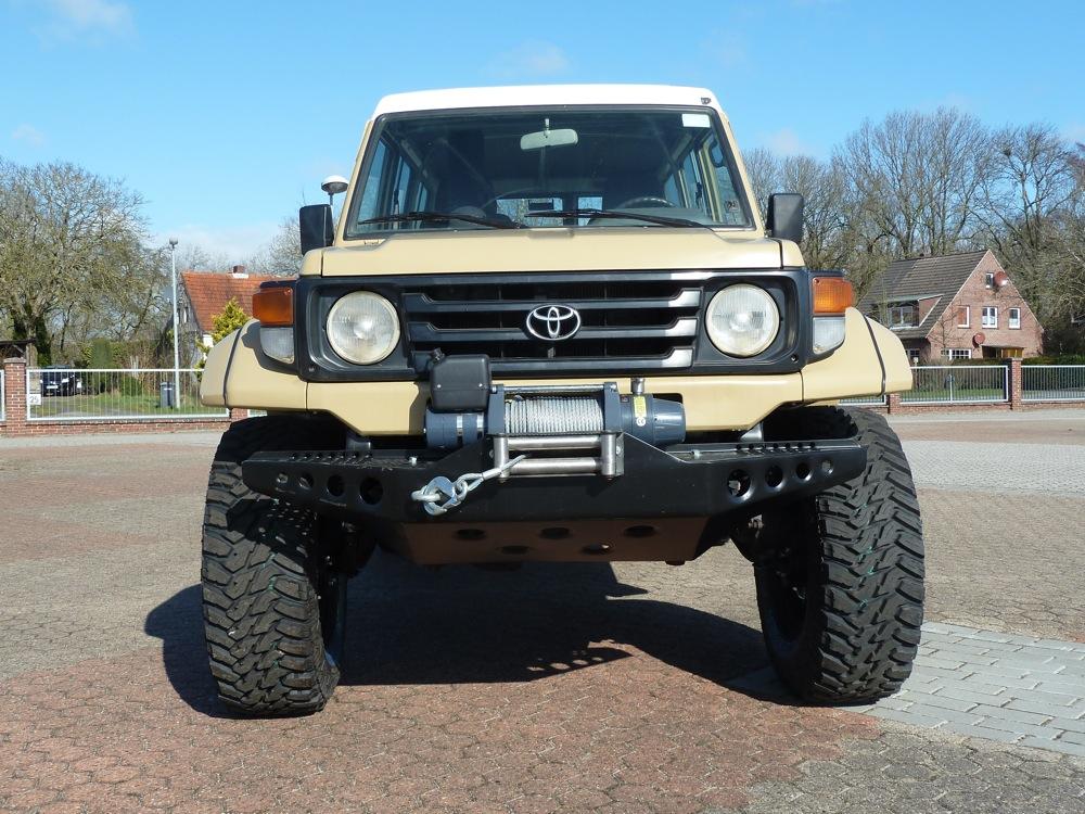

Not fitting the double motor 8274 winch?
Be careful of running 70m+ on the portals. YOu can see the damage if you find flakes in the portals will indicate the problem.

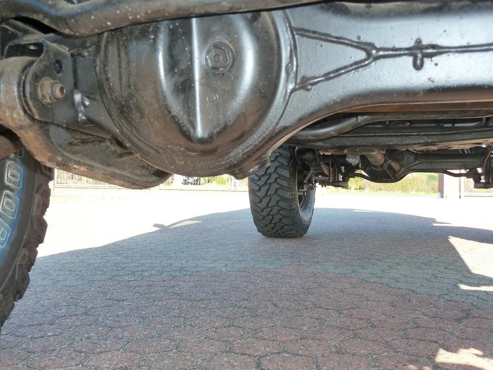

If I was you I would also take spare axle seals to stop the diff oil coming through to the portals if they leak on a trip.

What did TIBUS charge you for the portals as a matter of Interest please as this is the BEST option for a 75/78. Portals from TIBUS or REAL Volvo Portals if you need massive ground clearance in swampy or deeply rutted tracks which is the BANE of 75/78's.

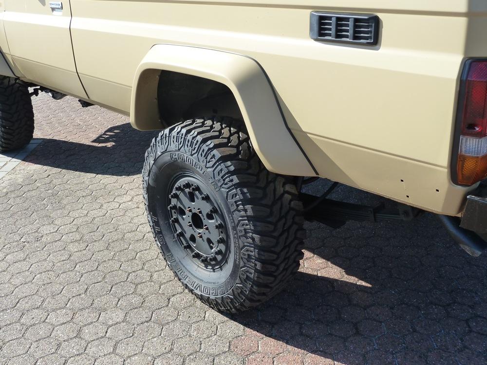

Very nice troopy and mods you have there.
Were did you get those wide wheel arch flares or what company makes them.
Will get the new double motor winch from tibus later this year:
TW 16400 Winch
I saw the prototype, looks very promising and fits perfect on my front bumper.
Not a problem with tibus portals. I took a look at the Defender from Robert Kranz who drove over 100.000 miles with the same bolt on portals without any problems. Also I took a ride with Tibus own Defender with V8 8.1L and we both drove 210 km/h on german Autobahn :-()
They were very hard to find. Ask Dave Stedman from japan4x4, he will get you these.
For the price for the Bolt on Portals please ask Tibus Offroad as I don't know the final price.

Are you still running the std suspention height in the troopy.
What happened to the back sliding window
