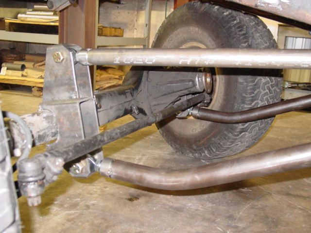

Finally I began my coil spring conversion!!
My rear track bar I use .75" ( 3/4 ) heim .. but it's only a track bar .. so I recognice no problem yet at all with this setup ..
Just IMOP in your setup gonna do more effort .. so I thought in 1"
I'm doing it very slowly but I'm still working on my project! :bounce:
Here some pics of the last news: I built up the support for upper link, tomorrow I will sauld it to the axle.
So, what do you think about it??? :rolleyes:
Francesco
The work's going on!
Today I brought the axle back to my garage and I put it under the car; tomorrow I'm going to take the measurements to put it in the right position.
Here some pics:
Francesco

I've got some beig news about the job.
I went on with the works on the rear axle: I made the attachemnts for the upper bars, here there are a couple of pics, wht do you think about them?

In the front you realyl want to support the frame side shock mounts to each other. Makes for a much stronger setup..
build a bridge between the shock mounts over the motor..

Another alternative is to look for a different power steering box. You might have better luck with FJ60 box. Or Hilux / minitruck. I think both of those are face of frame mounted and the stem is locaded behind the shock tower above the frame.
2 steps forward and one back, but I think you will like the end result better.

The front definatly looks tricky with the steering shaft in the way. I must agree with the others, it may save time to relocate it now instead of building around it. By the time you build around it you may find it still interferes...
