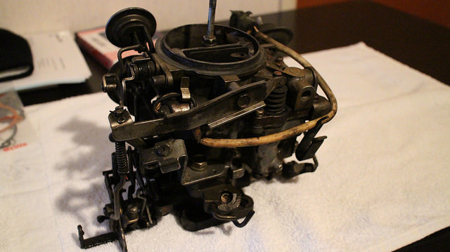

Carb before rebuild and cleaning... she was a dirty bitch...
IMG_2936 by Greg Fisicaro, on Flickr

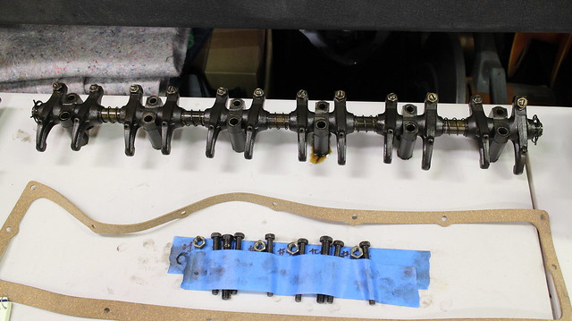

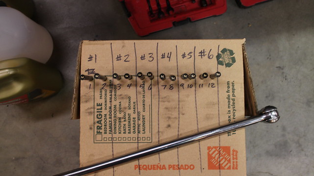

Rods all labeled....
IMG_2917 by Greg Fisicaro, on Flickr

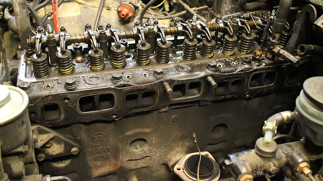

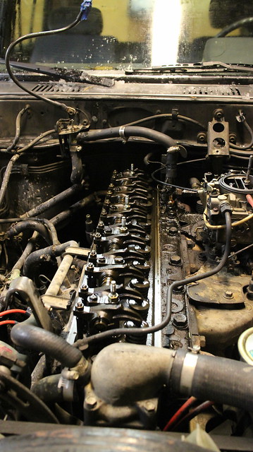

Rocker off...
IMG_2918 by Greg Fisicaro, on Flickr

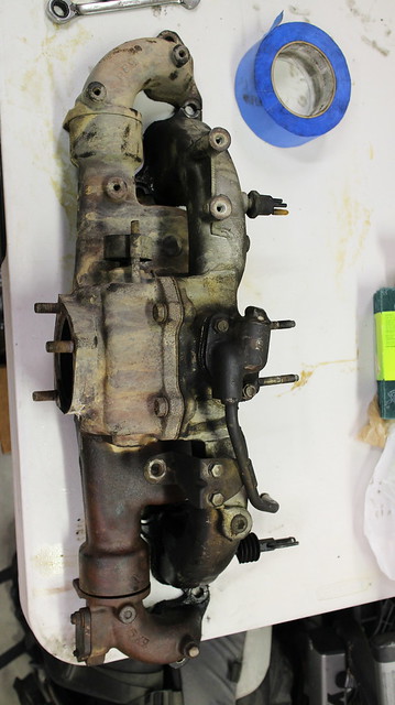

Manifold off... (you will see the J-pipe blockoff at the bottom of the pic. You can see the one bolt that was busted off, luckily that came out with a pair of vise grips and was chased and had a new grade 10.9 bolt put in its place. Since the other was just fine I didn't want to press my luck.)
IMG_2920 by Greg Fisicaro, on Flickr

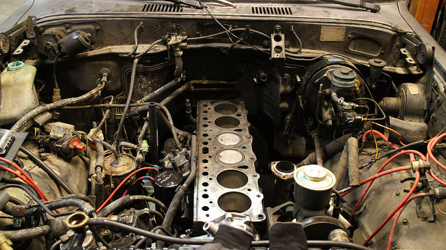

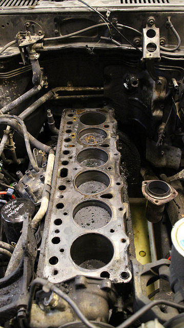

Head off
IMG_2921 by Greg Fisicaro, on Flickr

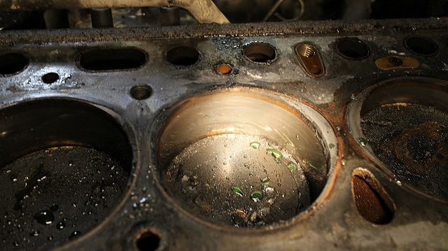

Cylinder 1
IMG_2923 by Greg Fisicaro, on Flickr

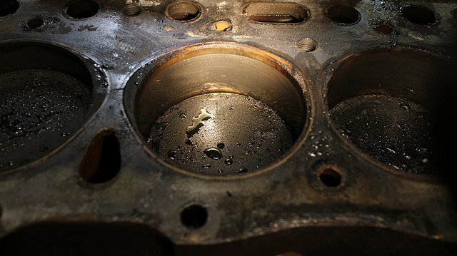

Cylinder 5
IMG_2927 by Greg Fisicaro, on Flickr
Cylinder 6
IMG_2928 by Greg Fisicaro, on Flickr

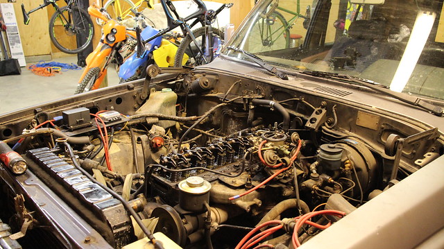

As you can see they were all pretty hot and full of carbon. My buddy and I went after the hea

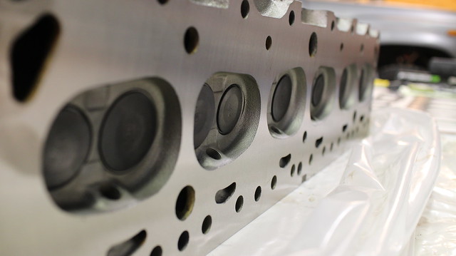

Here is the head after we cleaned it up....
IMG_2945 by Greg Fisicaro, on Flickr

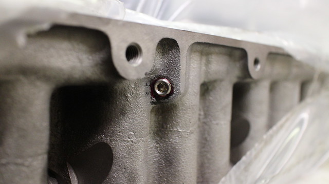

Forgot to have the machine shop do the soft plug (galley plug) so I did it myself.. finally got to put my tap set to good use
Replaced it with a 5/16x18 by 20mm plug with red Loctite.
IMG_2948 by Greg Fisicaro, on Flickr
IMG_2949 by Greg Fisicaro, on Flickr

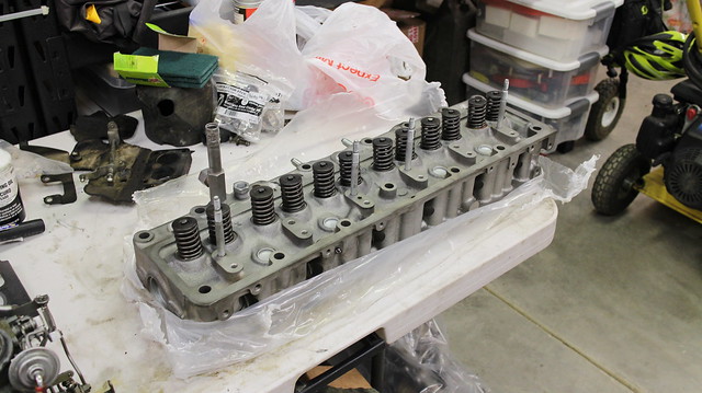

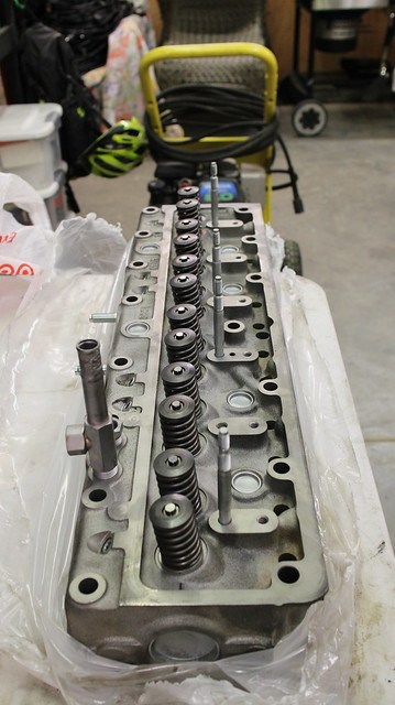

Head all cleaned up, all new seats(?) from the engine rebuild kit and all valves were ground to ensure good seal.
IMG_2950 by Greg Fisicaro, on Flickr
IMG_2951 by Greg Fisicaro, on Flickr

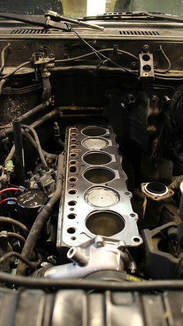

And finally the block with the gasket on!!!! Can't tell you how many times I checked to see that it was on properly before I had my buddy come in and help put it together.
IMG_2956 by Greg Fisicaro, on Flickr

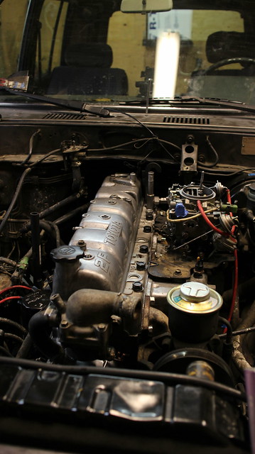

She is looking like an engine again!!
IMG_2959 by Greg Fisicaro, on Flickr
