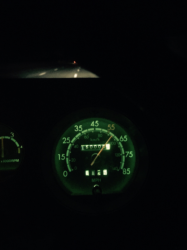

Well hit a milestone at 4:45am on my way to the airport this morning!!!
She's still a baby at 150k

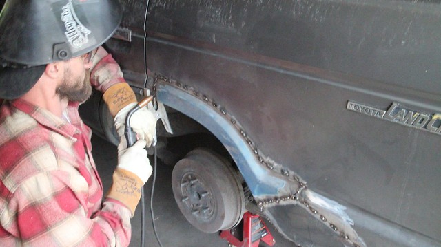

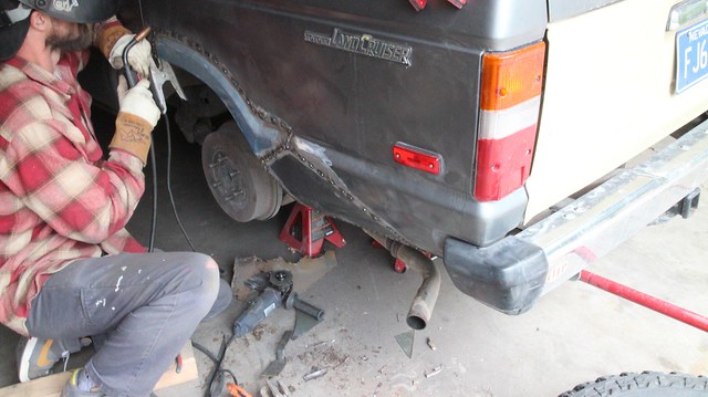

So Sunday was the day, he showed up with a few tools, I brought out beer and well the pics are what happened..

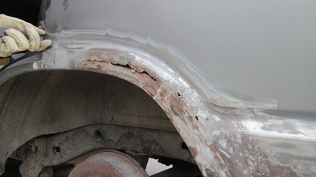

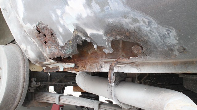

All in all the rust was pretty bad, much worse than I expected but my buddies only complaint about it was the apparent 5 gallon bucket of mud they used on the ONE SIDE along with the tacked metal to rusty metal... oh and then there was the silicone that was used as a HUGE glob of seam sealer.... Thank god I kept my old tailgate and we were able to use that steel to patch in otherwise we would have not had enough metal.

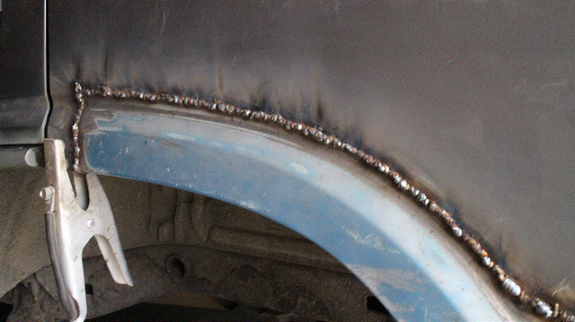

Well the new PHOTO for Macs sucks. Tried for hours to get it to sync with my camera last night and couldn't get it to do it for some reason. Which is really odd because I did it a week or so ago when it first came out and downloaded our pics from Sedona. I will figure something out but last night was spent knocking down the welds, finding all the little pin holes and then blowing through those with the welder in an attempt to "fix" them. LOL... ended up fixing most everything so looks like another night with the grinder knocking down a few more welds.

And it has taken me almost 3yrs of looking at it to get to this point. Body work came out pretty good considering that I only had a small section for what needed to be replaced and the rest was done with a patch panel from my old tailgate. Thankfully my buddy is good with body work so he knew what he was doing and was able to do some shaping. Luckily these seem to be the only bad parts for rust!

Yeah yeah!! I know... Just had to have someone here to give me that push and make the first cut, then it was fine. I am really glad that I had him though as I would not have known what to do about all the lower rust. As you can see I had the wheel well piece but it did not go down all the way so we had to come up with something.
And since he brought his body hammers and dollies he was able to fashion a replacement out of the flat sheet from the tailgate.

That was because we had disconnected the hangers to get at the sections a little easier. Of course, as I am bending it out of the way so my buddy can do the cutting and what not we both hear a loud POP. He stops, gets under the truck, pokes around a bit and then says, You know your exhaust was pretty much rusted through right? I say, yeah I figured. He then tells me, well the connection to the muffler, yeah there aint much left now, sorry but I busted the rusted portion.
