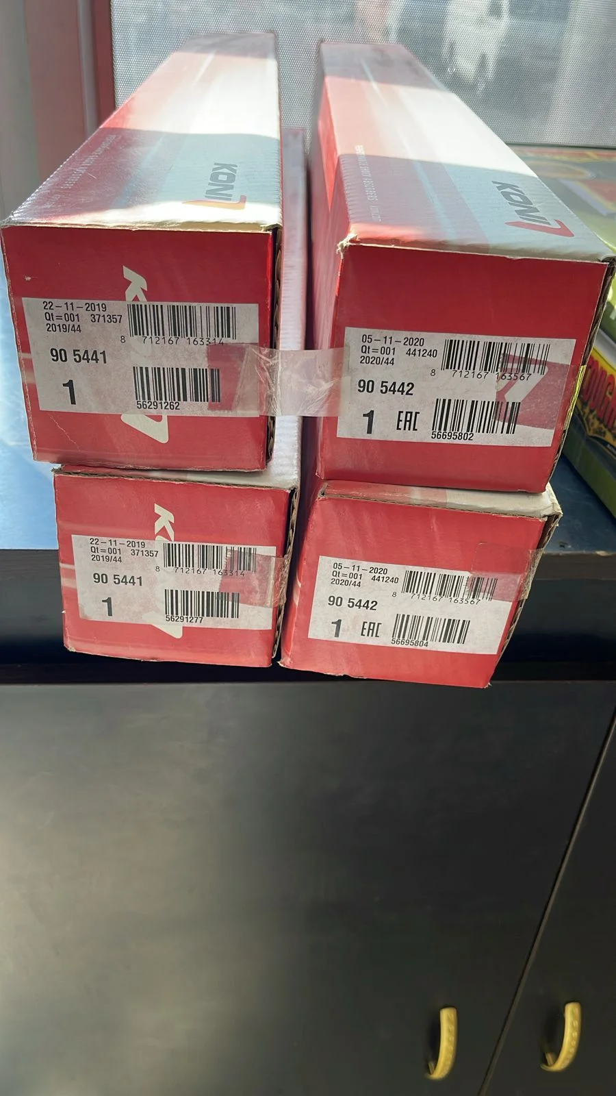

After a lot of research and confusion I bought myself two pairs of Koni HT Raid shocks.
It will be over $1700 with shipping and tax. But I am confused. When I install these shocks, which rebounding setting should I opt for? and how do I do it?
its in the instruction booklet you'll get with the shocks, i cant tell you what setting to shoot for, that something you'll just have to play with and test drive, but you actually turn the shock body to adjust
