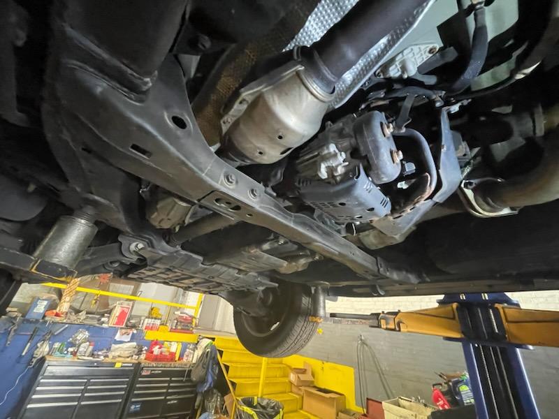

  • The undercarriage appears to be rust-free

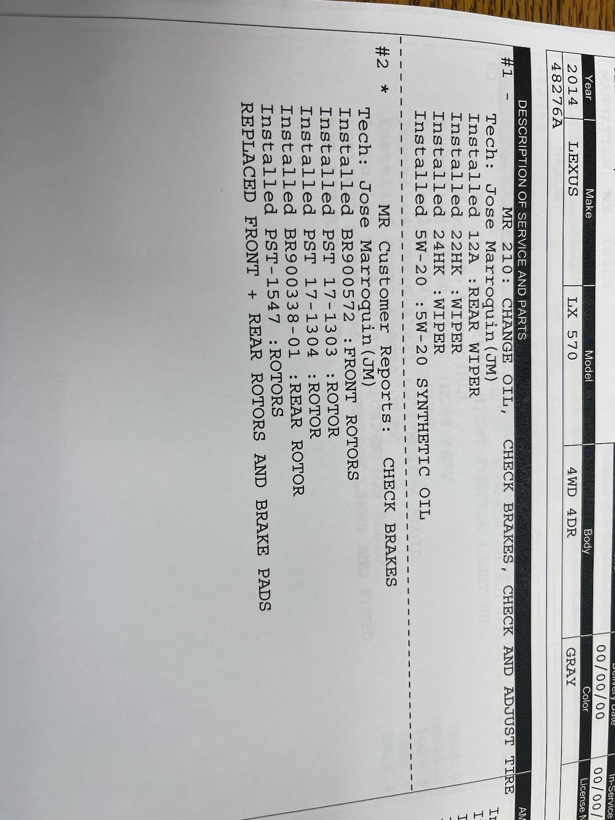

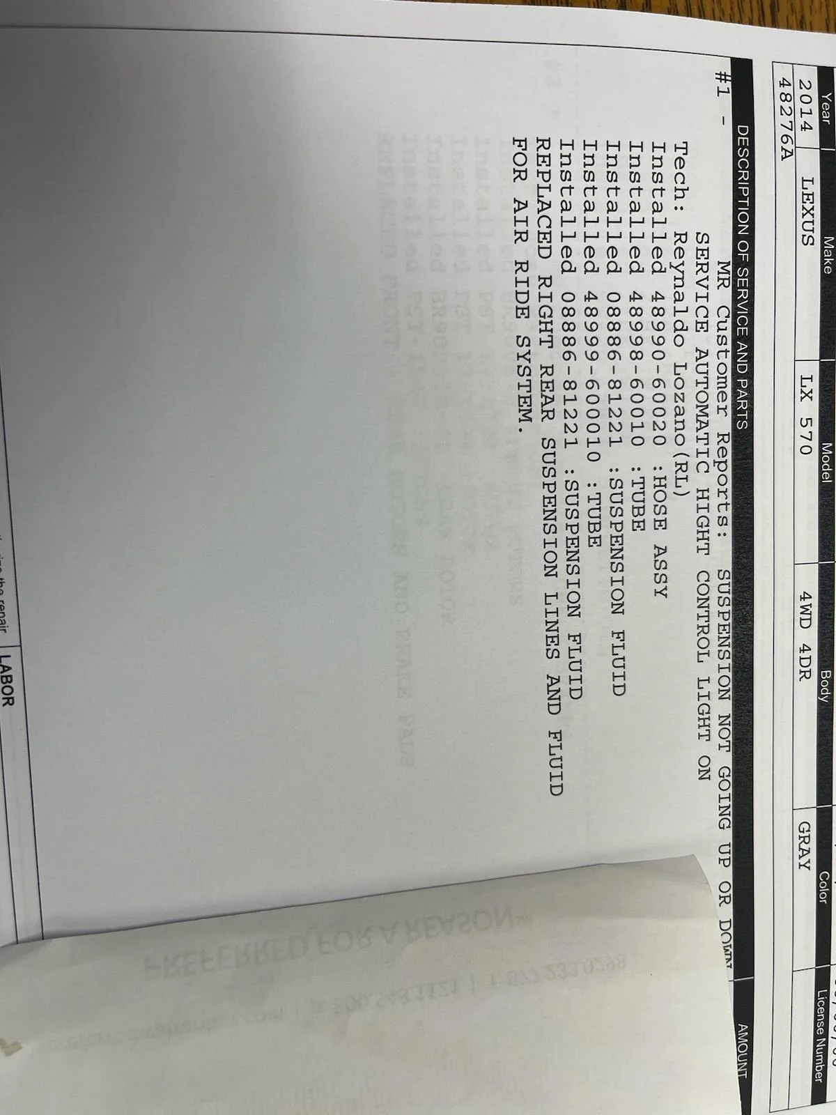

  • Dealer wants $3k in "prep" which they say includes the work done there on brakes and AHC (attached).

No rust yet ahc (suspension lines) were replaced? That does not make sense. Typically, rusts away the suspension line then it leaks.

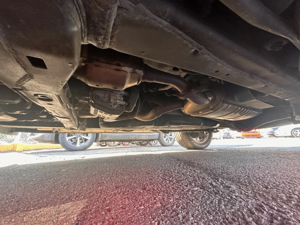

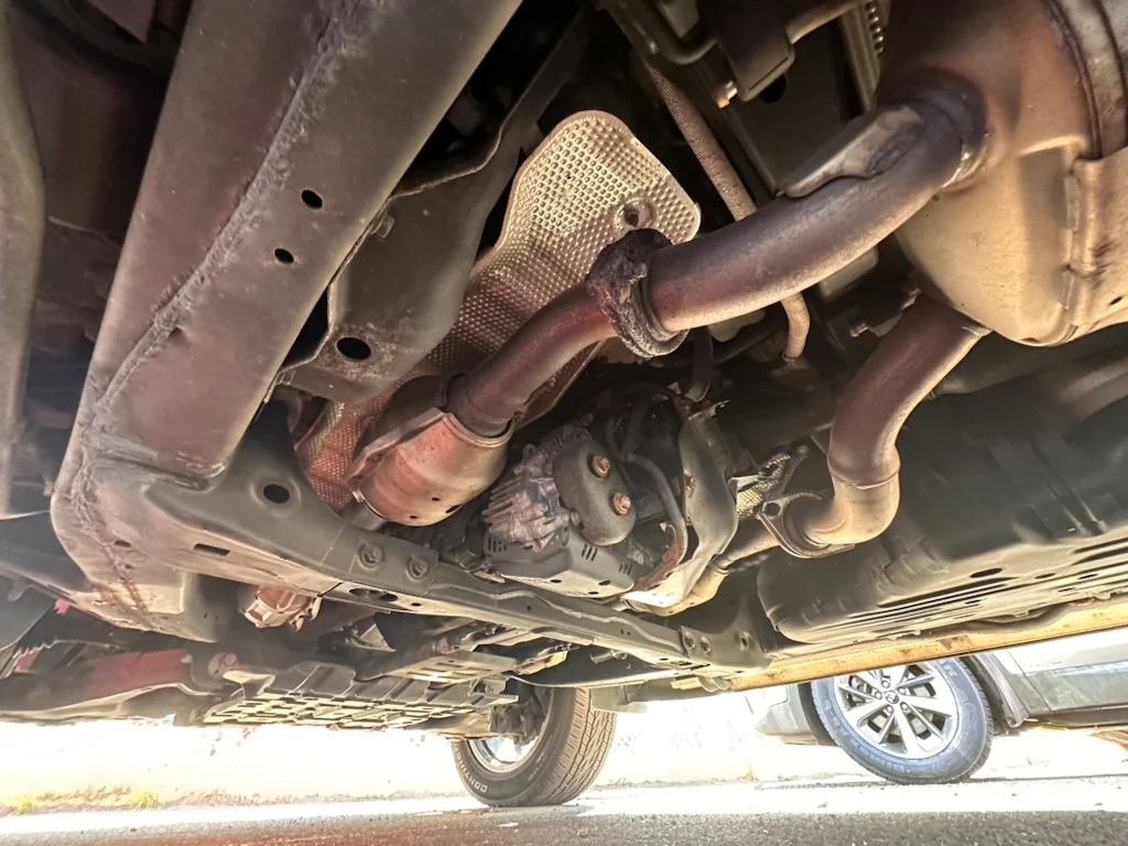

That has to be the cleanest New England undercarriage I’ve ever seen. I wouldn’t worry too much about how they get to their price (re: dealer prep fee) as that’s pretty meaningless. The difficult PPI is a bit shady, but I don’t think the price is too far out for a sub 100k miles 13-15 gen LX With accident history. There is a current thread with a guy shopping out of Houston. If this vehicle was in this list, it would be 34-37k.
First, it’s not rust free. There are some very crusty places and rust was probably the AHC issue.
