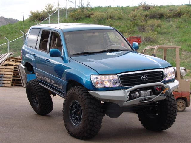

Slee Off-Road Solid Axle 100 Series 1998 UZJ105 :D - AKA BlueBerry
Close to 200 hours of labor, a shop full of parts and 7 days of brutal testing later and we made one of the first UZJ105's
LINK TO COMPLETE GALLERY.
Specifications:
SAS with Diamond housing using 80 Series Land Cruiser 9.5" rear diff and 80 series front knuckles.  Custom chromeoly axle shafts and Newfield Heavy duty birfields.
Marks 3:1 low range gears in transfer case.
5.29 gears with ARB lockers front and rear.
Slee Off-Road 6" lift components as needed.
32 Spline rear axle shafts were converted to 6 on 5.5" lug pattern.
Hi-steer using Slee Off-Road arms and hydraulic assist steering Including a PSC hi-pressure/volume pump and ram.
Prototype front bumper - Warn M12000 winch with 3/8" MasterPullrope.  Wired with interior winch controls.
Slee sliders and modified rear bumper.
Enlarged front and rear wheel wells to accommodate 39" tires.
Interior cage that fits behind the dash.
Custom belly pan.
African Outback touring drawer in the rear.
Heavy duty rear control arms.
Double Cardan front shaft.
Adjustable front and rear panhards.
Two new Yellow top Optima batteries connected in parallel. No management system, but there is an interior fuse box and outlets in the rear that is always hot (for a fridge).

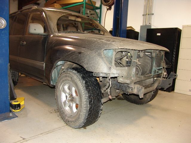

Since we did not get the 100 Series Land Cruiser with a solid axle, we decided to do a solid axle swap on a 100 Series US Spec Land Cruiser. The search for a suitable donor took some time, but we eventually found one. A customer of ours had a 1998 that he drove into a ditch and tipped on it's side. The two side doors were damaged as was the front IFS parts. We bought the truck and had it shipped to CO.
This is what it looked like when we rolled it into the shop.

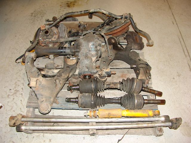

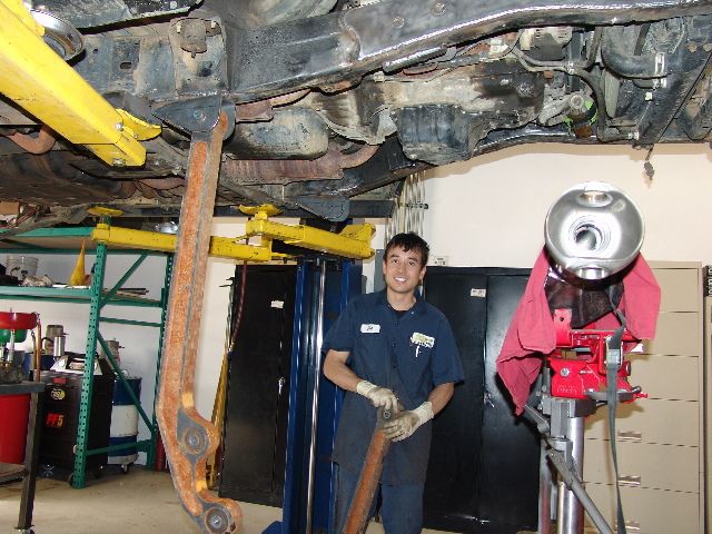

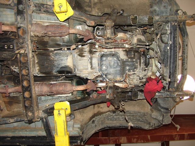

Took a good deal of time to cut all the IFS parts off. We initially thought we could save the motor mounts but after cuting all the cross members off, we decided to remove them as well.
This is the view of the bottom of the truck after all the parts were removed.

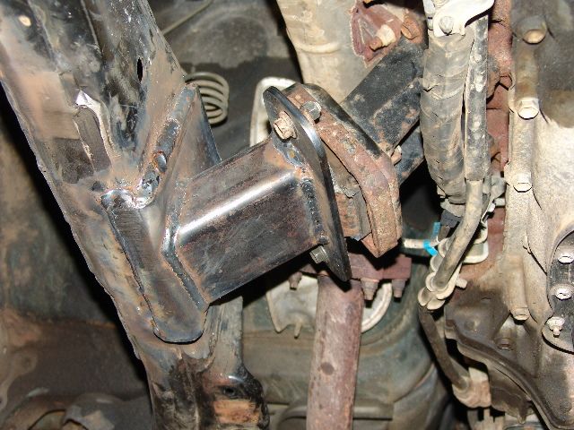

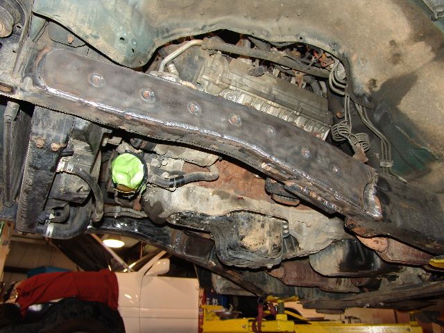

The new motor mounts were attatched to reinforcing plates welded to the inside frame-rail.

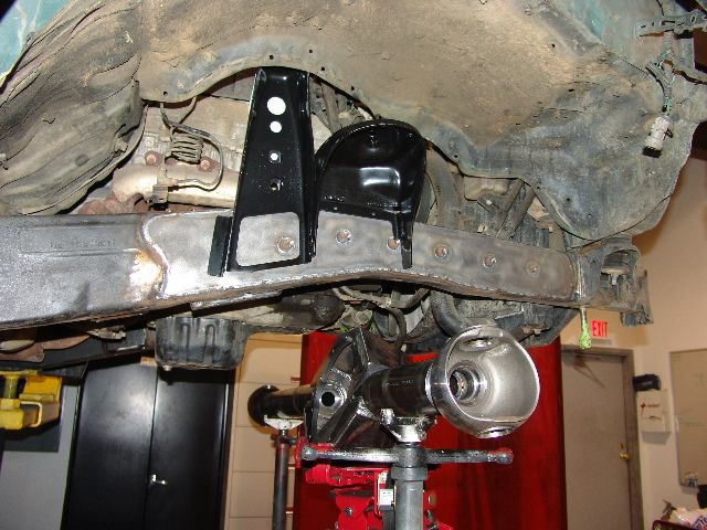

The frame rails were cleaned up and plates attached to the outside. This was done to have a cleaner area to work with as
well as strengthen the frame rails.

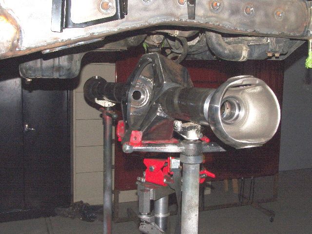

A fabricated Diamond Axle housing was ordered from <a href="http://www.diamondaxle.com/index.htm">Diamond Axles</a>. This housing uses the rear 9.5" 80 Series Land Cruiser diff, with stock 80 balls and knuckles. The axle is 5" wider than a stock 80 series front axle. We choose this axle for it's strength and easy of installing. We did not have to spend hours cleaning a junkyard axle. The width was set up to match the rear axle housing.
We also modified the rear axle shafts to a 6 on 5.5" bolt pattern to allow us to run matching wheels front and rear. The rear suspension was modified using adjustable upper control arms, relocated bottom shock mounts and heavy duty lower links.

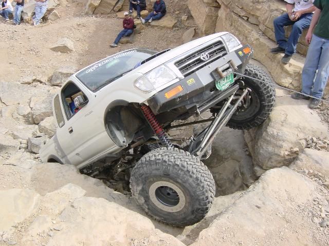

Here is Joe's Tacoma in action at the Chili Challenge.

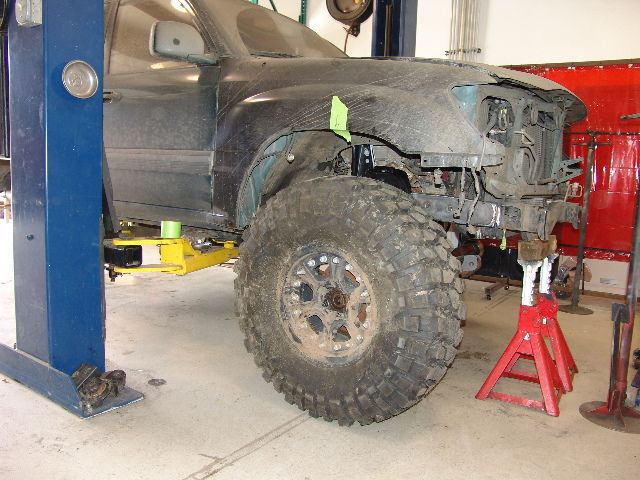

The front suspension was mocked up and tire position and clearances for the 39" Kralwers were verified. At this point ride height was determined.

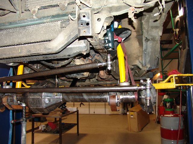

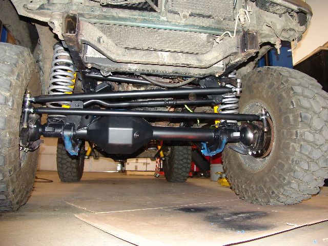

The axle was then hung on the vehicle using the control arms and shocks to locate the axle. Next step was the steering.
We decided that we would use a 80 series steering box mounted to the frame. We used a magnetic drill press to drill the holes in the side of the frame. The holes were sleeved for additional strength. The sleeves were tig welded in place.

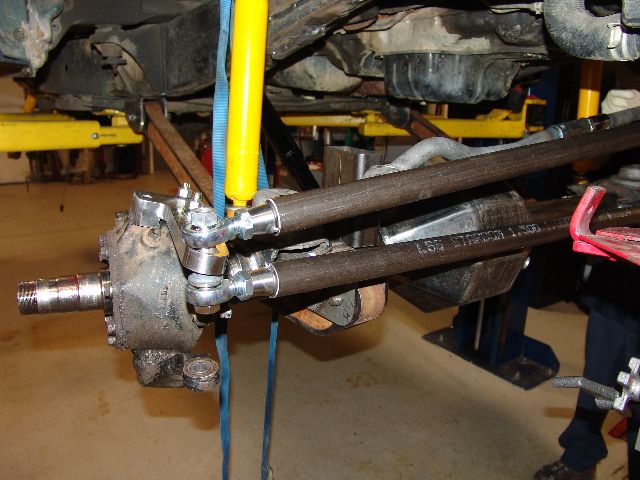

After the steering box was mounted, it was connected to the steering wheel using a combination of 80 Series and 100 Series steering shaft parts. The drag link and tie rod were added and connected to the axle using Slee Hi-Steer Arms for the 80 series knuckles.
Many hours later we had the truck sitting on it's wheels. A 80 Series Panhard rod was installed with custom brackets. The panhard rod angle and drag link angle was set parallel to each other. The panhard rod mount was supported with a cross brace to the PS frame rail.

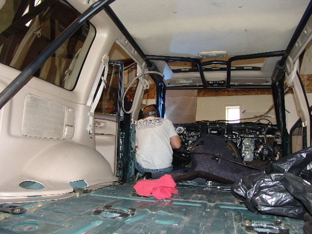

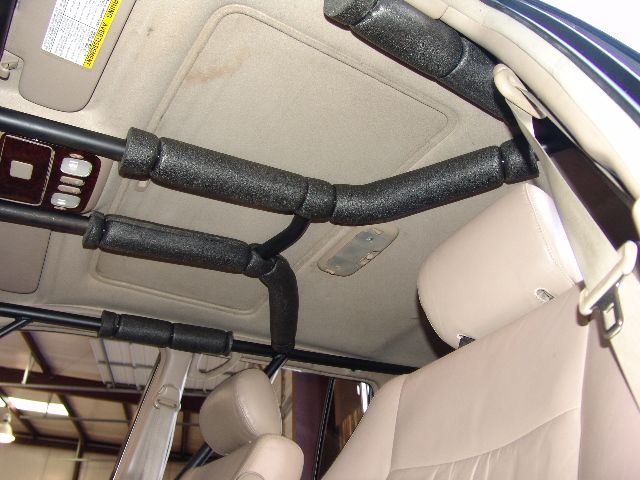

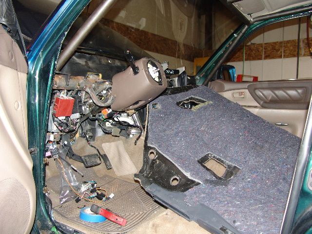

Once we were happy with the truck, Joe and TJ Briscoe (www.homegrowninc.us) set about building a full roll cage. We decided to gut the truck and install a cage that mouted behind the dash. The complete dash was removed. The focus of the cage was to prevent the A pillars from collapsing in a slow roll over. Every Land Cruiser we have seen rolled showed the A Pillars collapsing. The cage was tied into the main cross brace located behind the dash. It was not feasible to run the front legs to the floor as all the electronics are located in the kick panel areas.
This cage was not meant for a Baja 1000 race, but to protect in low spread roll-overs. TJ and Joe did an awesome job in getting this shoe-horned in. Ben would be my co-driver on the Ultimate Adventure and he is 6 foot something, so we had to make sure we had plenty of head clearance. The cage was also extended to cover the back row seats.

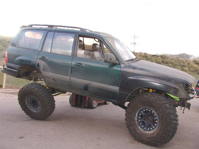

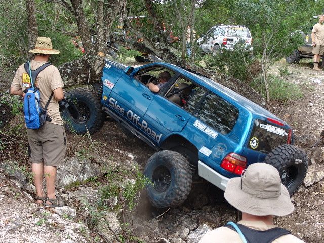

The trucks maiden voyage was Moab and then the Ultimate Adventure 2007. It did pretty well, but if the boss did not drive like a jack-ass, we would not have broken so many parts. However it was all done in the name of research.

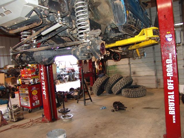

This was day 5 of the UA 2007. Somewhere in Texas. Nothing like tearing down your complete truck in a day to fix broken ring gears and axles. Thanks again To Brutal Off-Road for the use of their shop.
