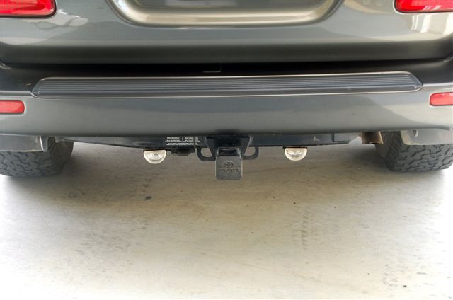

This is the business end. I installed extra lights that are triggered when the truck is placed in reverse. They make a world of difference with the dark tinting, especially at night.

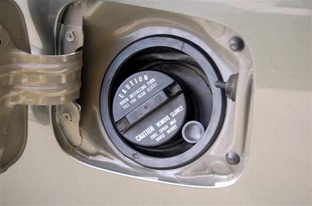

Tucked behind the towbar is an auxiliary fuel tank. I got in on a group buy with a handful of guys on mud and with a little extra container space (Seth's PV Cruisers), about 10 of us brought in Australian fuel tanks. I need an aux. fuel tank like a need a third nut, but it's pretty cool filling up at Costco once a month. Despite copious amounts of bitching, my mechanic installed this monster.

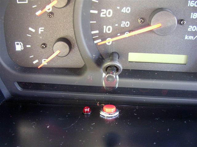

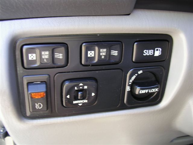

It's set up like a big jerry-can. When I want to transfer fuel from the aux. to the main tank, I press the "sub-tank" switch (thanks Christo).
It triggers a timer relay which activates the transfer pump for 10 minutes. As fuel is transferring, a red LED indicator light (installed on the gauge bezel) blinks to alert the drive of the transfer. If it gets activated accidentally, or I want to kill the transfer, I've installed a button that turns off the relay which turns off the transfer pump.
Dual filler butterfly actuator. If pulled out, fuel is sent to the aux. tank.

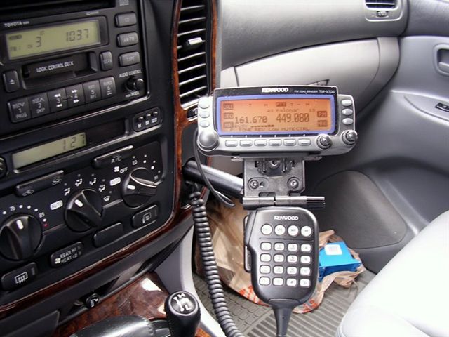

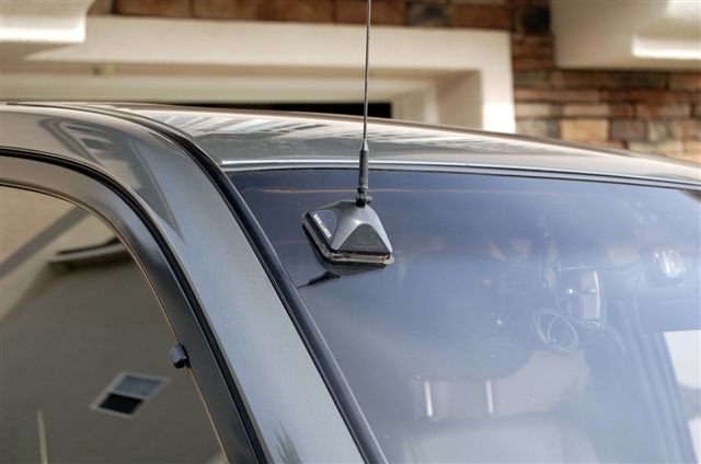

A couple years ago, I started exploring ham radio. I started with a handheld, then installed a mobile unit in the truck, ultimately followed by an HF setup at home. I installed the Kenwood dual band unit which is powered from the auxiliary battery (sits in a Slee dual battery tray [shameless plug]) which is electronically isolated from the primary battery by a POWER-GATE battery isolator. This allows me to leave the ham radio on for days on end without worrying about having to call AAA for a jump.
The ham is wires to a Radial Larson on-glass antenna which works nicely.

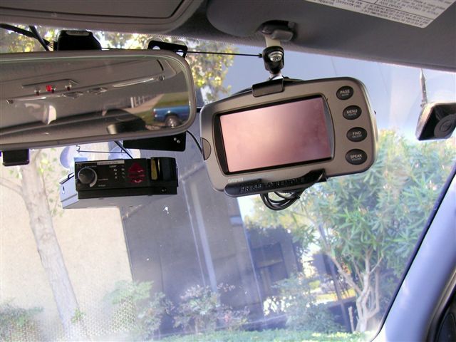

The GPS is a Garmin Streetpilot 2610. I started with a Garmin V, but the screen was so small, it was hard to use. I installed the Garmin on a long screw which anchors in the sunvisor mount. It's rigid and has held up nicely for a couple years now. It's hard-wired to the power in the overhead console where I also installed the Garmin speaker. The Valentine-One radar detector is also hard-wired to power overhead, however I'm not in danger of breaking any speed records in this brick.

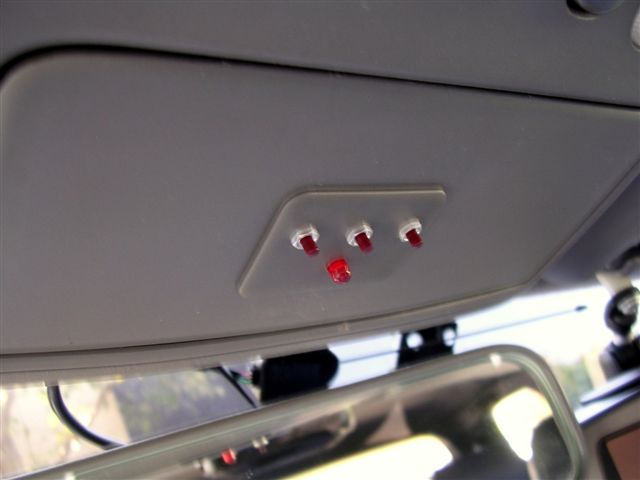

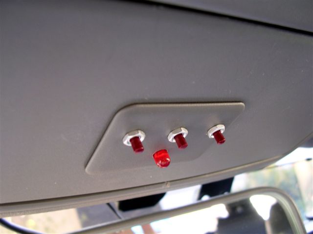

I bought a Homelink Garage Door Opener module on ebay, took the guts out, and wired it to micro-buttons and LEDS. Then I stashed it in the remote control pocket in the overhead console and hardwired it.

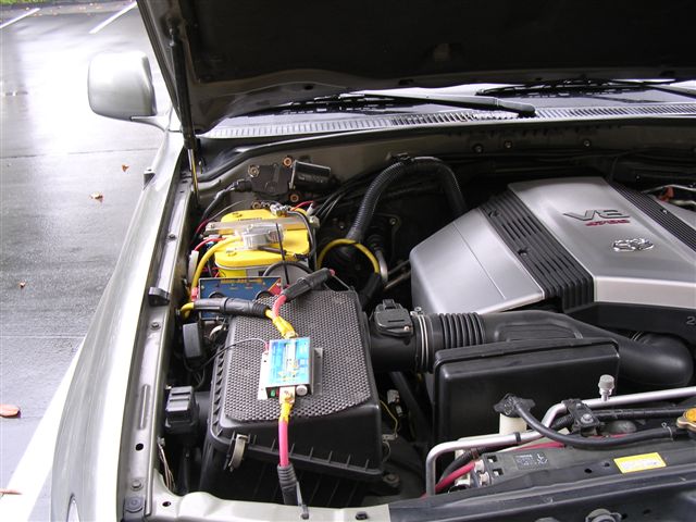

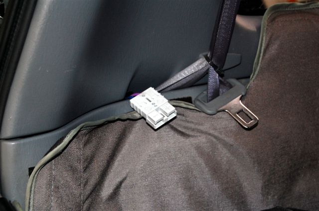

I ran a cable from my auxiliary battery to the rear of the truck. This powers the aux. fuel tank transfer pump, the backup lights, and the aux. power circuit which I terminated with a 50 amp Anderson/SMH connector. My fridge, compressor, worklight, and any other power accessories are also terminated in mating connectors.

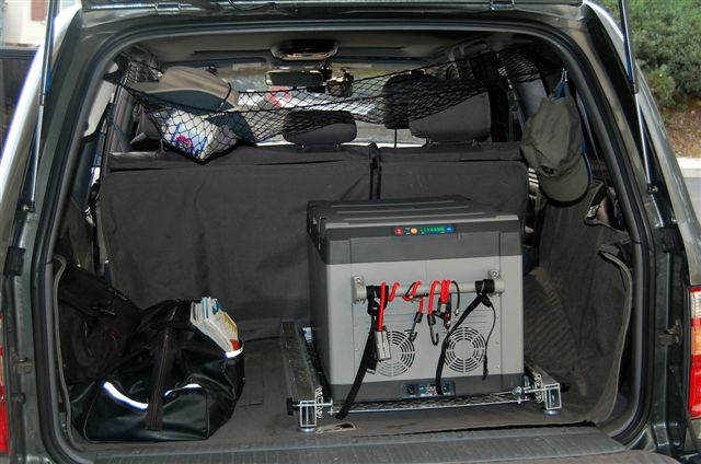

After a few conversations with Spressomon, I bought a Waeco fridge. It's a big sucker (80), but it's so nice to have on trips. It's powered by the POWER-GATE protected aux. battery so I can run it for days without fear of the truck not starting. As you can imagine, it's heavy and tough to access with lots of gear in the back, so I built a slide out of some aluminum rectangular tubing, brackets, etc.... With the heavy duty slides, it's pretty heavy, but I anchor it to the floor of the truck, then strap the fridge to the base. Smooth as silk! Shortly after I bought the truck, I installed a product called Rear Gear which completely covers the entire back end of the truck from scrapes and cuts. It's good stuff. I also installed GT Cover's rear seat covers to protect the rear leather from kid and dog...again, money well spent.
Of course, truck is naked without an on-board welder! It's tucked between the airbox (POWER-GATE on top) and aux. battery.

Nice Job man! The electric mods are my next up. Any more details on your dual battery setup? I am trying to decide whether to use the DIY National Luna Kit or just by the intelegent solenoid and source the rest locally. Is the controller necissary?
Nice truck and cool gadets...Is that bracket which hold the GPS strong enough?? And what did u use for the ham bracket??

I got the dual filler neck (I think) through SOR. Kevin Speicher at Baja Overland (Baja Overland) was kind of the point-man on the group purchase and he pointed me in the right direction. Unfortunately, I don't have the Africa pics digitized. I drove a sh*t-brown Range Rover with what has to be some of the most retarded engineering I've ever seen. I don't want to go into painful detail, but I came out of the experience vowing never to own another Land Rover product. The saving grave being that British expats in Kenyna LOVE Range Rovers so it worked out financially for me.
Travis, I use a POWER-GATE isolator which is a solid-state device ( I know a guy). The way it's set up is the alternator charges both the main batttery and the aux. battery all the time. When the aux. battery is used for accessories, the aux. battery can be discharged without the main battery being discharged as well. The company I work for manufactures the device, along with devices that can handle up to 700 amps with no moving parts, no heatsinks, and no airflow required.....it's an amazing piece of electrical hardware. That said, they aren't the cheapest devices out there. National Luna, smart solenoids, etc.....allow you to connect or disconnect batteries using a mechanical relay. Some would argue that mechanical relays are terrific because they're cheap and when they fail, they're easy to replace. Others would argue that using mechanical relays suck because the contacts pit with arc-ing, require a lot of current to drive the coil, and are guaranteed to yield increasingly degrading peformance over time until they ultimately fail....both arguments are valid and true IMHO. We believe in solid-state and our customers are engineers dealing in high-current DC applications where conventional relays and isolators just won't do. They're particularly attractive in high-vibration environments where mechanical contacts degrade rapidly.....and oh yeah...they work in Land Cruisers too.
So far, the GPS has not come down so it appears to be strong enough.....only time will tell. I had a suction cup mount before this scheme but the suction cup degrades with sunlight so after going through two of them, I decided to come up with a different place to mount it. I dont know the brand of the stem and bracket for the ham mount....it was originally a cell phone holder thingie and when I went from a hard-mounted car phone to a pocket cell phone like the rest of the world, the post and bracket was left behind.....I just drilled and modified it to hold the ham stuff. I think it may be a RAM Mount post but don't hold me to that.

I never thought of the gauge bezel as a suitable place for installing switches and lights, but it has a lot of usable space.

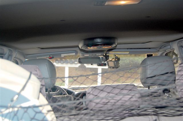

What's that step/table/tray thingy in the rear?
Not sure what you're talking about. Are you referring to the cargo net that hold my hats and emergency toilet paper?
No, but I also like the paper holder :)
Sorry if I wasn't clear. I meant this:
