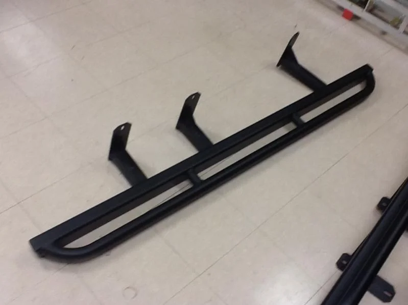

Update: sliders are glass-blasted and Powder coated. I went with black textured pc instead of smooth, turned out really nice. Now they are at LineX getting the mounting arms coated. Also having them LineX the wing brackets for the Slee rear bumper. Took the rear bumper off, cleaned up a little rust around the trailer hitch, and put a coat of primer on it. Hopefully have the sliders and bumpers back on next week.
Sliders are back and installed! You can see where the mounting arms have been Line-X'd. Hopefully no rust for a long time. I'm actually digging the open steps for now but will probably add the new step plates that Christo sent me.

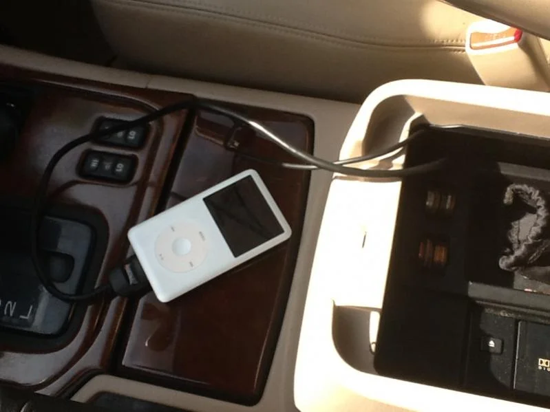

The Clean Sweep is pretty cool. It processes/equalizes the signal from the factory head unit and it also allows for an additional input. I had them install a dual cable that has both IPod and headphone connectors in the center console. There is no interface to the factory system when using an IPod; the volume has to be controlled from a secondary volume knob when using the IPod because the signal is coming in after the factory head unit.

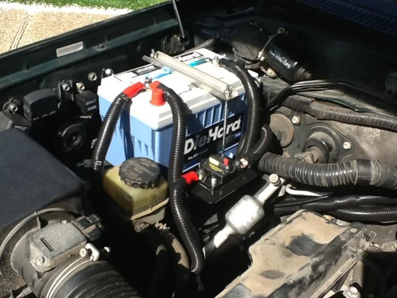

I also had them make all the connections for the IBS dual battery management system. They upgraded all of the factory ground wires (body, frame, and engine) as well as the wires to the starter battery and alternator. They also ran heavy duty wire to the auxiliary battery, to the 150 amp breaker and then back to the fuse block in the rear cargo area. The JL Audio amp and Clean Sweep are connected to the rear fuse block. I also plan to install an air compressor and power inverter so the wiring has been run to the fuse block to make easy connections once I install the new gear. Note the last pic with coiled wires, just need to connect to additional gear and add fuse.
The factory 12 volt outlet in the rear has been rewired to be constantly powered to the rear fuse block along with 2 additional outlets that were added to the rear cup holder area. All 3 of these outlets are on one fuse. A dedicated 12 volt outlet was added to the passenger side wall for the Waeco CF50 fridge.
Dual LED lights were mounted to the rear lift gate trim and then the wire was run through the factory wiring boot into the rear cargo area and down to the fuse block. A simple toggle switch was added to control the lights easily.
My Cobra CB was mounted half-assed for a long time so this was also installed properly. The base module was installed in the center console and the mic wire was run out the side. The mic now hangs from a Slee CB mount on the dash. The antenna wire was run through the firewall out to the front bumper.
All of the electronics that have been added or will be added in the future all draw from the auxiliary battery to ensure no issues with the starter battery.
