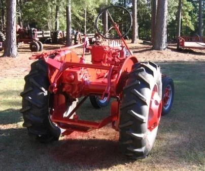

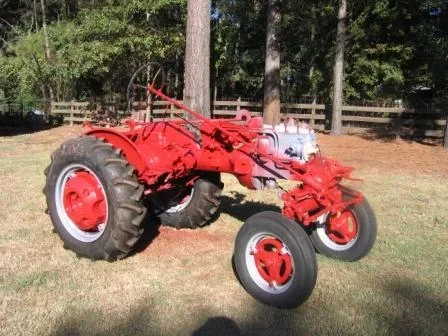

Sorry I don't have before pictures, but this is what the guy has done so far.
This tractor was completely disassembled nearly ten years ago then left in a pasture for about 8 years. I got it back 2 years ago and took it to a gentleman that specializes in restore old tractors.
He just had one statement when it arrived on the trailer, "The only thing that would make this tractor feasible to save would be if it is sentimental."
I had grown up on this tractor, I don't know how many days I would go out and climb up on this thing and spend all day plowing, mowing, putting out hay or hauling firewood or post.
can't figure out how some of these guys put such large pictures on, the older man that is doing the work isn't big on digital stuff so these are the only pics i've got.
hopefully i'll get some more later
serial number was trashed pretty good, but mr. parmly looked up what he could and said it is between a 52-54 model. four cyl engine.
it hasn't cost me a dime yet, and you can see in the picture the grey area around the engine block. the engine wasn't painted because it is coming off for a total rebuild. it may take another several months to finish that and have it running. then i'll be going down to texas and picking it up. i'll pay for it then. but it still won't cost much, mr. parmly is doing this as a favor + parts cost.

That's not a Farmall Model G? I'm thinking that the model A has a front radiator and grill, but could be completely off base. Tractors are a new hobby/tool for me.
So far I'm being tempted to buy one of the Farmalls for a project because they have such a neat tractor look to them. I've got two tractors but both are new and not fun as far as tearing down and building back.

i guess i should have stated, that is not the whole tractor. it is a model a, and it is missing radiator, grill, tank, and a bunch of other stuff. it is all getting sand blasted and painted as well.
If you can make out the #s heres a list...... 1947:250001 1948:250082 1949:268196 1950:281269 1951:300126 1952:324470 1953: 336880 1954:353348

from what i remember seeing it would have to be a 52 just by default, according to those numbers.
