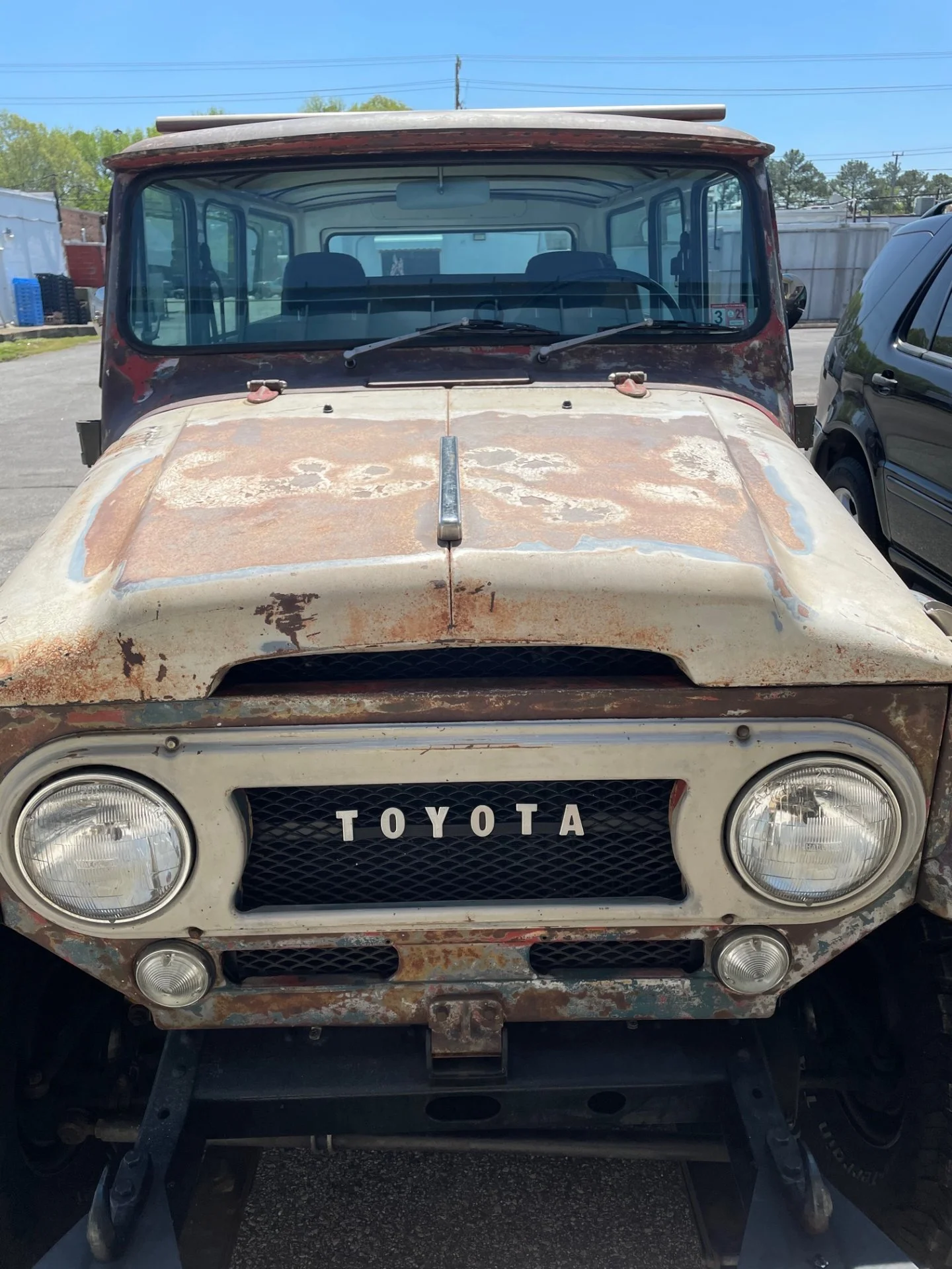

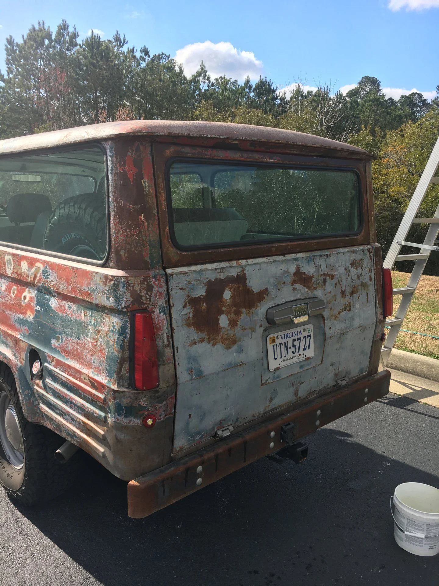

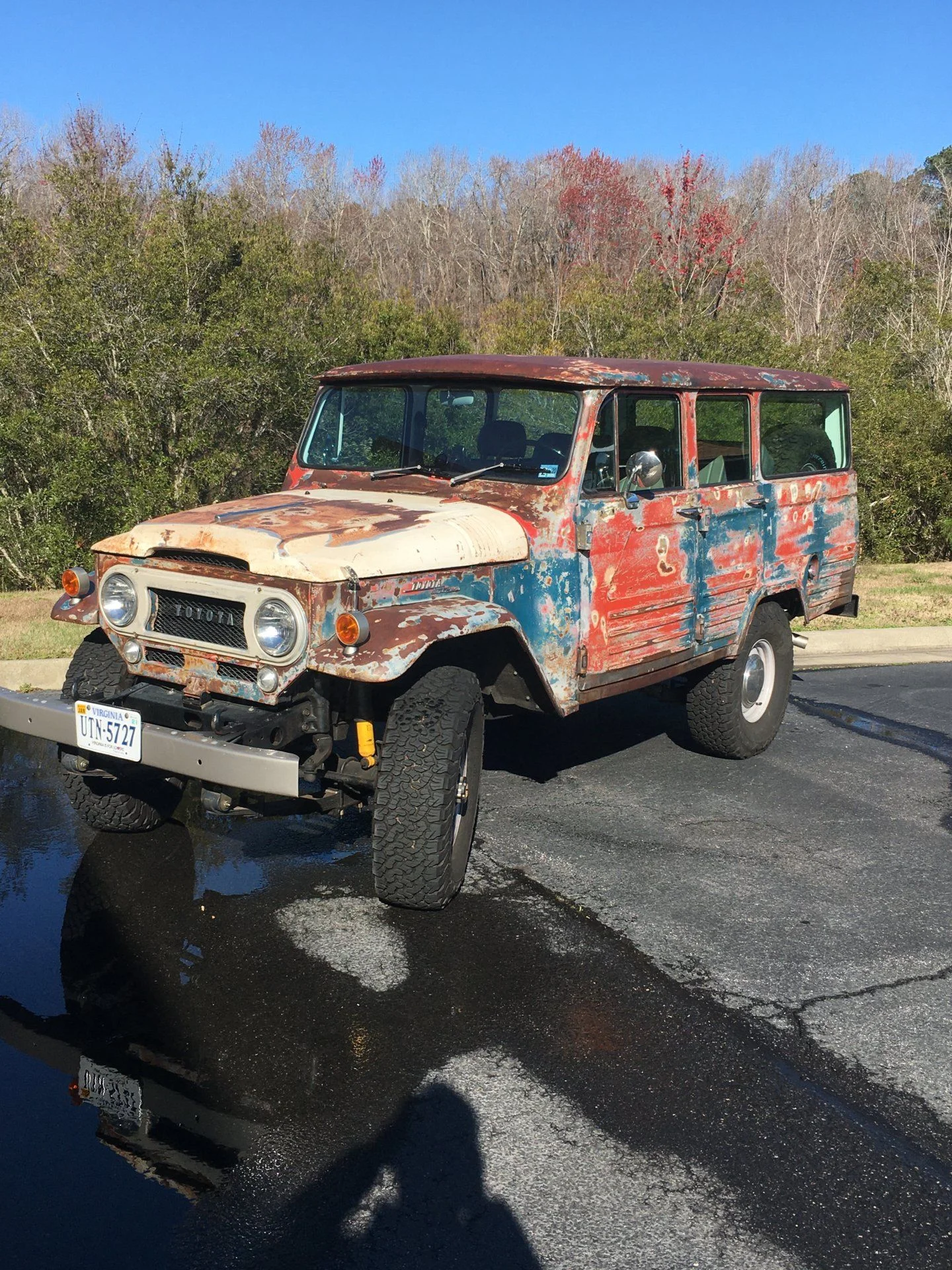

The "Patina Preserver" I got from Eastwood gave up the ghost and the rust started to turn bright orange. It lasted about three months. Way too short to use it again considering you have to tape everything off to spray it. So I am switching to another product. I did the CLR scrub down followed by a good wash with paint prep solution. Then I will let her dry for a few days until I get some warmer weather! She's as clean as she has ever been!
I have read the whole patina thread and looked around the internet and read all I can find about what I can use to keep the rust from continuing. It came down to Fluid Film and LPS 3. they are very similar products. I bought both and did some testing on a rusty piece of painted metal outside my shop. They both worked well but the LPS 3 actually dried over a few days and this was the deciding factor. For the exterior body, I needed something that I could wipe on and would dry. For all the other undercarriage places, I would use the fluid film because it doesn't dry and will keep working its way into those nooks and crannies.

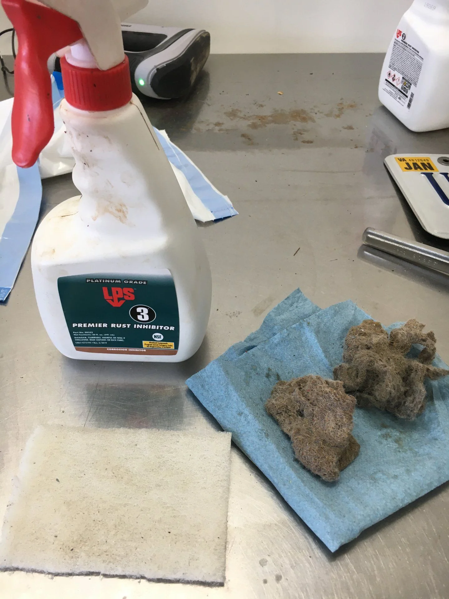

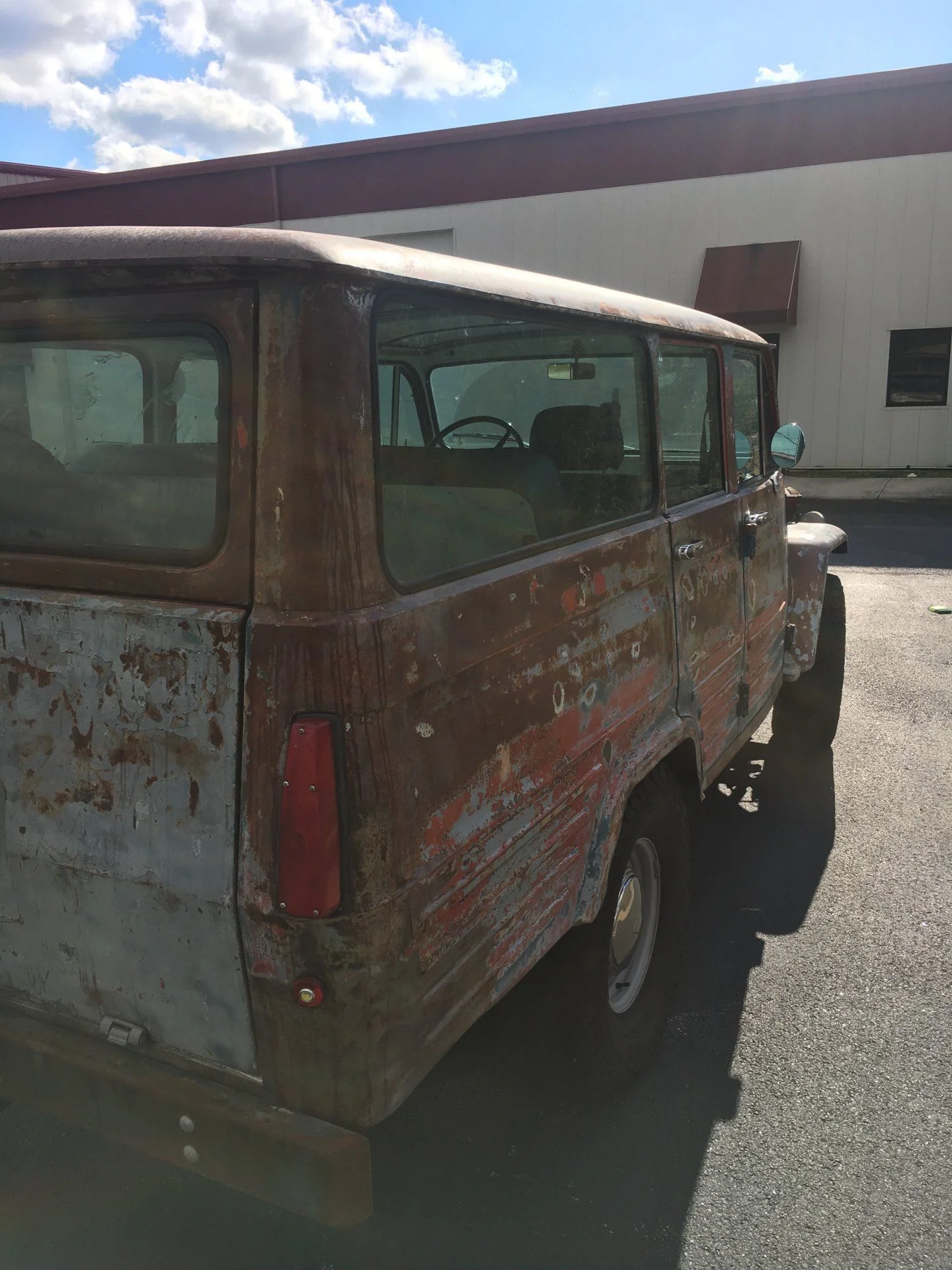

I got three 20oz spray bottles and a 6 x 9 white scotchbrite pad. I cut the pad into quarters and put on the rubber gloves. I sprayed and rubbed for the next two and a half hours. All the door jams, eyebrow, and those little pockets above the front doors. I got it everywhere I could. It took about one and a half bottles. and three of the four sections of scotchbrite pad. You can see what they looked like after I was done. While the stuff is a brown liquid, it did not really show itself except on the white hood. I wiped the extra off of the white paint with a paper towel and it looked fine. didn't even show elsewhere on the paint and didn't darken the rust much either. I think it came out really good. It dries to a waxy soft feel with a flat luster that I think works well for the rust and the old paint. Now we will see how it holds up!? It is already a lot easier to apply and no taping off! I used a paper towel to get it off the rubber seals and the paint on the inside of the doors. I only got a couple pictures but will post more when I get it out in the rain.

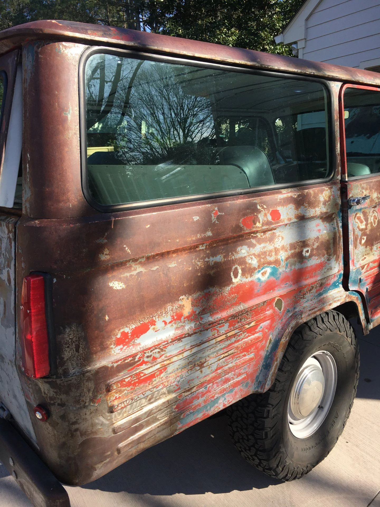

Not a whole lot going on. Been drivin' and smilin'! I did have to change the oil since I hit 5000 miles and I was painfully reminded that I have not finished my build book for the LV. Took all weekend to find the right oil filter because I used a different low profile pan from an '07 or later Camero. Had an injector circuit code coming and going I could not figure out. Took it to my mechanic and it seems I had four injectors misfiring. He traced it back to old corroded connectors, replaced them all and now it is smooth running again! The LPS-3 I put on the body seems to be holding up well to driving in the rain. Still have a windshield leak I need to trace down. Correction, the installer needs to trace down! He has tried three times now. He did not use any sealant when installing? I asked him about that and he was confident I did not need it and he said he would repair any leeks! I am thinking he will not be happy to see me again? Oh well, his fault. He should have used the sealant.

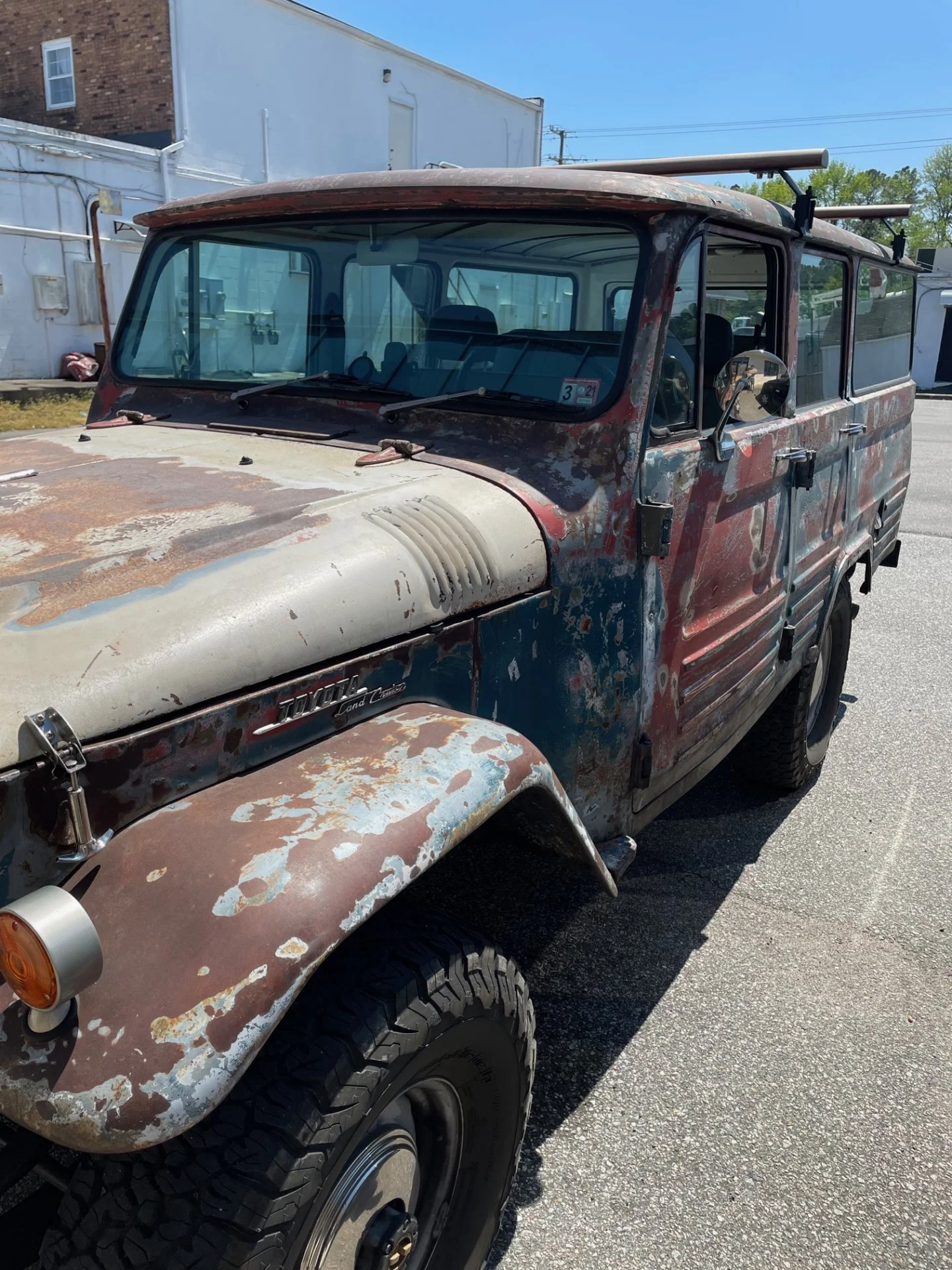

Haven't posted in a while. Just been drivin'. Got about 11k under the belt now and so far so good. Really pleased with it all. I have a minor leak in the a/c that I am chasing down. Made some roof racks. Put a second round of the LPS3 rust protectant on the outside. The paint is still flaking off a little bit each time but it is minor. I guess if it ever gets down to it and all the paint has dropped off I can paint it?
