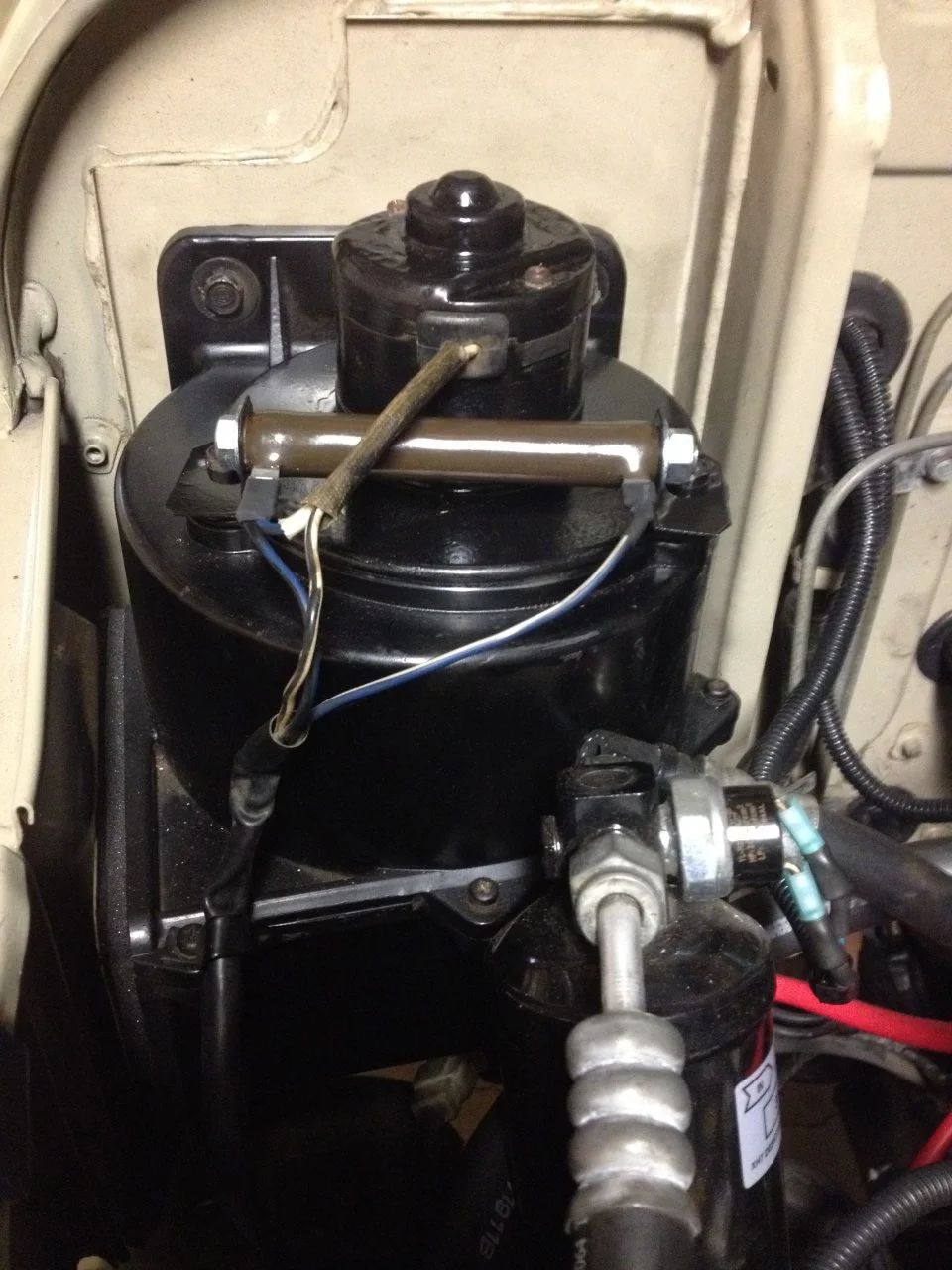

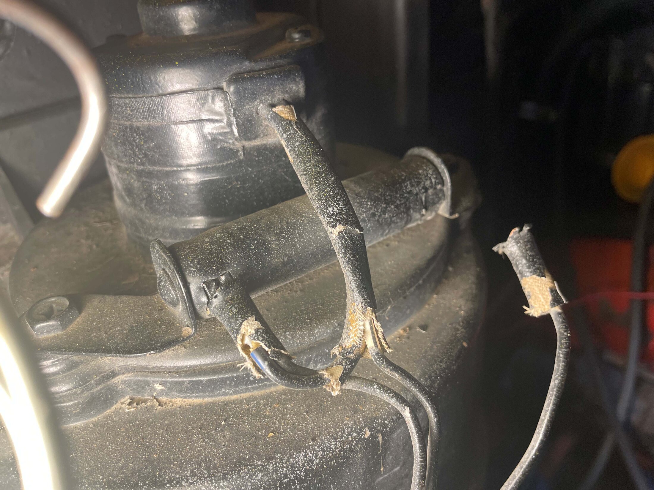

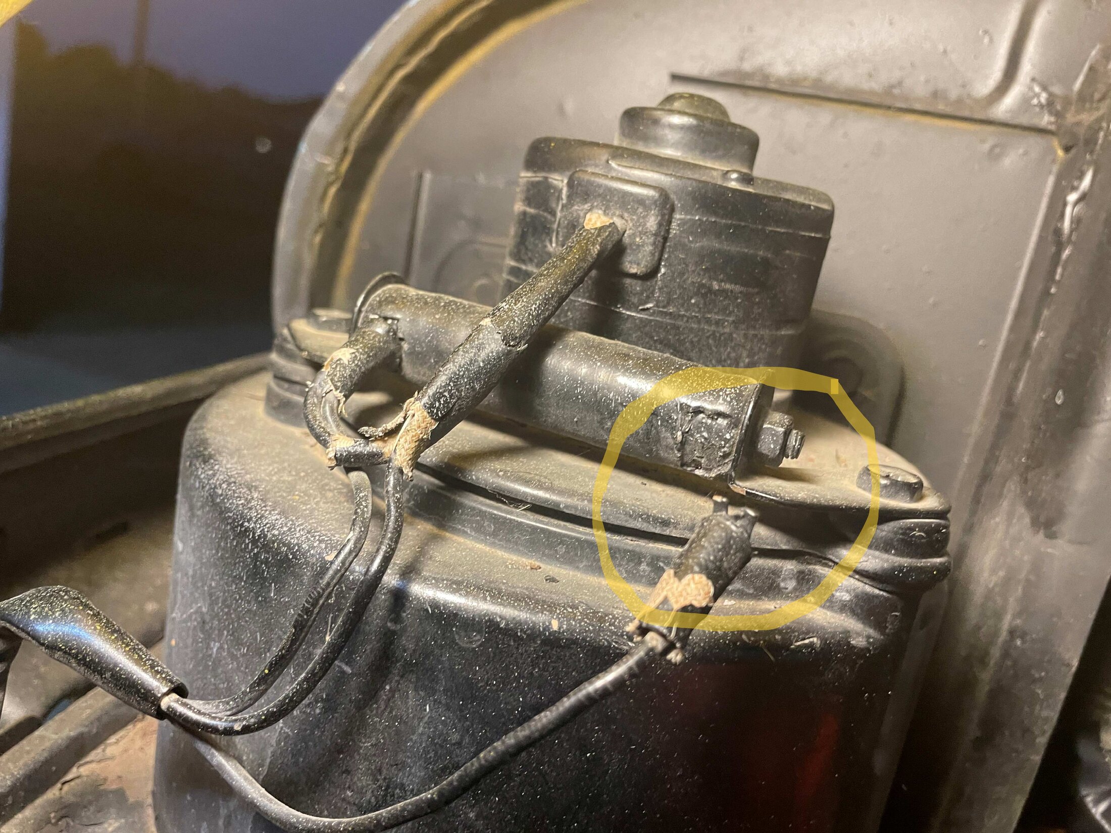

Can this be repaired where one side has lost it's connection?
Thanks for your help!
I think folks have found a replacement for that resistor. You might try using the search function. Or maybe someone will chime in.
Yeah, unlikely to get a good fix there methinks.
City Racer has a replacement, although any 1ohm ceramic tube resistor would work, depending how "OEM" you want to be (or not be).
It seems to me there was a thread not to long back with a "replacement resistor" than was Like $20 plus $10 shipping from some electrical warehouse type place. Google found it by description and part number I think.
I"m for trying a fix - Pry and scrape around the broke area and see if you can get enough contact clean to solder it back on. Might have less resistance so motor runs a little faster in low - who cares.
Let me start off by saying that I am no wizard at wiring. With that said, I got one of those cheap 2 speed resisiters and wired it up myself. The low barely spins at all, but high works fine.
Once I get my rig back together, I am going to spend the coin and get the one at Cityracer.
Yea I'd try and fix that too - the broken contact is usually part of a steel band running around the wire resistor - have a scrape around the top of where it broke. You might find it easier to spot weld it back on though
