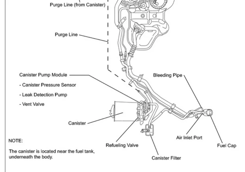

Along with the charcoal canister the edit <canister filter> will need to be moved. In addition the portion of the <canister filter> hardline that is on the filler assembly will need to be cut off and attached to new filler (or left there) in the swap. This is at atmosphere pressure so it can go pretty much anywhere, and I think I’ll be replacing the hardline with some fuel hose to ease routing and placement. Depends on where the <canister filter> ends up.
without the tank it’s hard to say where the charcoal canister will end up, but a leading contender is outside the frame On the left side. That would require extending everything. . . For non ahc equipped likely outside the fender on the right side.

Based on what other folks who relocated the charcoal can wrote, the harness will reach behind the passenger side wheel well. So just the plumbing will require extensions.
I have an LX570, so this location already has the AHC reservoir and pump in it. It may still fit, depends on how much real estate the sub tank actually takes. If it doesn't fit only the US driver side behind wheel outside of frame is left. Definitely some work to get it over there. The more I look at the canister actual function though, the less I worry about impacts of moving it. These are all vent or evap lines, not liquid containing. The vent line post canister doesn't even have hose clamps on it . . .
