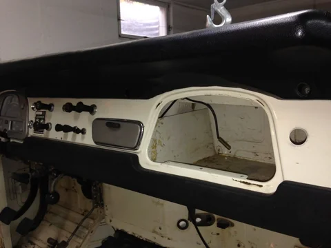

Need help learning where the radio was installed in my '71 FJ40 FST. It came with the Fujitsu AM radio Part No. 08600-00013. I have the original owner's guide and Warranty Registration Card to prove this, plus it has what looks to be a factory antenna mounted just in front of the driver's side air vent. At some point, the radio was ditched and a CB radio installed inside the glove box hanging from the top of the box. The dash on a '71 has no apparent opening for a radio. Was the original AM radio mounted in the glove box or somewhere else? I'm looking for an original radio on eBay and want to locate it in its original place. Thanks!

From what I understand a factory installed radio wasn't an option until 9/72. Edit: that was the year the hole was added to the dash. Maybe there was a dealer kit or option. Im sure there is someone here that can give you a def answer.

Upon closer inspection (ie, I put my glasses on), yes the two column bolts held a bracket in the past, and the bolt in between looks like it held the ground wire. Still searching for original speaker location... there are two holes in the glove box floor right behind the door hinge and evidence there was a bracket mounted under the box. Suspect that may be it. Also scored a '70s Fujitsu Ten radio with same Part Number. On my way! I must say, I looked through hundreds of images of FJs and saw none with an original under-column radio!
To close the loop here on the question of where the speaker was located for the dealer-installed Fujitsu Ten radio, I was able to find the original owner of my truck. She said the speaker was on the firewall in front of the passenger seat. She said "if the person in the passenger seat put their feet straight out, they would hit it." She ditched the radio and speaker for a CB radio in the glove box in the '70s... 10-4 rubber ducky!
