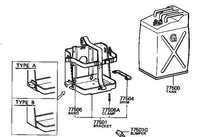

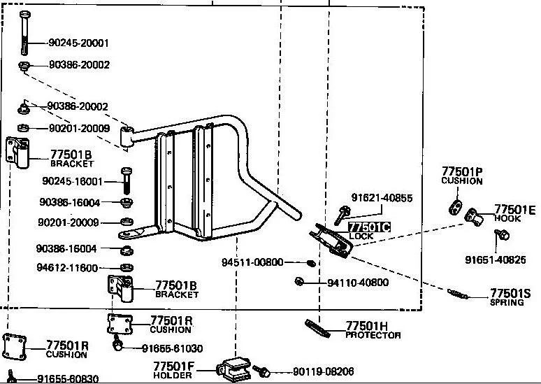

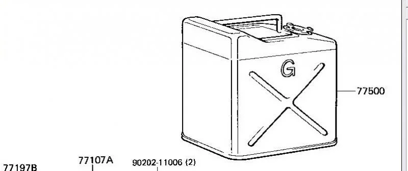

i did some more searching through the EPC and they also list a bracket for the 70 series models and some 60 series that fits that toyota fuel tank #77100-60011 the bracket looks different than the 40 series bracket . 70 series bracket # is 77130-60050 i attached pics of the 40 series stuff and 70 series bracket from the epc. but both brackets fits the same can .so pic is deceiving
there also is a type A or B mount
first pic tank and bracket 40 series, second pic 40 series mount.

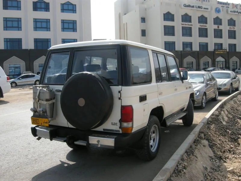

Ehsan, you have some of these with those mounts? ( image below )
