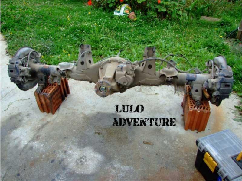

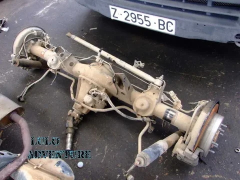

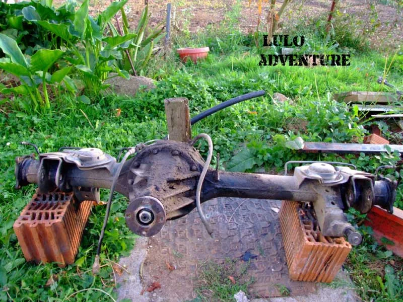

I buy 90 series VX (Luxury Edtion) rear axle with Factory Diff E-Locker :grinpimp:

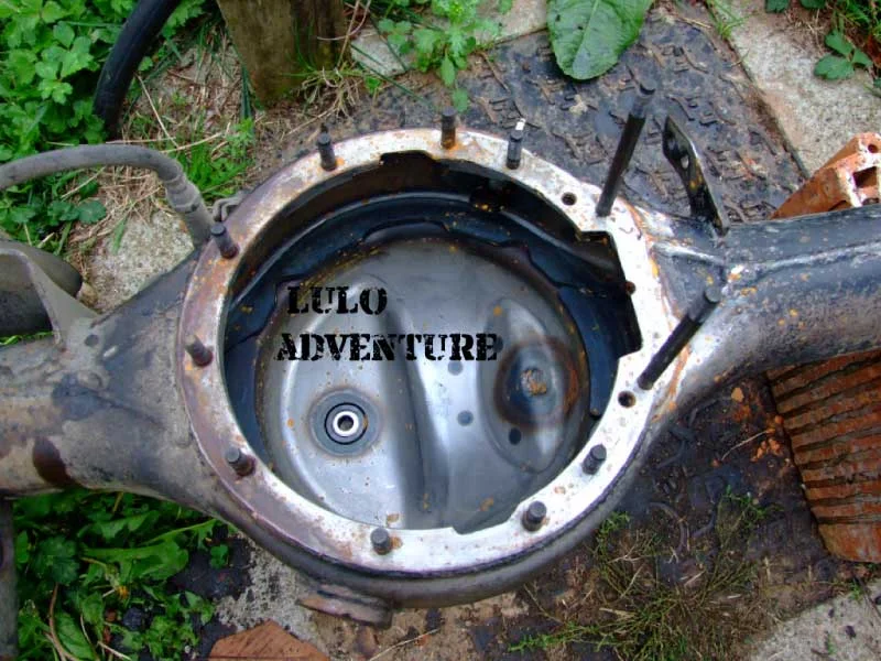

Factory Diff E-Locker ---> (LULO LJ-70) Part 2
In future attempts to bring the disc brake system on my rear axle :wrench: :hhmm:
My dirty rear axle... :hillbilly: (waiting the new toy :popcorn:)

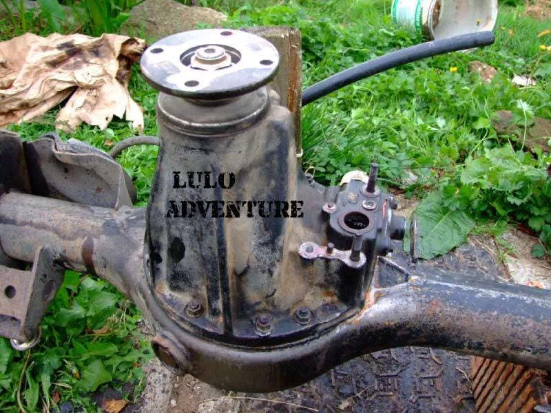

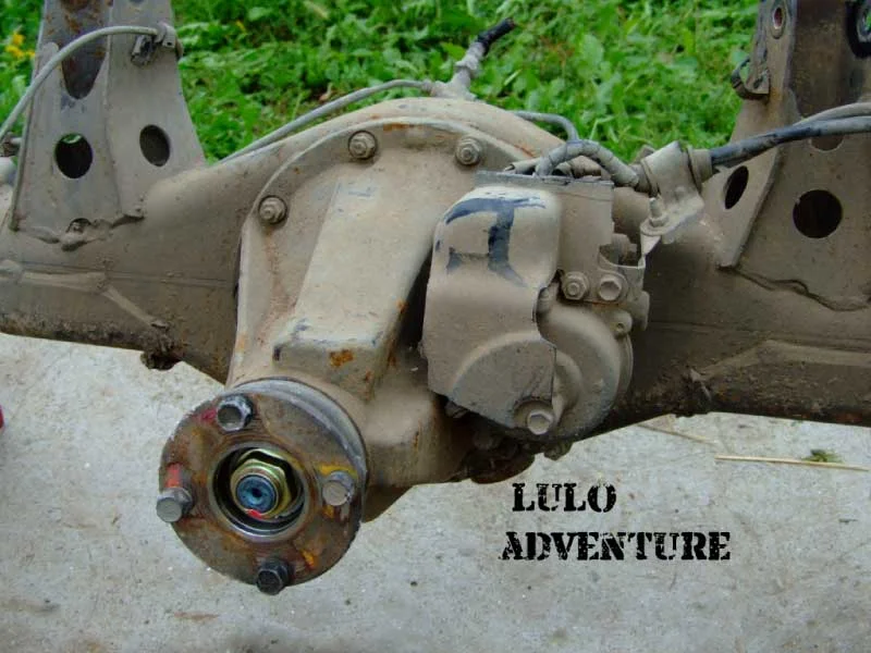

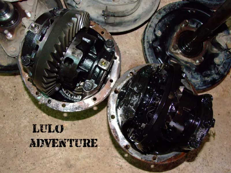

The left Third Member (Factory Diff E-Locker) with new Gear And Pinion "YUKON 4.88" :D, the right
Third Member (Factory Diff 4.88) ----> K.O. :hillbilly:

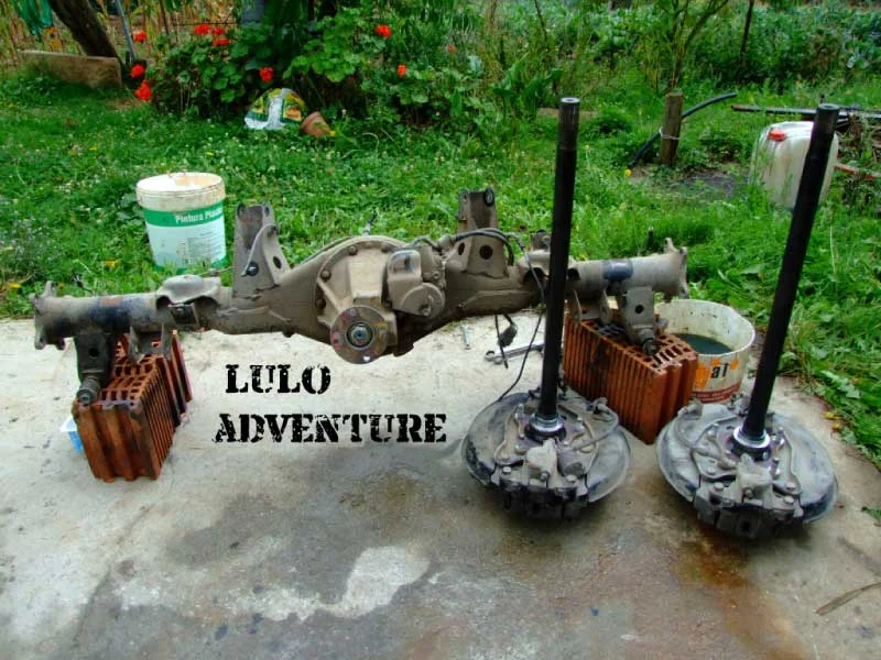

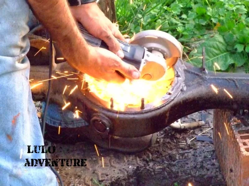

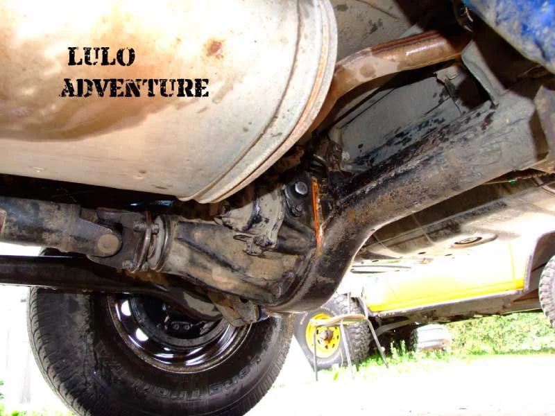

Factory Diff E-Locker ---> (LULO LJ-70) Part 4
The last Pic... :eek:
