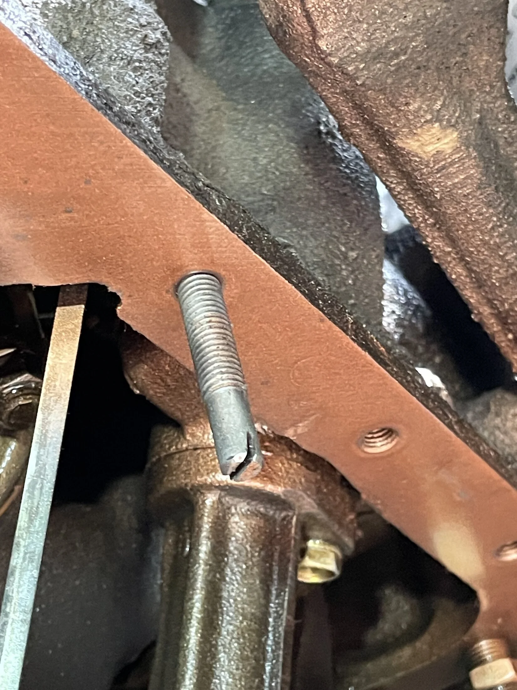

I then use a set of alinement dowels which I made by modifying a set off 8 x 1.25 metric bolts. I cut off the 12mm hex bolt head and then use a small cutoff wheel to cut a slot for a flat blade screwdriver.
I use two dowels on each side of the block, typically on the third bolt hole from the ends.
Then I slide the gasket onto the dowels, followed by the oil pan. Making sure that the half moon shapes at the end of the gasket are seated into the main caps perfectly.

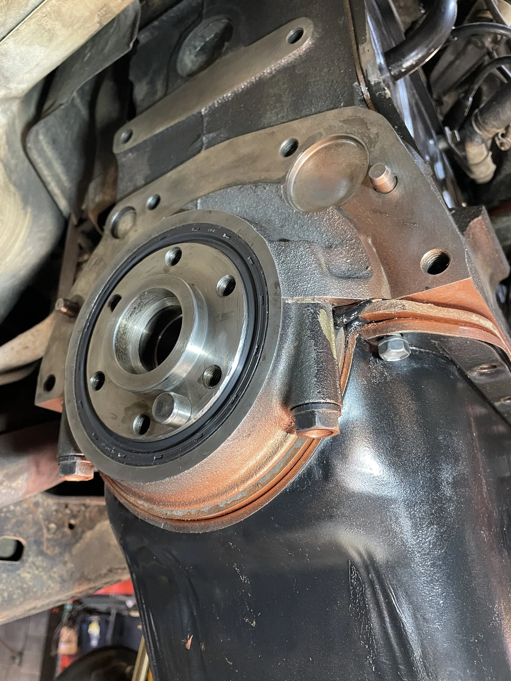

Correct.
We apply the copper spray to the gasket ( multiple coats since they’re super porous/absorbent ) as well as the block and pan. This sealant/adhesive sticks best to itself.

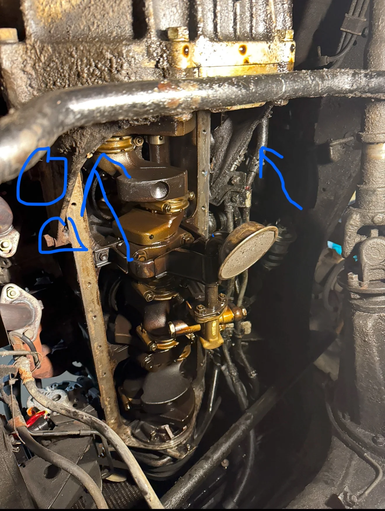

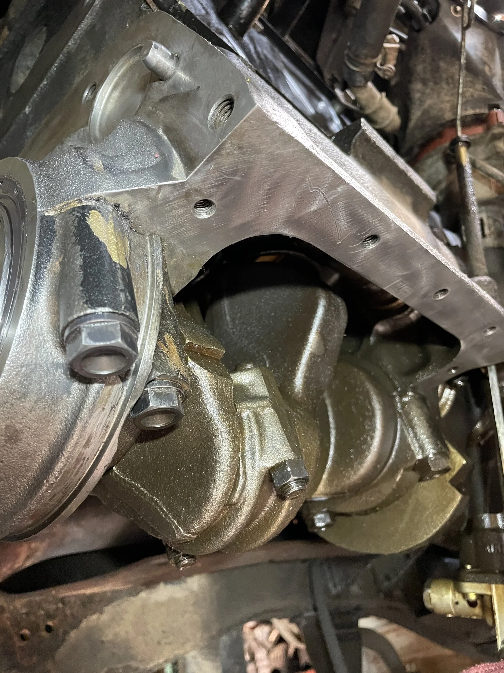

If I’m doing the oil pan gasket without dropping the trans for the rear main, is it okay to temporarily remove those two angled brackets (top of this photo) to make the bottom of the block easier to access for reinstall?
On a diesel that utilizes these reinforcement brackets, yes, they need to be removed.
Georg @ Valley Hybrids
No wonder the pan was so damn hard to get off!

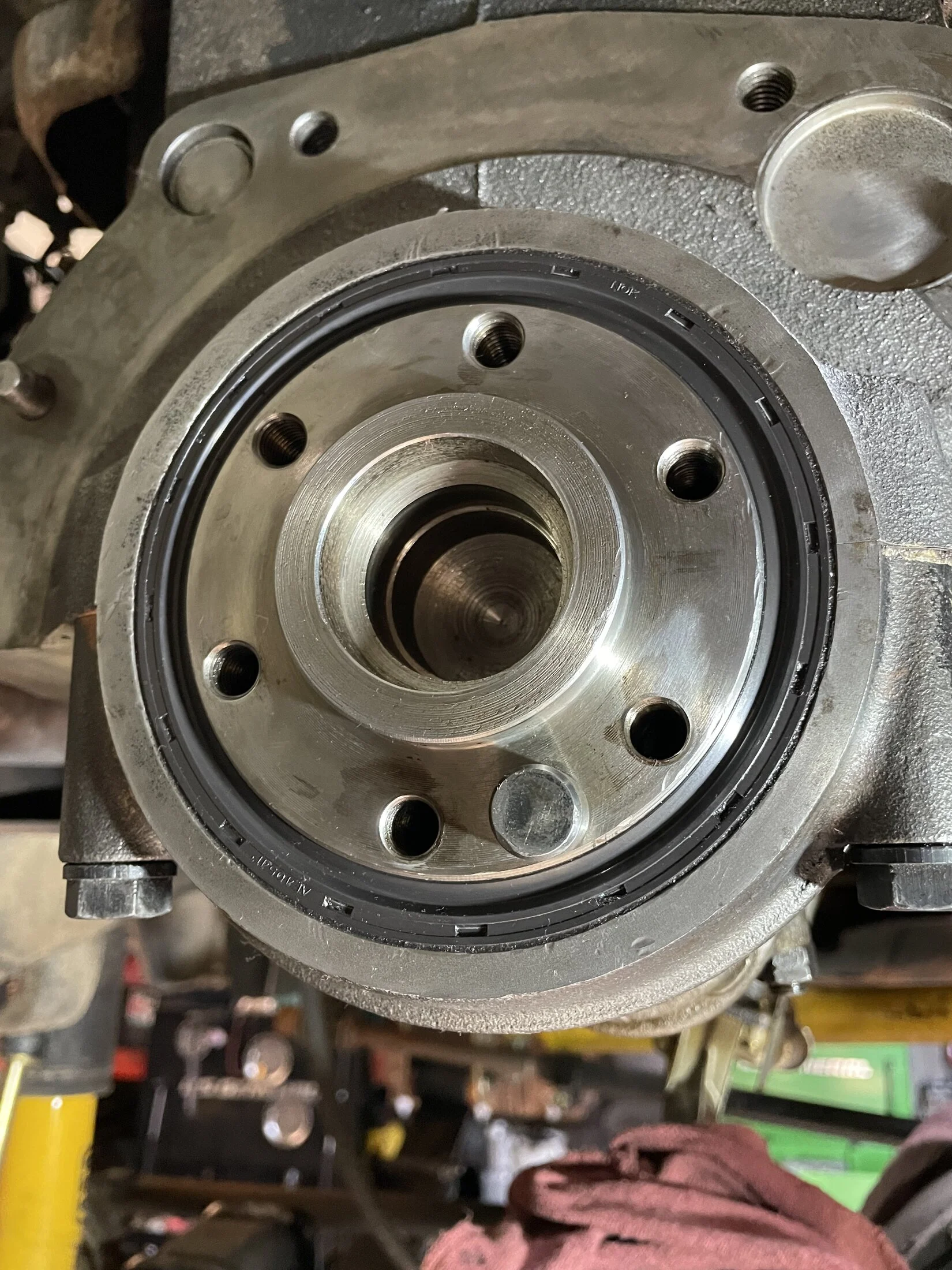

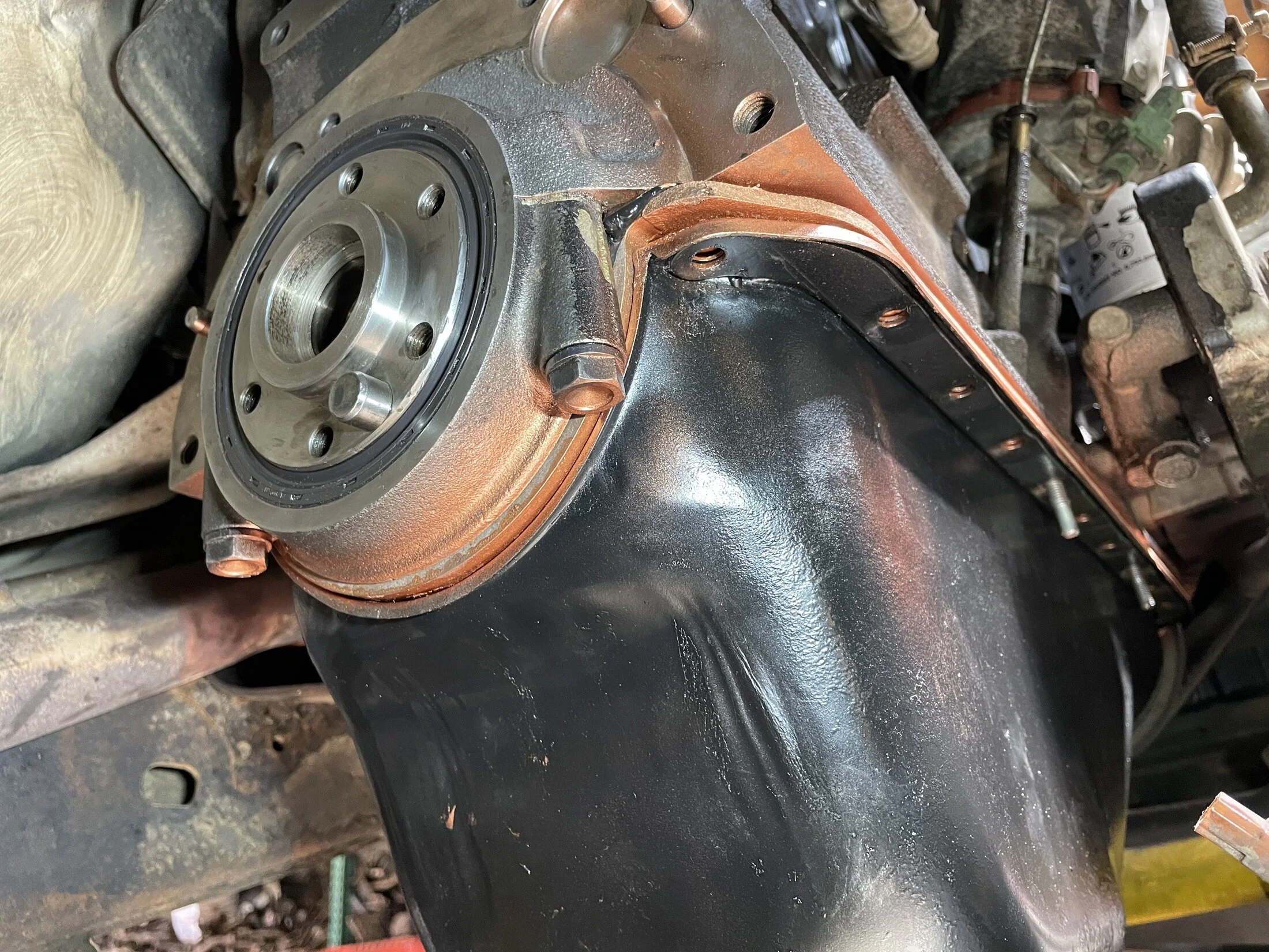

Once you have confirmed that the seal inner lip is installed properly on the crank, push the seal about 90% of the way into the bore. The silicone will help it slide in place as well as the oil on the seal surface.
Then tighten your rear main cap bolts and torque them to 58 foot pounds as per FSM
Lastly, push the seal in until it is even with the block and rear main cap surface. Wipe off any excess silicone and inspect closeley.

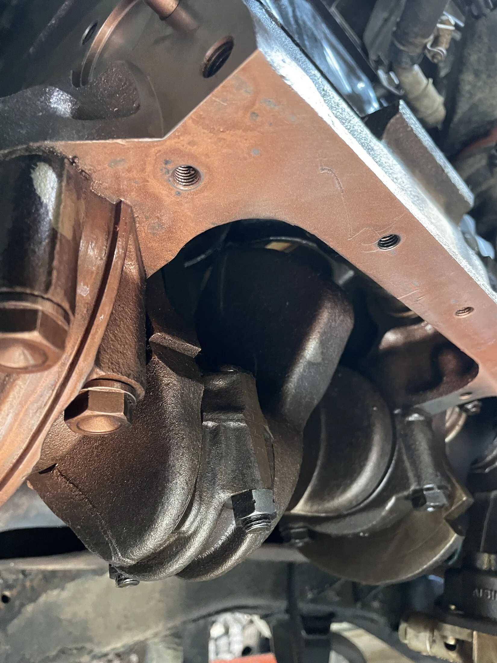

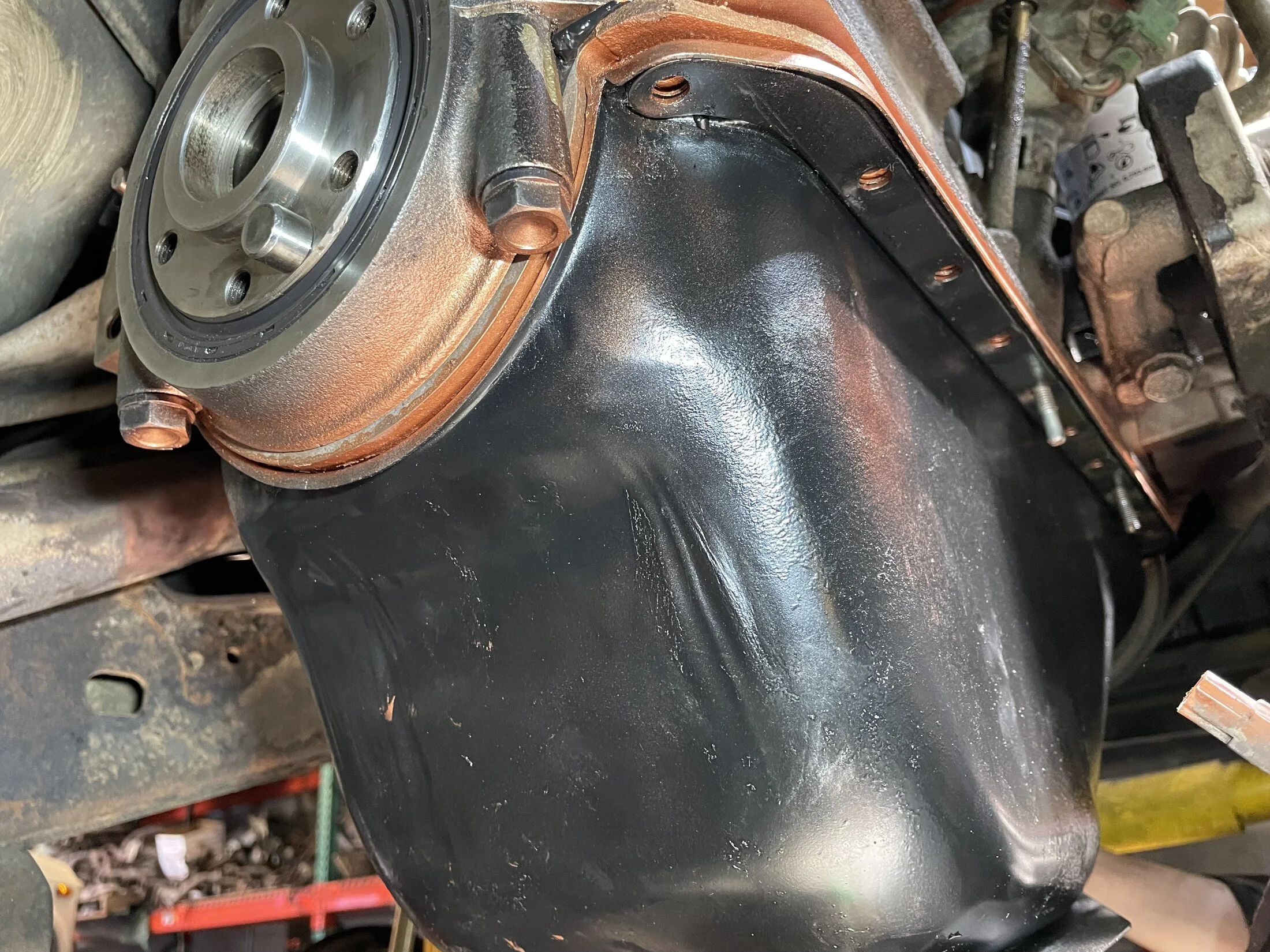

Now it is time to install the engine oil pan gasket. Wipe down the oil pan, gasket surface and the gasket surface on the block one more time. Inspect everything closely, especially the rounded areas at the end of the engine block. Make sure you have removed all gasket material, adhesives, and silicone. This will ensure proper casket fit, and a great seal with no leaks.

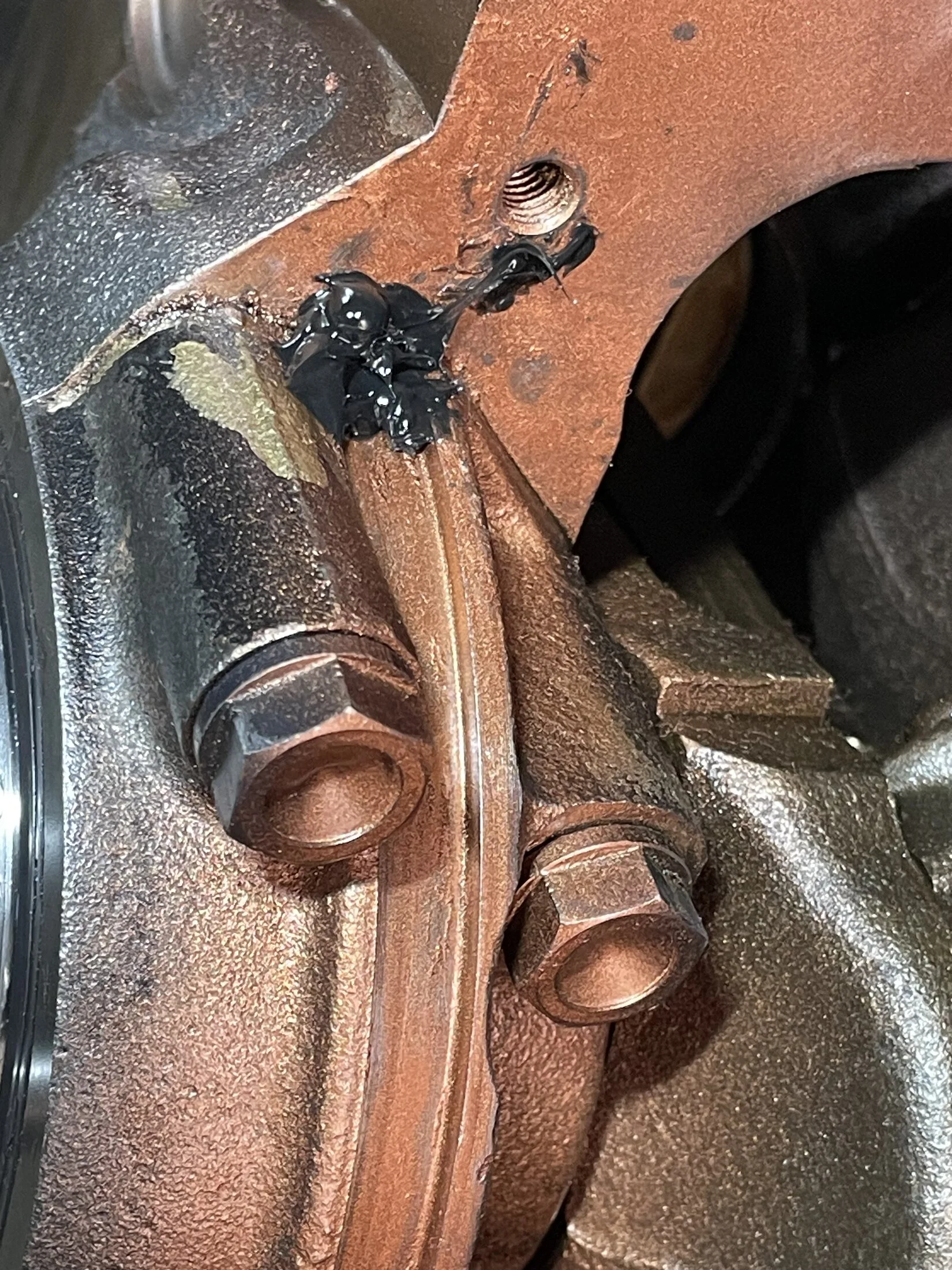

I use Permatex “copper spray gasket” on the block, pan, and liberally on the gasket itself in multiple coats. Then apply a small amount of silicone in the four corners where the flat bottom of the block meets the round main caps.

Georg:
When do you spray the Perma-Tex? Just before you are ready to put the new gasket on and remount the oil pan?
Georg:
Yep. It gets tacky pretty quick. Look at it as insurance.
