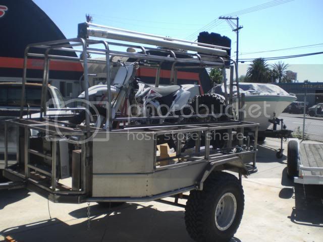

Started skinning the side boxes that make up the kitchen swing out area.

Good point... Even though I'm in San Diego and I may roll into an occasional drizzle. I'm torn between good weatherstripping or good drainage. :D As long as I spread the 150 LBS of calking evenly through the build it should be OK... right?
Very top notch! Watch for not only water, but dust. Nothing worse than a layer of grit on everything.
Thanks for sharing your creation. I enjoy watching it come together.
Thanks for the good advice. It's kinda of fun building something completely different. It diffidently isn't for everyone but it should fill my needs for what I want it for. Im starting to dream about actually using it now... That is a bad sign. LOL
