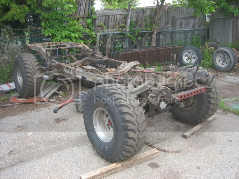

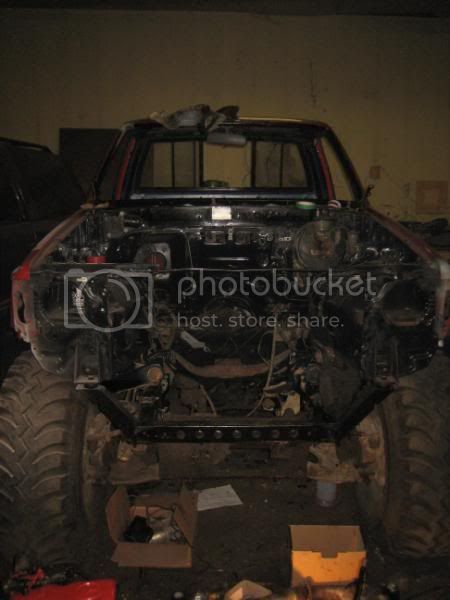

taco chasis and body

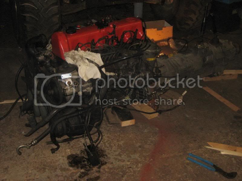

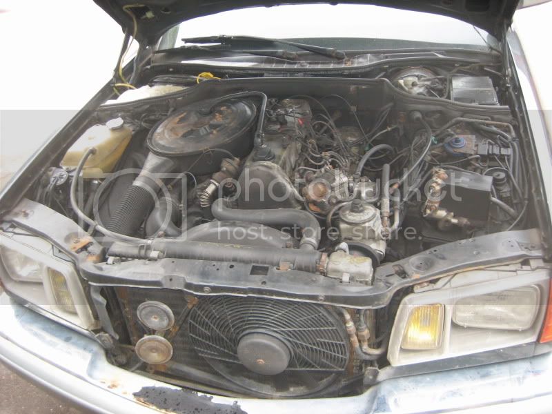

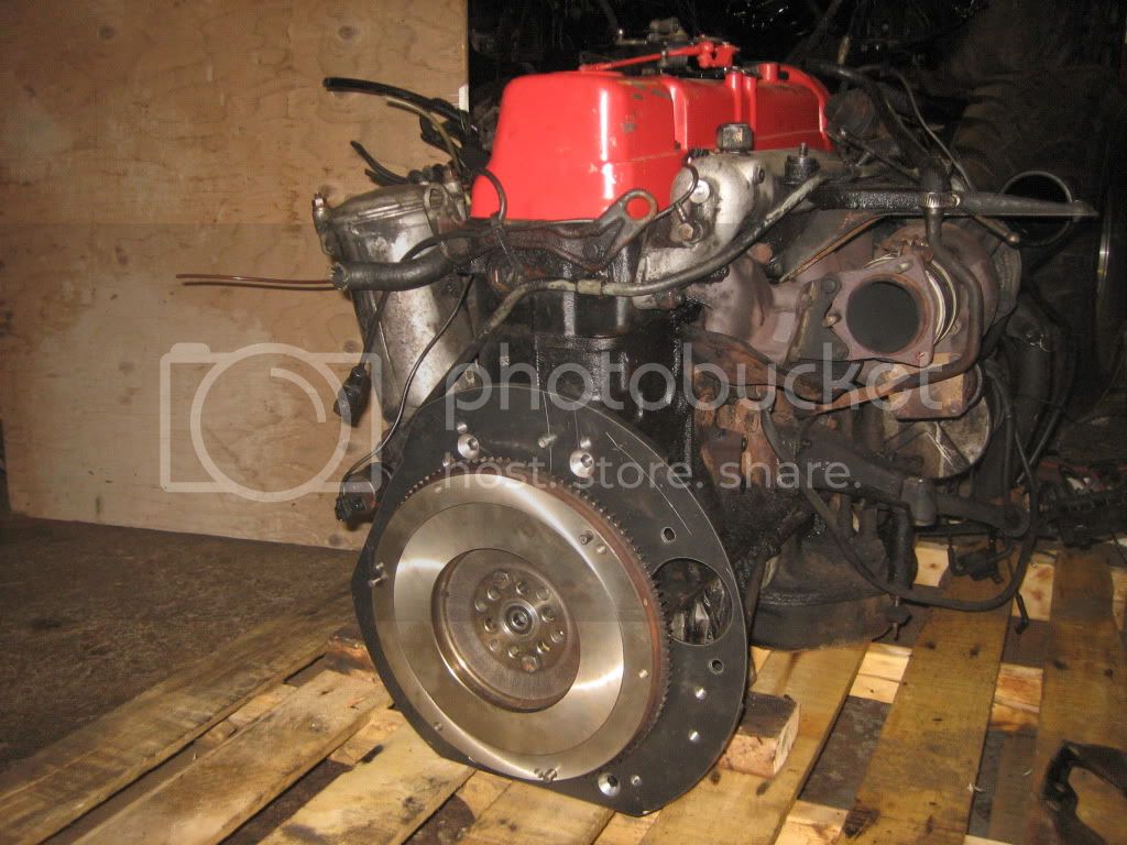

5cyl mercedes turbo diesel
stock tranny

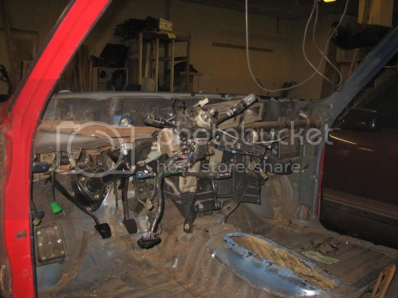

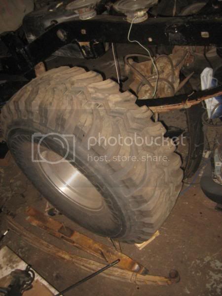

truck sits on raised and moved back body mounts. has 38.5x14.5r15 ground hawgs. a new fuel tank, dismantled interior with a wiring, wait there are no wires!...

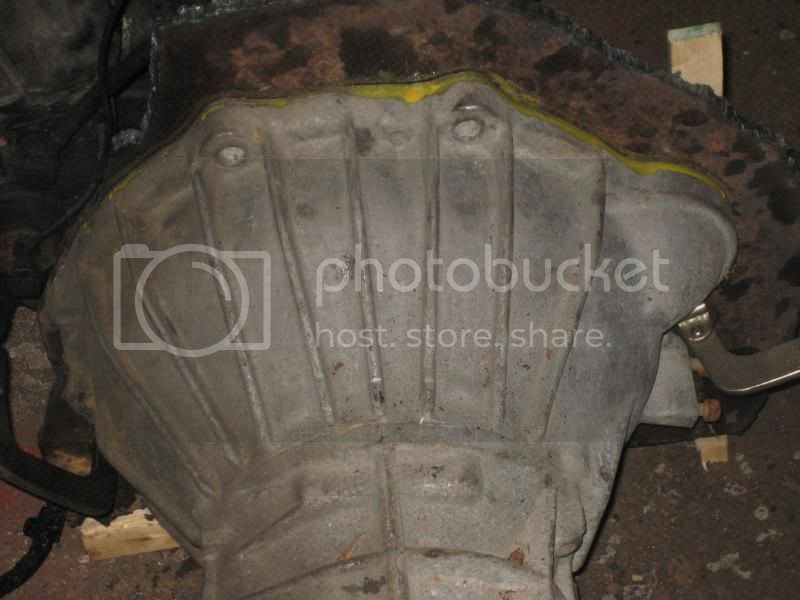

adapter plate for the tranny, which is being fab'd up

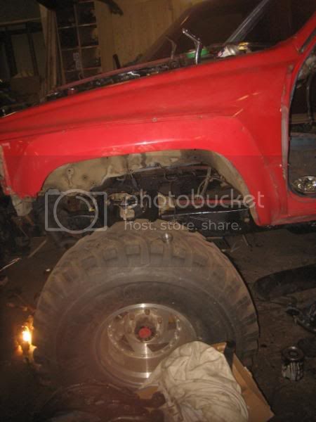

we also know that stock mercedes motor mount cant handle offroading, so a solution is being worked on

chasis
body
donor
where the wires at?
attached body and prep
om617
adapter being designed/fitted

the manual that comes with the mercedes states the timing belt be replaced every 800000kms.
if read only good things about this engine
tristans motor has 600000 and we can find anything wrong with it

template ...lol that is the template
it was made to get everything to line up
then its going to the machine shop
i think tristan said he going to be making a kit out of it adapter plate and mounts to retain the stock toyota mounts so it'll be a bolt in application then you'd have to deal with the wiring yourself

like i said before we are goin to try to make mounts that use the factory locations on the toyota frame but the cab on this truck has been pushed back 2 and a half inch's so were kinda screwed on that ...... it would make the motor end up in the cab on a regular truck ...its just really tight ill get some pics of it tomorrow for you
the owner ->scott has found a 5speed, harness, all interior pieces...
the truck was wired
dash is going back in

it needs an electric fan because the motor fan sits to close to the rad for comfort
