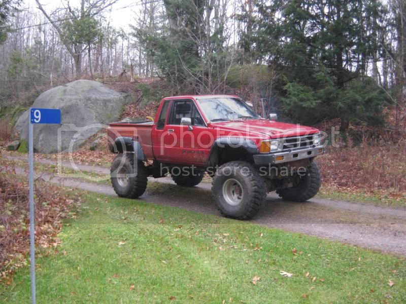

Extracab+mercedes 5cyl turbo diesel to stock 5speed

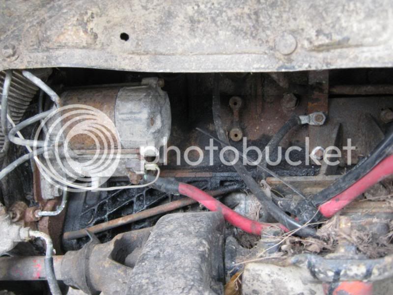

Sorry maybe you've already answered this but I'm trying to figure out how you used the input shaft from the toyota tranny with the flywheel/pilot bearing of the mercedes? also what set up did you use for the clutch and pressure plate? thanks
ok, now I see that, but wouldn't drilling into your toyota flywheel substantially weaken it... Plus you're talking about a huge mercedes starter compared to a 22r starter...even if it does have gear reduction in it, it would still burn out or not have enough crank, right?
the flywheel would get drilled at a machine shop
the starter works a-ok
and i dont think thats a toyota pilot bearing

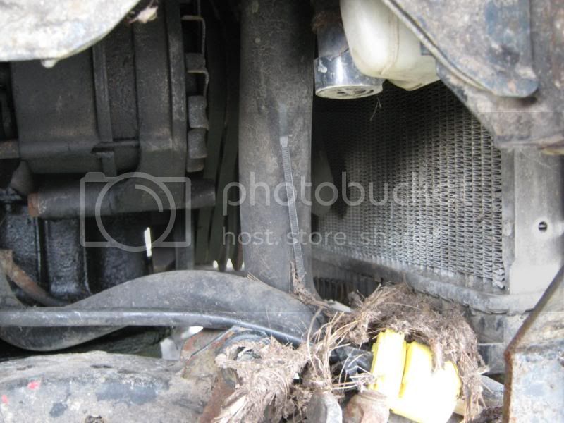

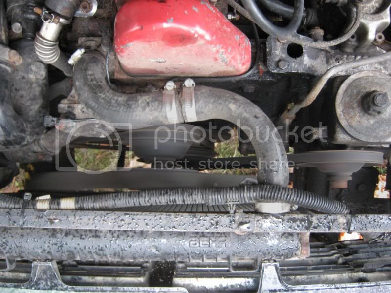

rad clearance

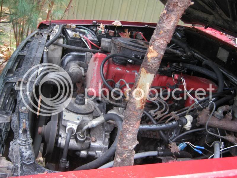

from the pass side

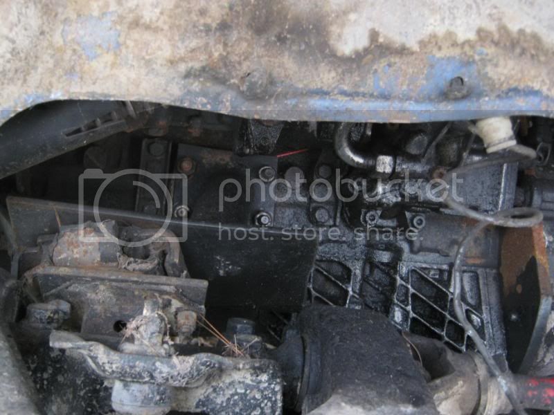

from drivers side

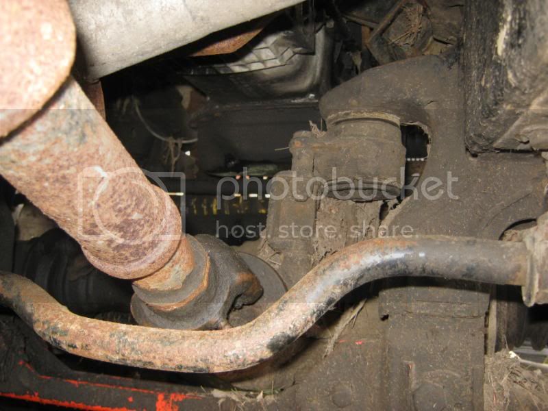

oil pan+front axle

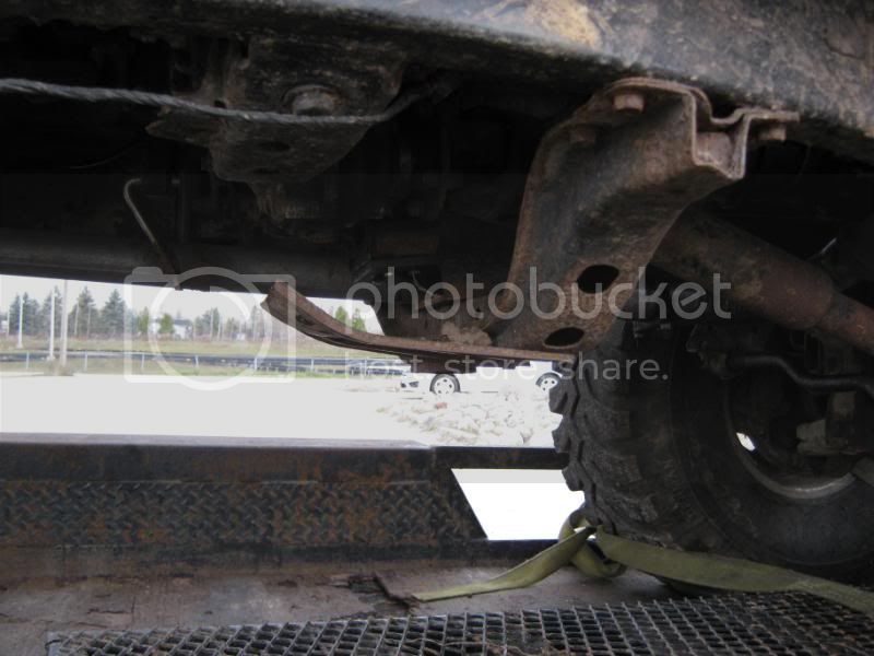

xmember

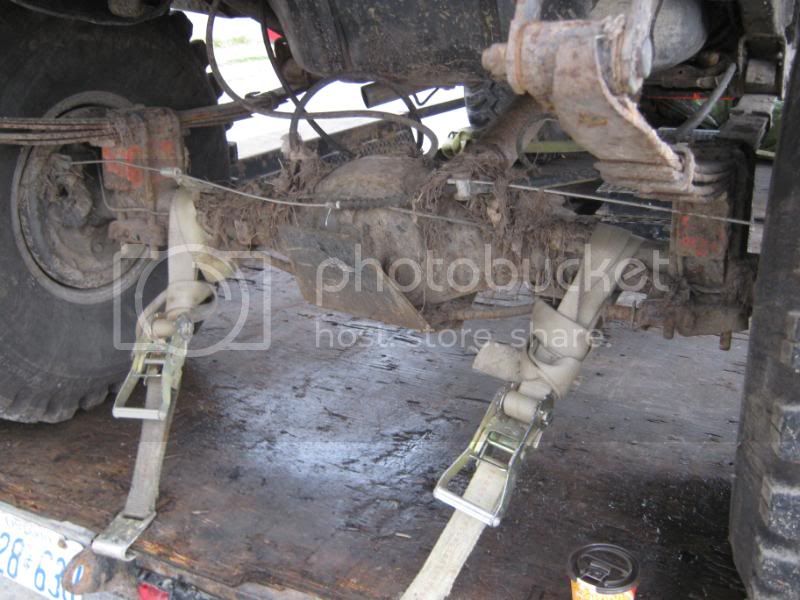

rear axle+armor
