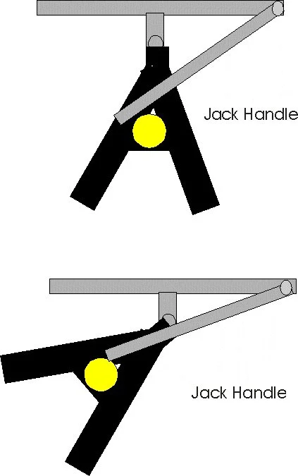

He asks me if I try and open it with the trailer turned instead of straight. Never thought of that. Went out and measured and if I turn sharp to the left so the trailer is angled, the tire carrier at that point has 6 inched less distance to the receiver. So I may only be off an inch now. I can buy a receiver that's 2 inches longer and not have an issue.
That Dan is a smart man:beer:
Turning the other way makes the problem worse

That's perfect. I said above I would get a longer reciever/hitch and then angle the truck for what other room I need.
Thanks for the pic and input
