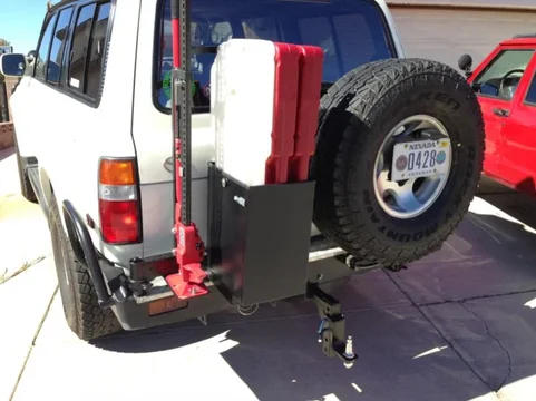

I'm curious too. Almost looks like a Kaymar with Slee quarter panel guards.
It is a Kaymar. The sides and hoops were added by a PO. I like the concept but will be redoing them in the future. I also made the Kolpin water/fuel jug box and high-lift mount. (Thread on MUD). I love the Kaymar for the wide step on top.

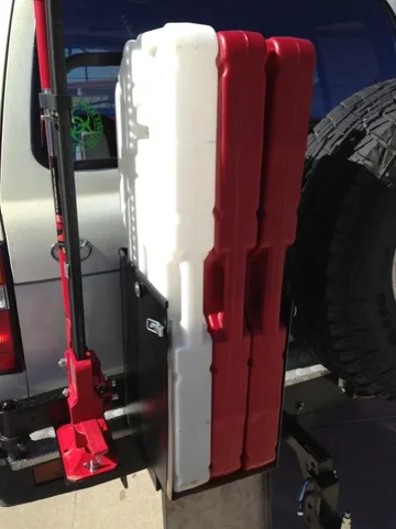

JD, did you fab that water/gas container module yourself or did you buy it from somewhere? That thing is brilliant.

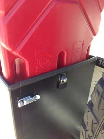

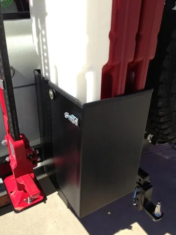

Thanks for the kind words... I built it myself. I wanted something to hold Kolpin jugs specifically. I didn't just want a basket either. With the door I can slide the jugs in and out without having to life them over the top edge. The security rod goes through every jug and helps to keep honest people honest. ;p
The plastic trim moulding at the top keeps everything tight and rattle-free. There is no pressure on the door. The security rod is what keeps the jugs from moving. (The looming tape on the brass lock is to prevent rattles and damage to the paint.)
I don't want to get into trouble here but I could easily make more. :D
Here's the link to my bumper/box build:
https://forum.ih8mud.com/expedition-builds/693488-customized-kaymar-dual-swing-out-rear-bumper.html
