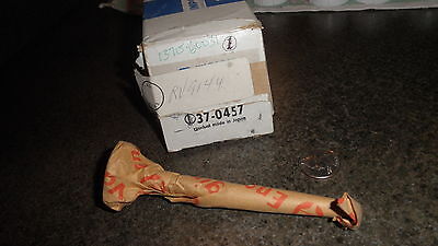

Try Ebay right now:
Try Ebay right now:
Score, thanks!
I also found these on eBay
