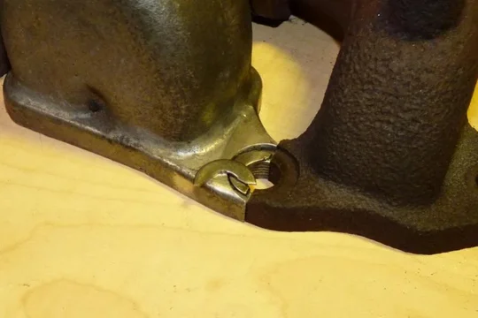

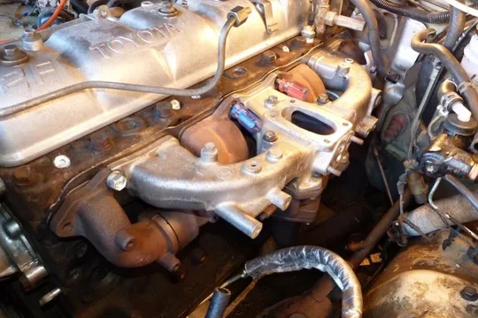

Exhaust Manifold - Flat & Installed
Rover - Thx for the tip... Spitfire did a nice job on the manifolds.
I ended up using one Toyota Gasket, and a couple of half washers as shims for the different height of the bolt faces between the intake and exhaust manifolds...
Then I replaced the studs in the upper center area with two bolts. It made it very easy to re-install. I didn't even remove the down tube, it just sat in clean.
Torque-ing the bolt closest to the firewall is an exercise in patience... I used Loctite blue on all the bolts, so I'm hoping that they will stay put for at least another 50k miles.
Thanks to all for your guidance, suggestions and support.
Doug

Are those shims okay to use? I have a similar situation going right now.
Thanks
I don't have a leak at this time... but who knows how long they will last.
I had to superglue them in place so that when I installed the manifold, they would stay in place.
I'll do it again, the next gasket replacement.
Good luck on your project.
Doug
