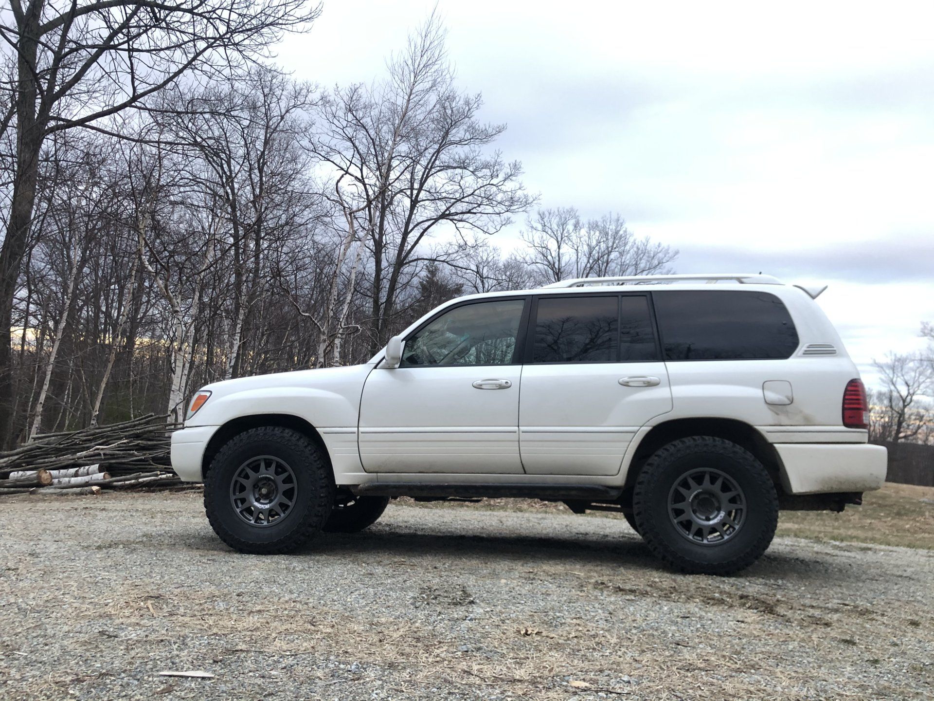

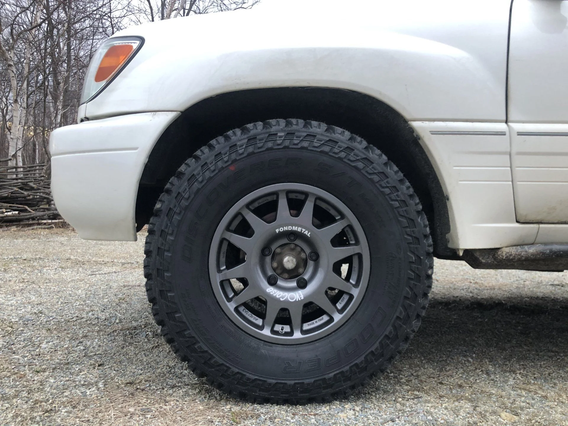

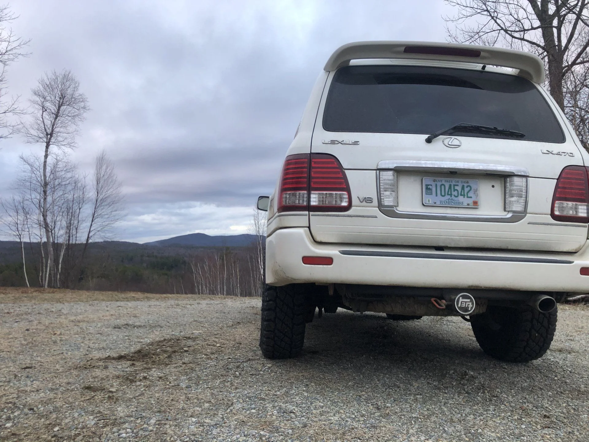

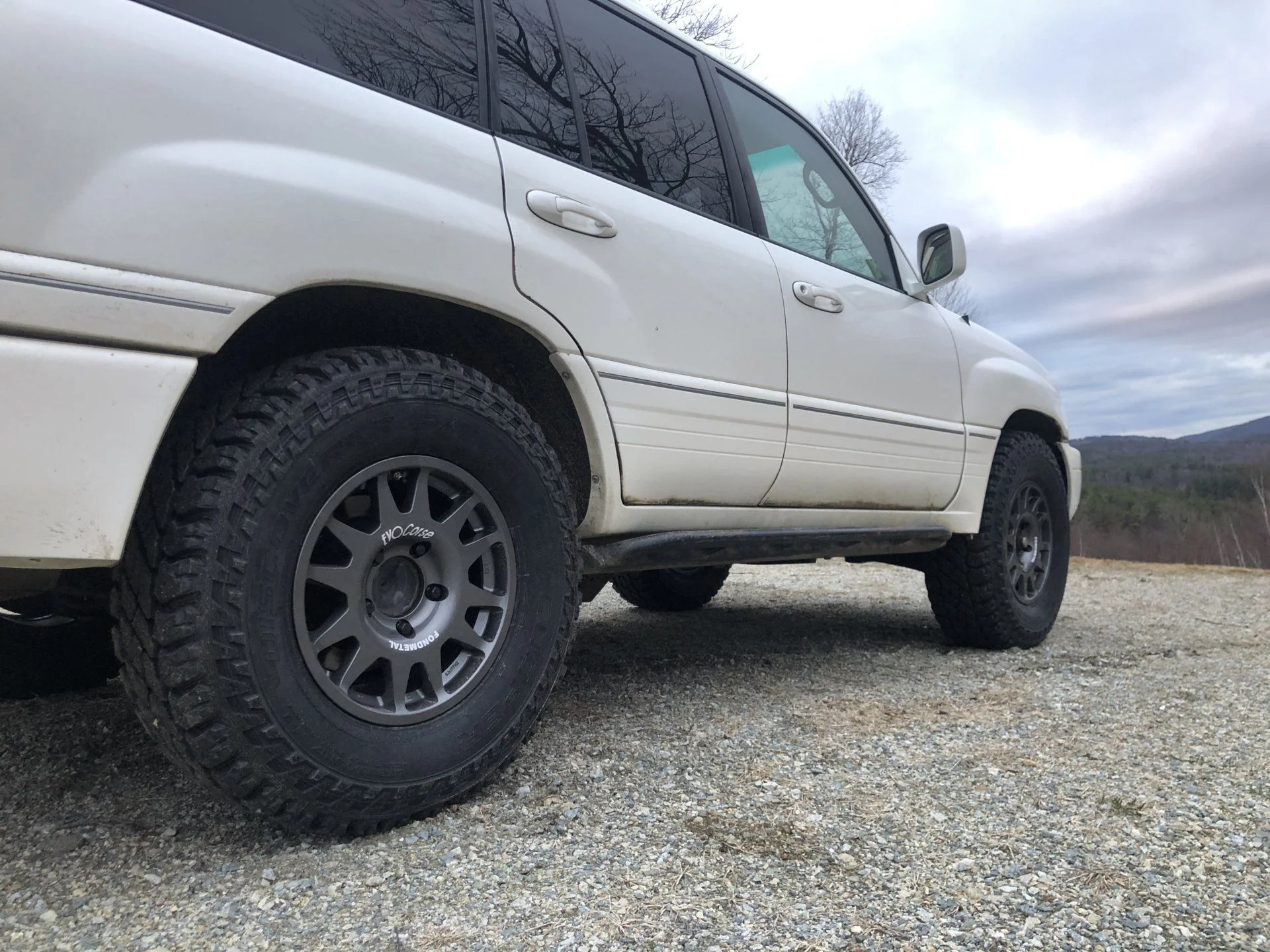

There’s not a ton of these wheels on this site so here’s a few to add:
Evo Corse Dakar Zero 17x8 ET40 in Anthracite.
Cooper ST Maxx 285/75r17
2006 LX470 w/ 3/4” AHC lift
Center hub to fender 20.5” front, 21.25” rear
FWIW, I measured the tires, mounted with the weight of the truck on them, at 33 3/8”, 47psi from the tire shop. Offset puts tire almost exactly flush with the fender, wheel slightly in. I wouldn’t want more.
The wheels just arrived in exactly 10 weeks, as promised. Pretty amazing since they manufacture and ship from Italy.
The tires definitely rub at the pinch weld and maybe on the corners of the stock bumper while turning. I’ll investigate in the next couple days. Also, I have a 5th set but I’m pretty sure it won’t fit underneath, time for a bumper maybe. For now I have a 33” KO2 underneath.

Is that really 20.5 and 21.25 rear? It looks way lower than that, or it must be the the 34" stuffed Coopers that make it an optical illusion. Thats exactly what I have my front set at it looks higher than yours. Also, is that really just 0.75" of lift? What did you measure hub to fender before the 3/4" AHC lift? I might readjust because I thought 20.5/21.25 was 1.5 inches of lift (F) and 1.25 (R).

These photos are with AHC in N but truck is parked on a bit of slope so maybe that affects the way they fill the wheel well in the photo. Stock AHC height should be 19.75 front, 20.5 rear hub to fender, which mine was roughly at to begin. I maxed out the adjustment in my sensors (slots and threaded rods) to get where I am now. It was just enough to bring my pressures back up to spec after adding King Springs (mostly stock truck). I may drop it back down as I add weight, I’ll see how it goes.

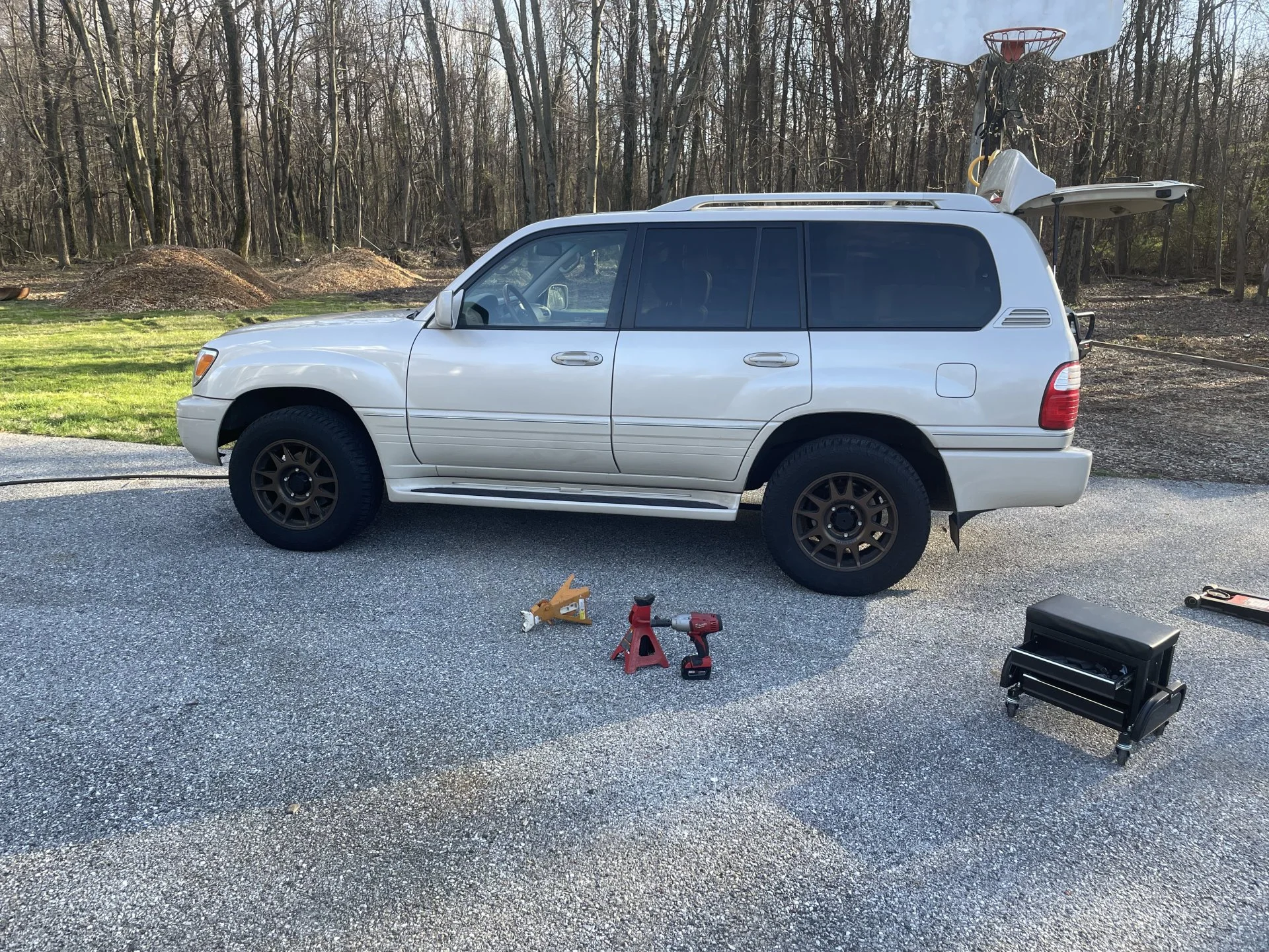

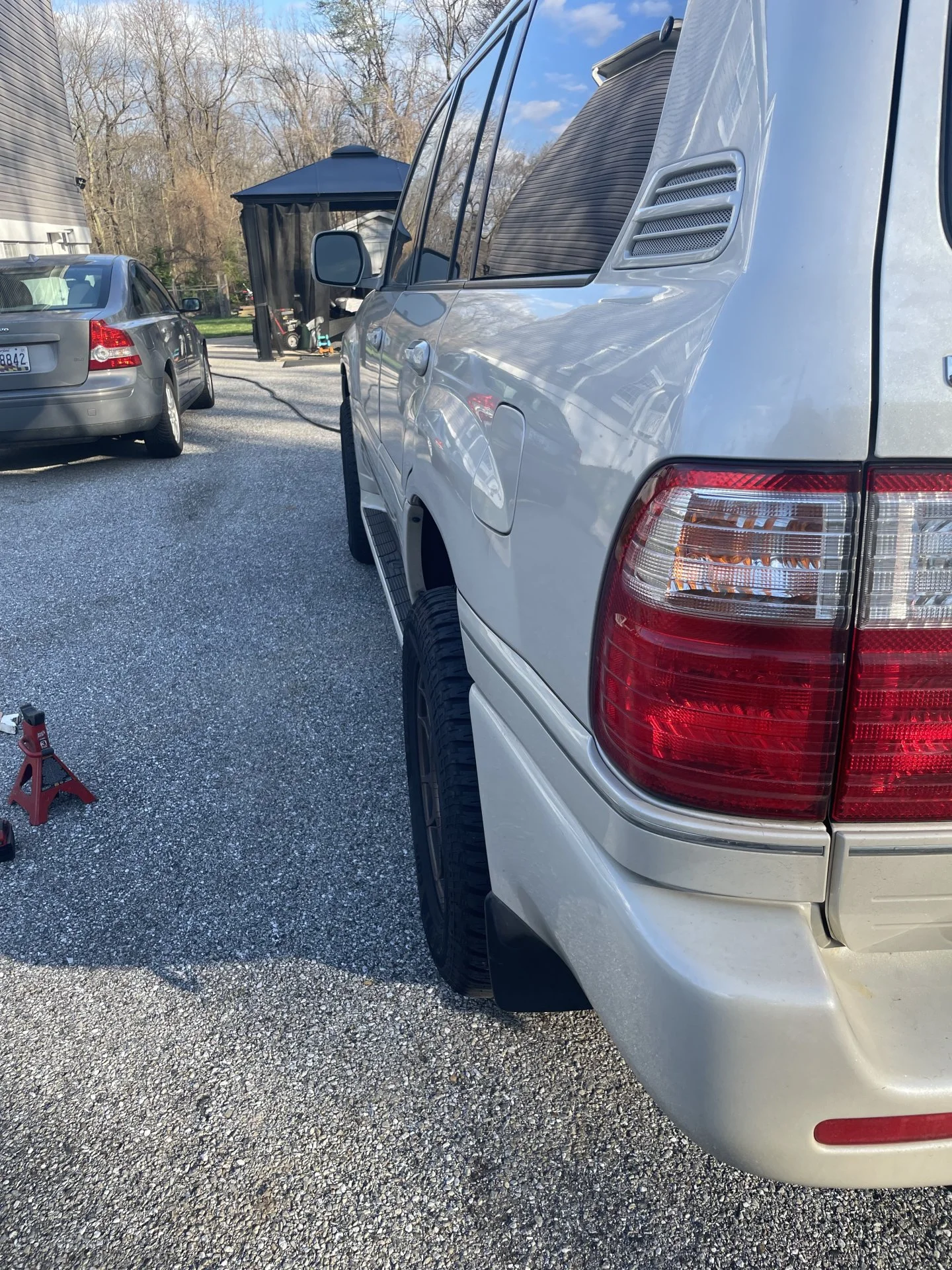

So it turns out you CAN fit center caps to Dakarzeros on your 100 series. It just takes 1.25 inch spacers.
Forgive the temporary chrome lugs, my long ones looked goofy after spacer install for some reason
