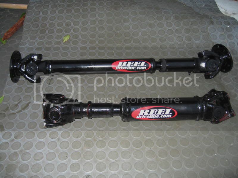

Well, we got Sully out of the garage today under its own power. There are still a few things to finish, but the hard part is over. My next task is the drive shaft, I have a mini truck CV front DS I will be using for the rear shaft for the cruiser. Since I rotated the pinion to be in-line with the T-case out-put flange, my question is what are you guys doing to make it work with the LC course spline flanges? Any help or suggestions is greatly appreciated. A few pics.........

Thanks Eric,
I bought a course spline pinion flange from Kurt (Cruiser Outfitters), that I will be able to drill the mini truck pattern into. The drive shaft is going to the shop tomorrow to get lengthened. I am using the rear DS I had made for my car. I finished making brake lines today and bled the system, it will stop now without having to use the E-brake. PS pump will go in tomorrow and new hoses made. Shocks will be the last thing to do, almost there.
