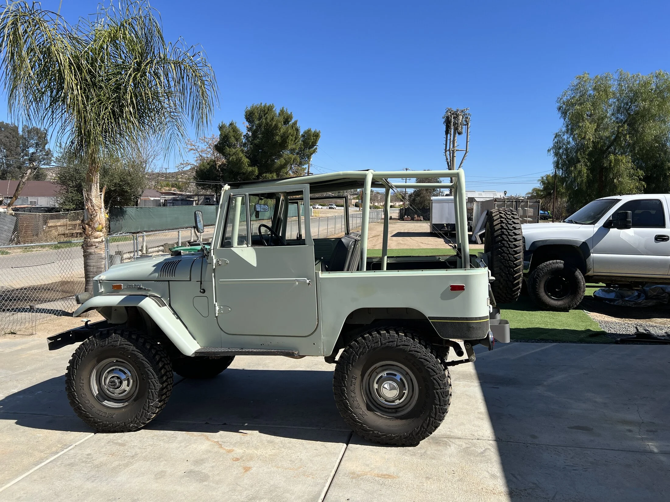

Did you go with the mud hog?
Yes. I havent used them extensively as others on the board, but IMO, for the money they cannot be beat. They look great on an SOA 40 with stock steelies. You can also get a “warranty” with them if you buy through simple tire, though i have not had to use it.

I bought the 40 SOA. As far as i know, stock springs, shackle up front as original with 2.75” CTC shackles, extended shackles in rear 4.25” CTC. No power steering, it steers great when moving with factory large diameter wheel. PS would be nice for parking lot maneuvering…..its a pavement princess.

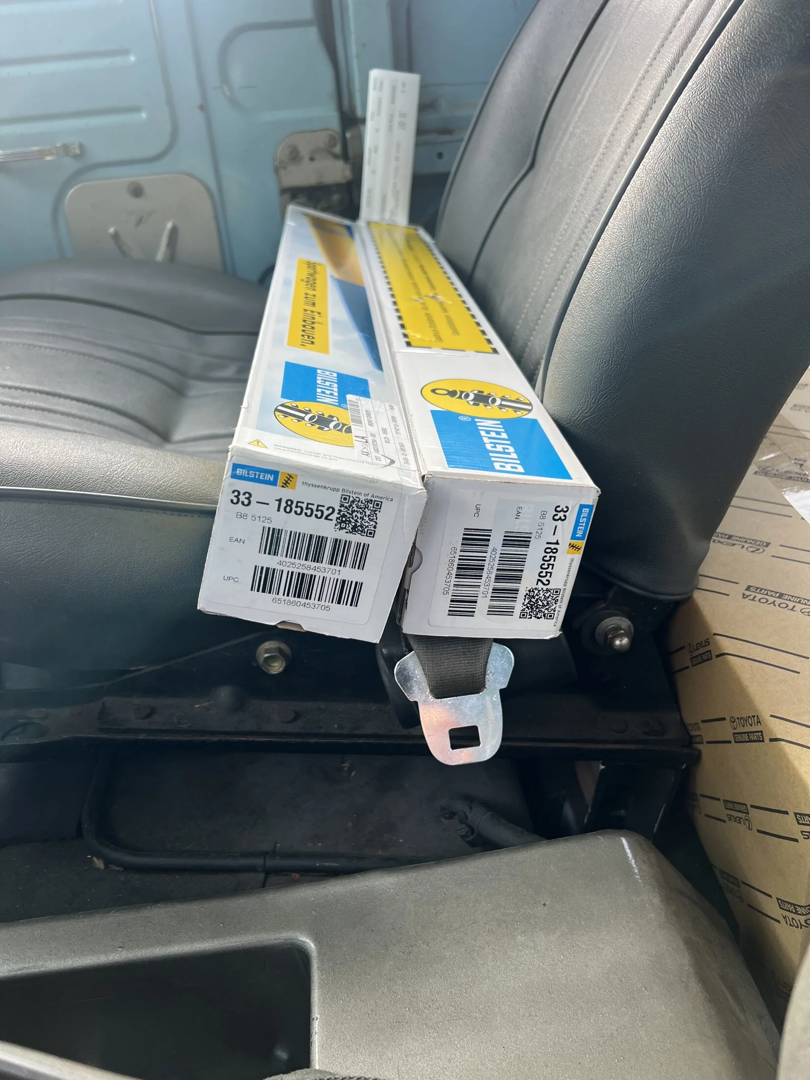

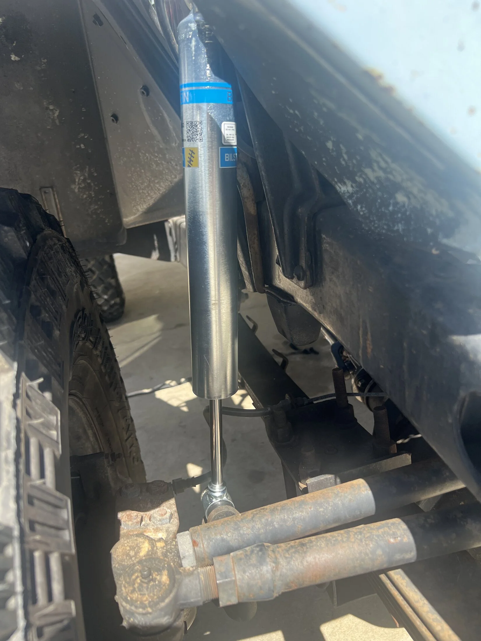

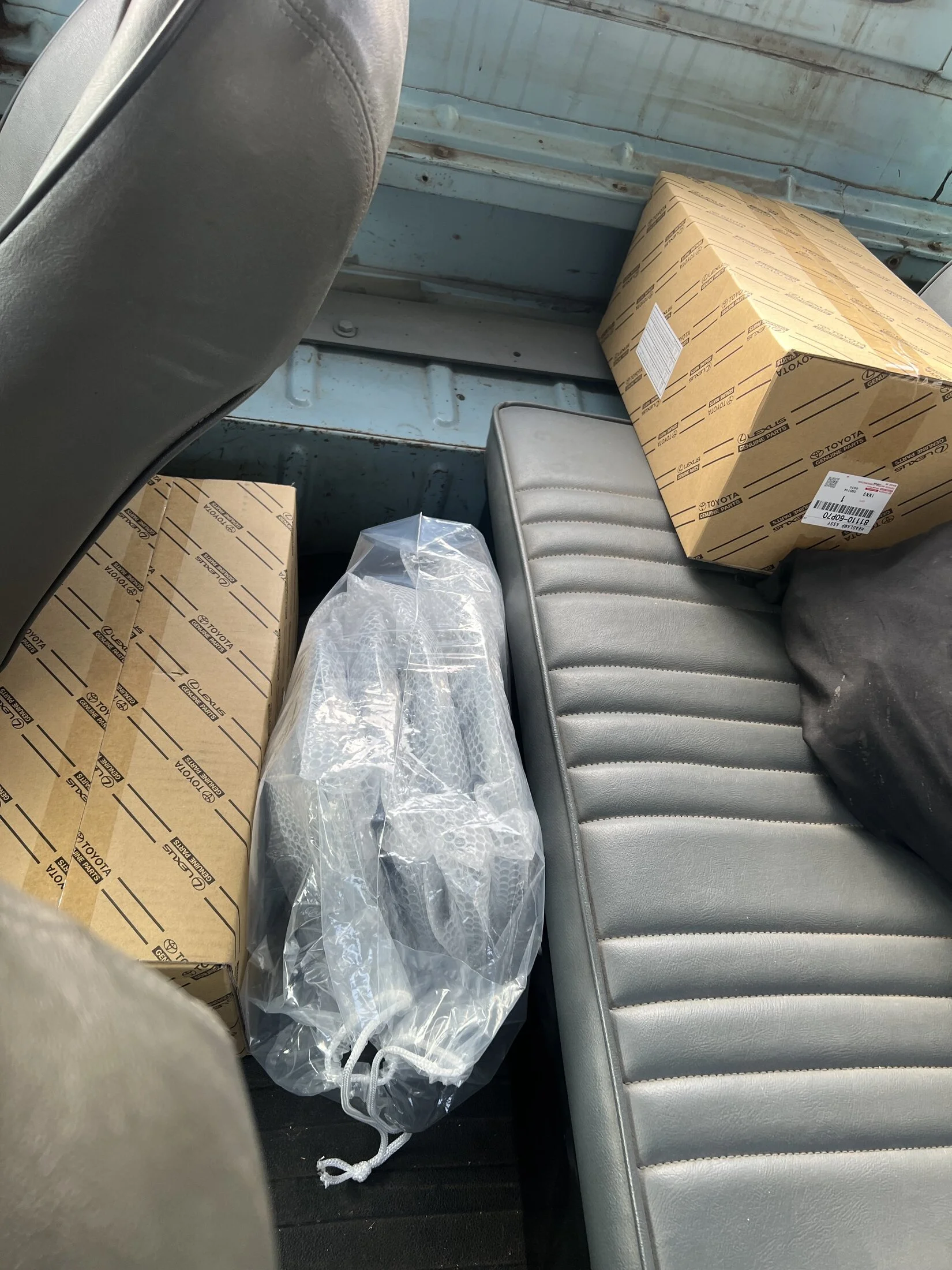

A few more parts have come in, Bilstein shocks, brand new factory hubcaps, halogen headlights and harnesses. Waiting for the weather to cooperate so I can install them and be ready for the next club run.
Since it was a really nice day I got after it early this morning. Did not start so good, the rear shocks I bought turned out to be front shocks! Yep, I mixed up the front and rear shock part numbers 🤦🏻‍♂️ Another trip to get the rear shocks tomorrow.

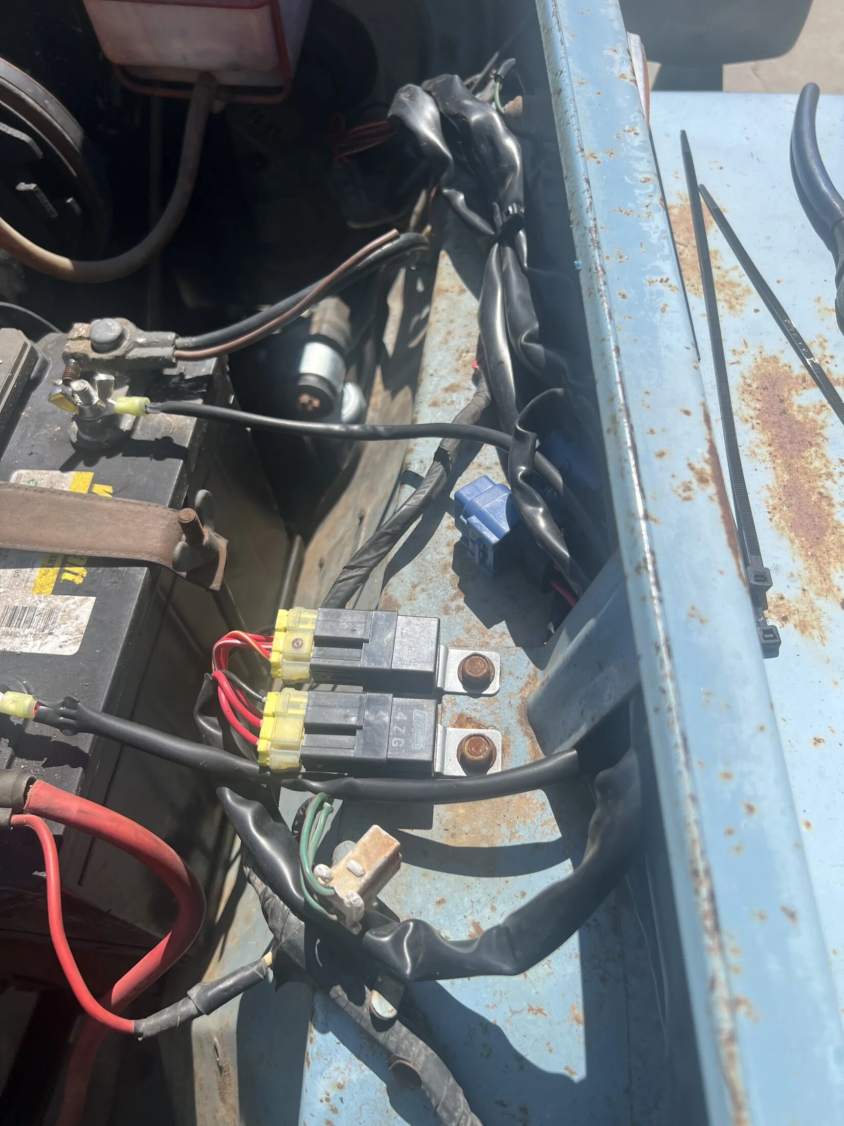

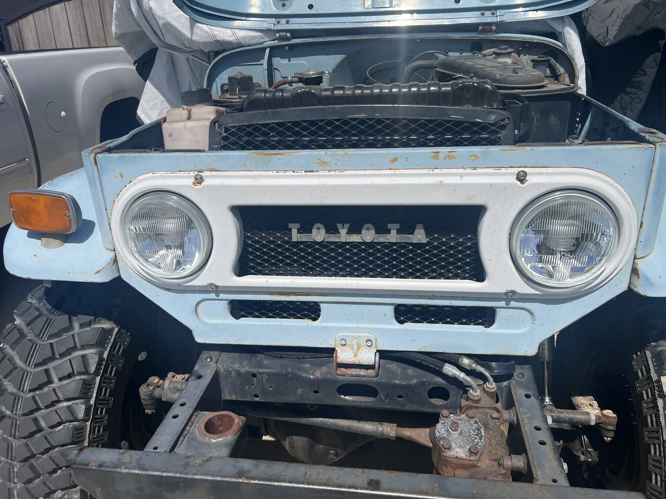

Replaced the stock headlights and installed the Toyota halogen headlights. Very nice kit, halogen semi sealed bulbs, wiring harness, relays and fuses. I did have to replace the terminal ends that hook up to the battery. The battery studs were bigger than the eyelets on the harness. Simple fix, cut, strip, crimp and attach. They work great from I can tell in the sunshine, I will test them tonight.

Number 3 son put on the new wheels/tires/hubcaps trio for me.
He said he wanted to help me out, but truth be told, he was tired of having to work around the stack of tires in the garage 😂
Very happy with the outcome, Sully looks fantastic and is ready to wheel!!!

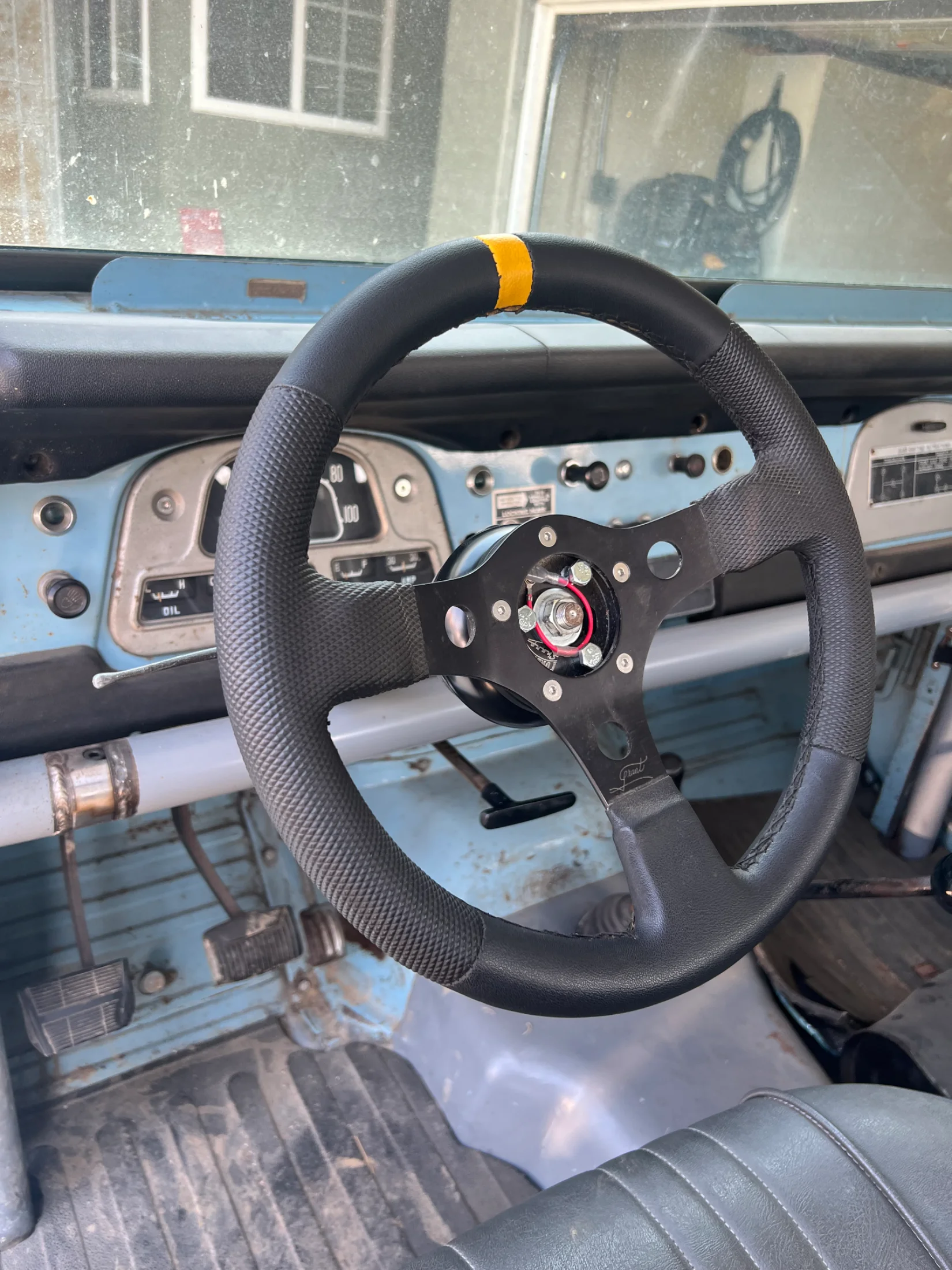

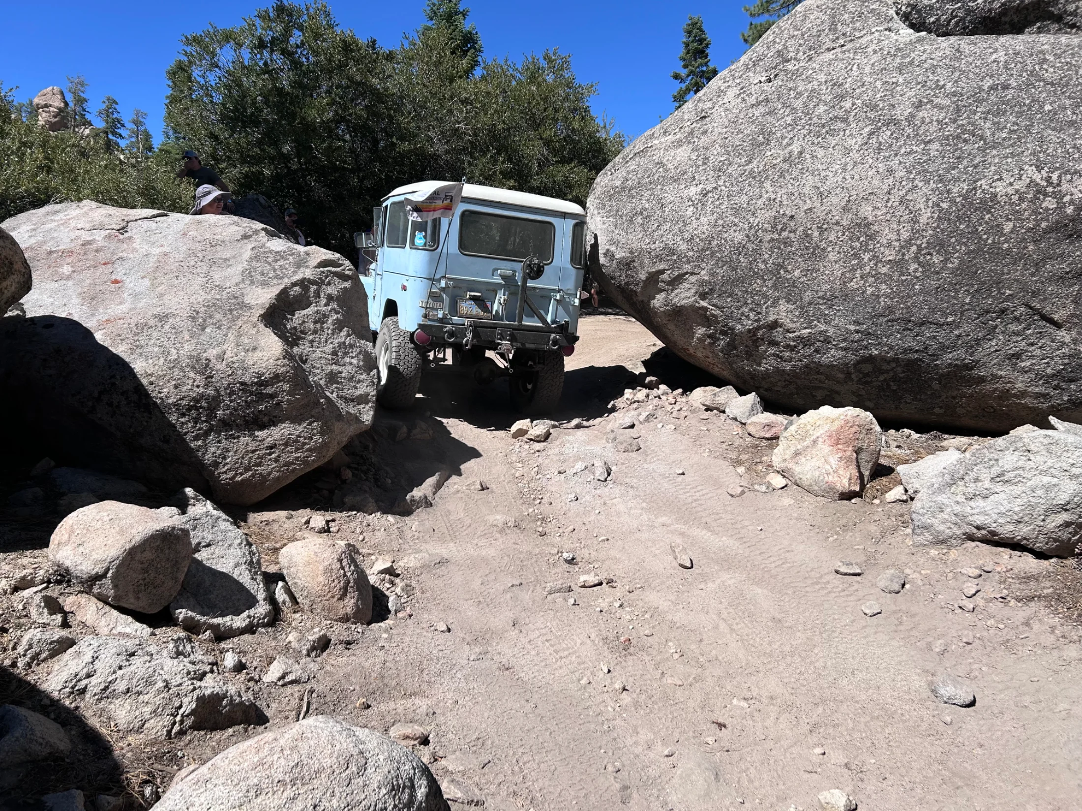

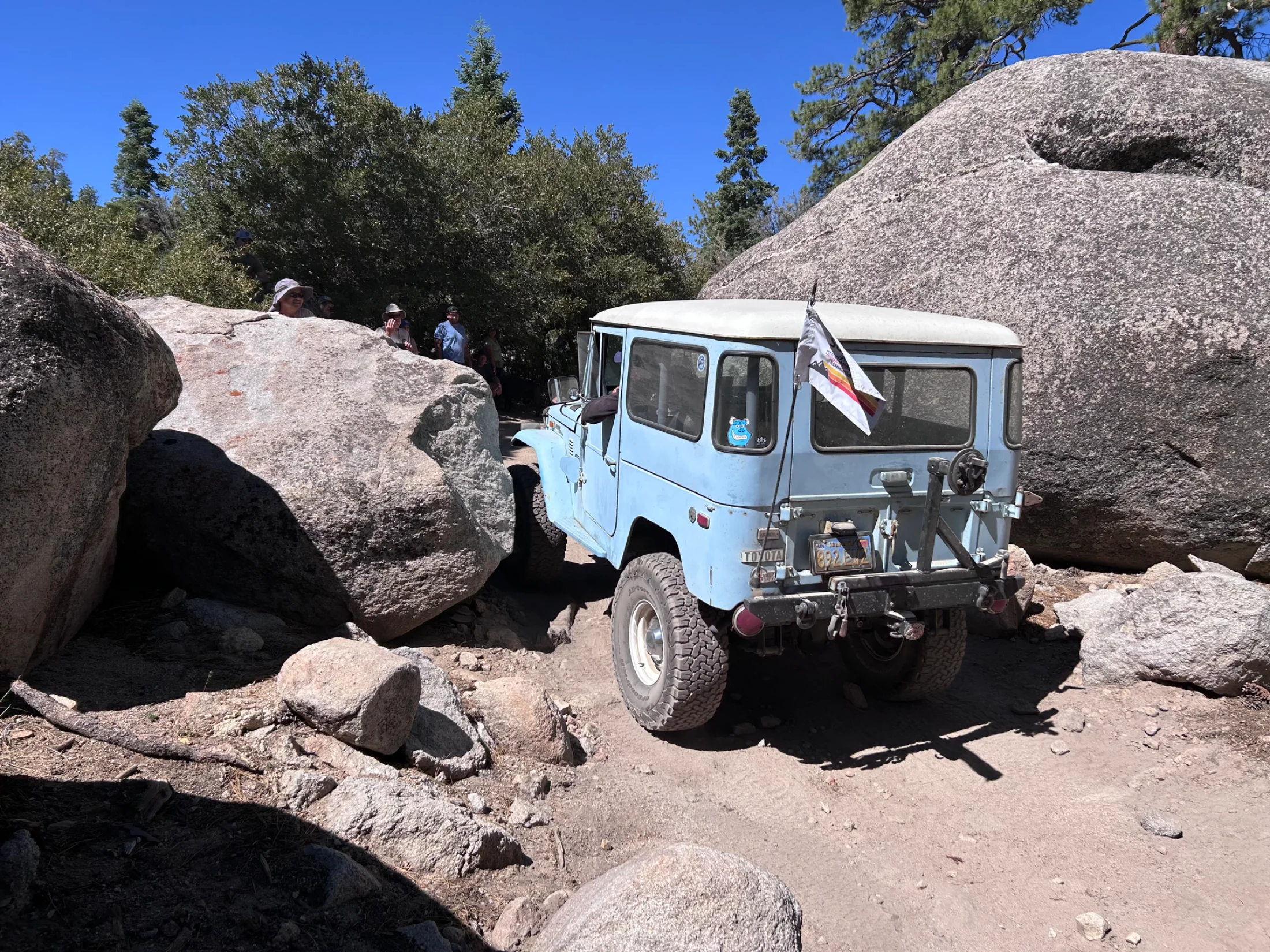

Went to Big Bear on a club outing, weekend before last, I have not wheeled up there in 17 years. The trails have changed quite a bit and it was nice to be out of the city and in the trees. The 40 performed great, but that big ass factory boat wheel sucks! That being said, out with the old and in with the new.

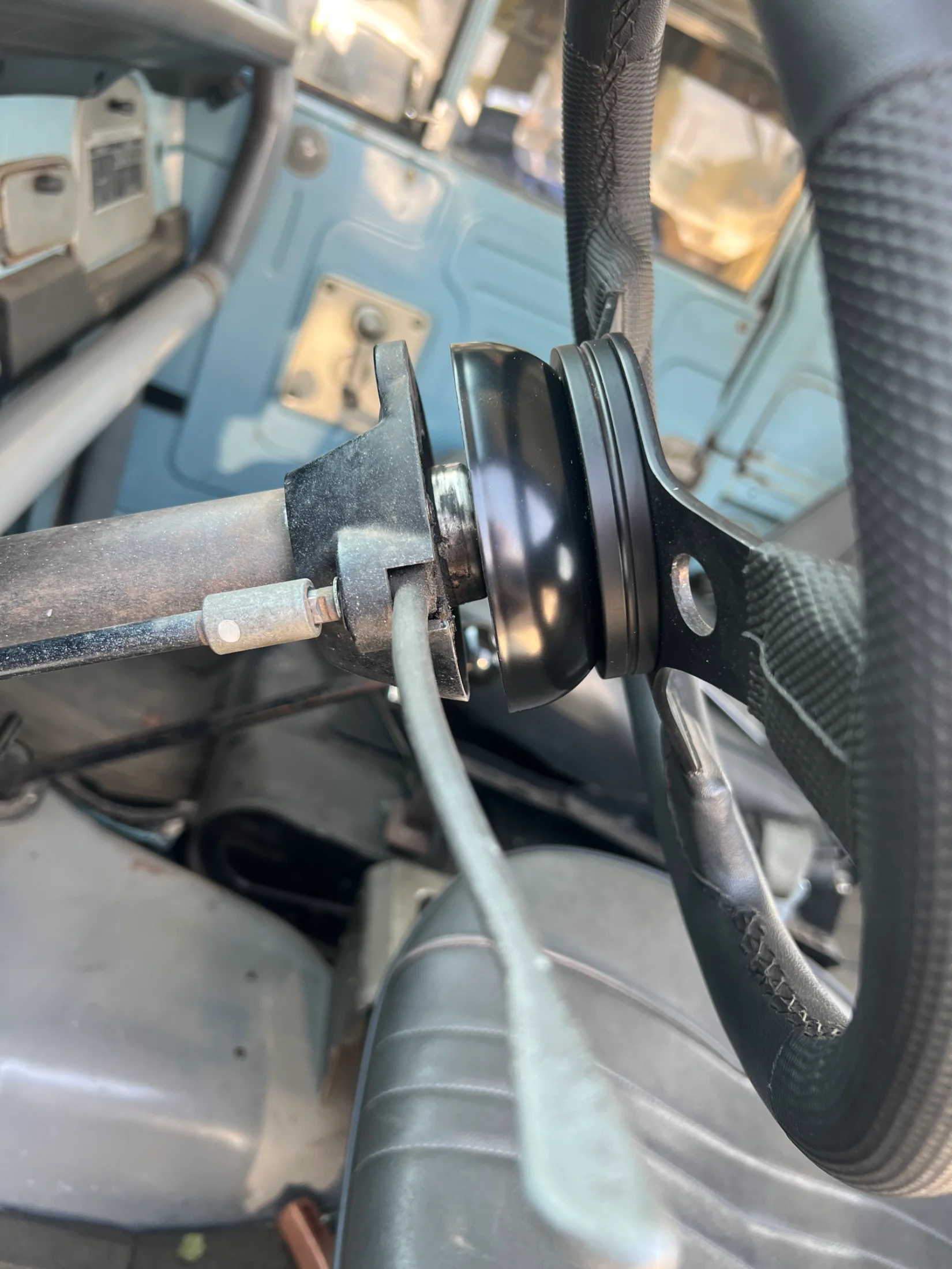

I robbed my project of the steering wheel and installed it on Sully. Picking up a tilt column later today for Sully.

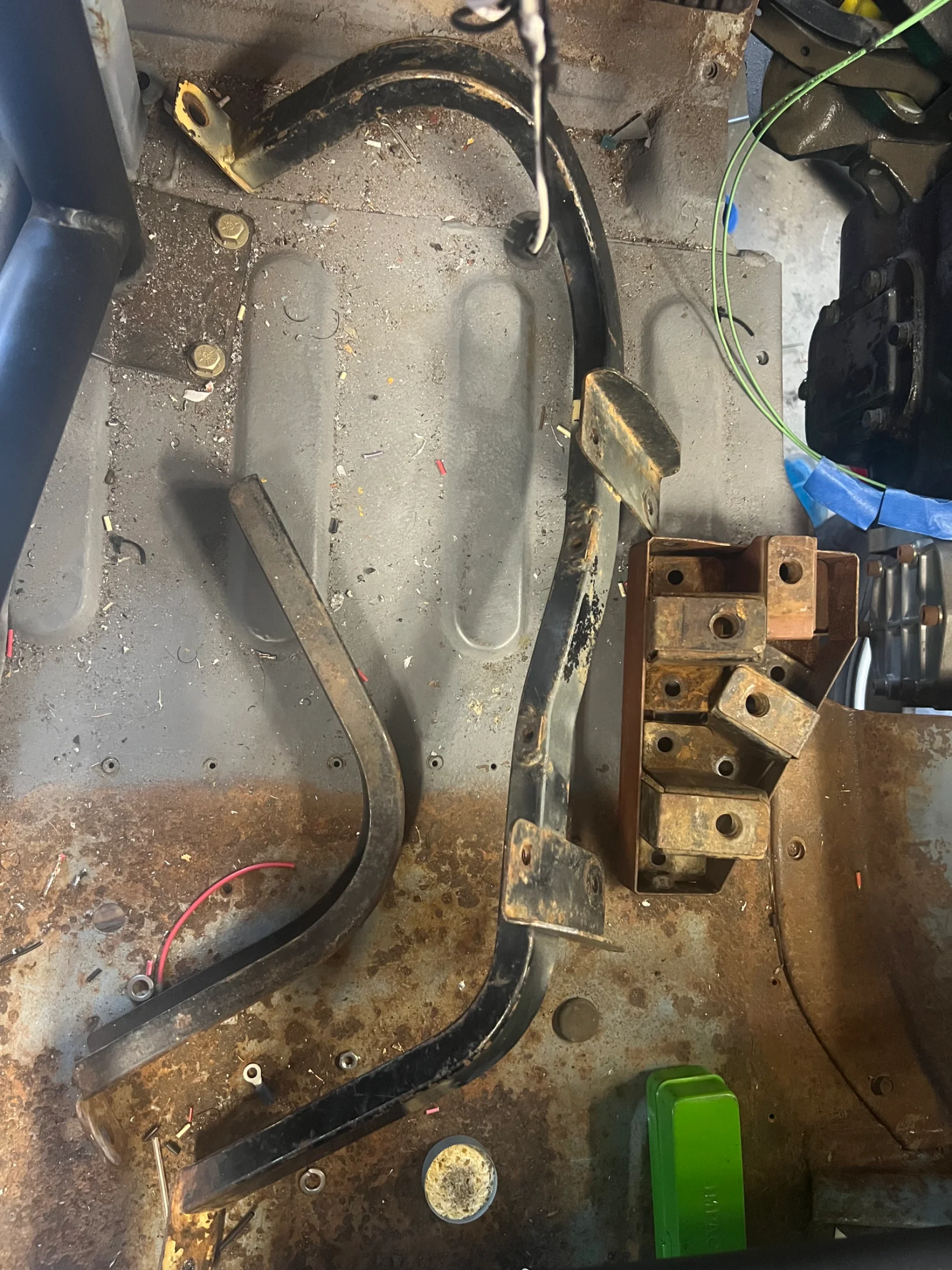

Tim had made seat mounts to relocate them farther back and reclined. I can’t drive with the seats leaned so far back and the wife can not reach the pedals at all!
I’ve had the original seats mounts tucked away in the garage, they are being sent to get blasted and powder coated.

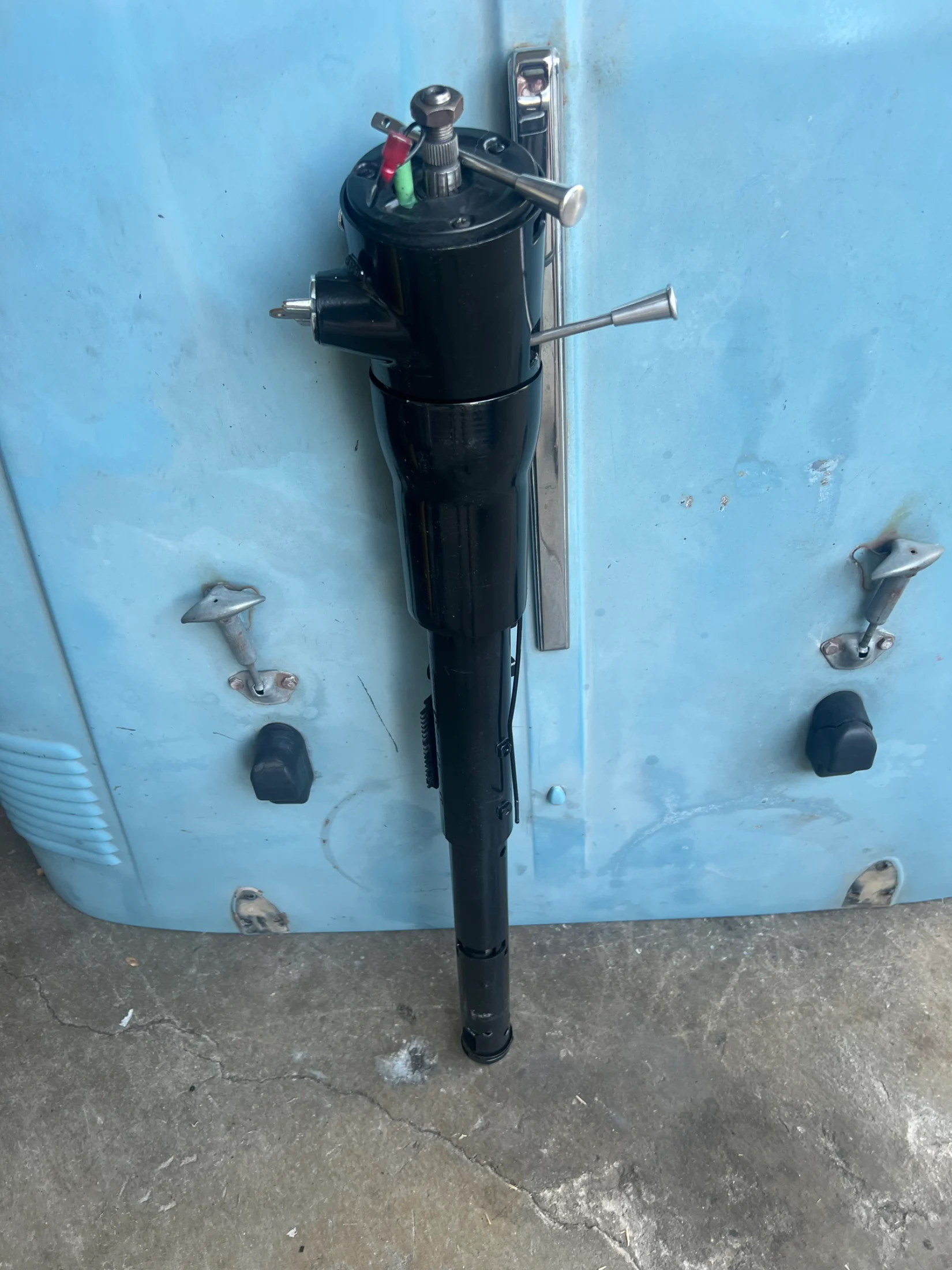

Look forward to having the seats back to the factory location and the convenience and adjustability of the tilt column!!

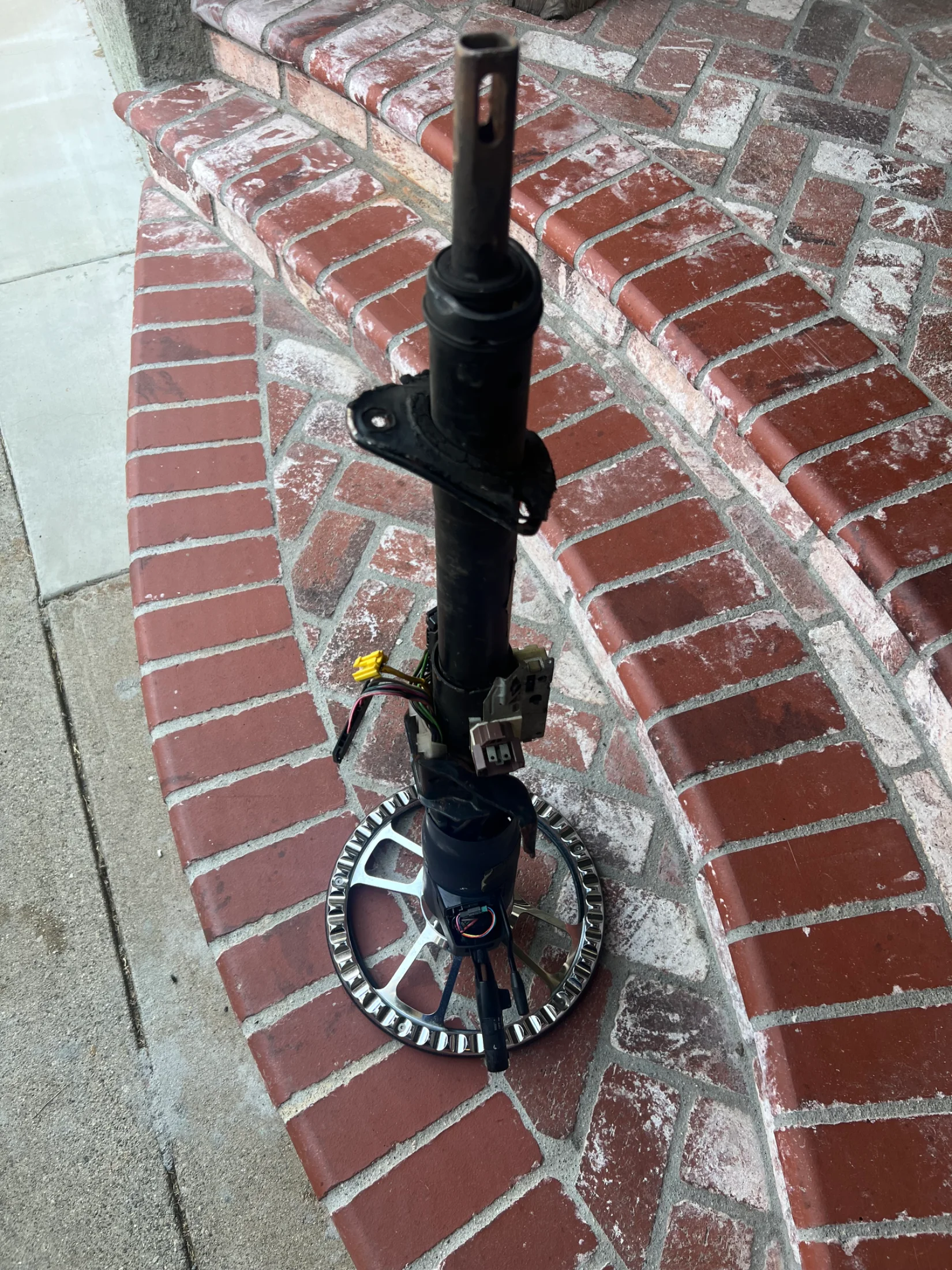

Picked up the new (to me) tilt column last night. More parts to source and prep work to do before I can install it. I have this donor column to scavenge the pieces that are missing from the new column. Not using the sweet hot rod billet wheel though 😂
