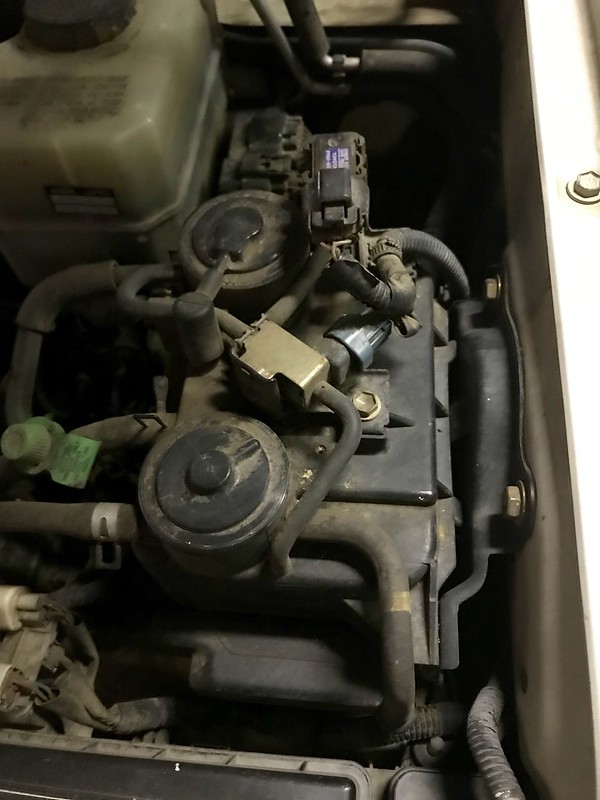

I have had an intermittent fuel smell coming from my LX for a few years. It only happens under certain conditions - when the weather is warm (around 85F to 90F) in the early Fall (August, September, Oct) and after I have been driving for 30 plus minutes. When I park the truck, I smell a strong gas vapor. I check under the hood and can hear a sucking/gurgling/bubbling sound like bubbles through straw on top of the charcoal canister.
Here is a picture of the canister on the DS of the vehicle:
37509686886_0ffeb6b3a5_c.jpg" width="600" height="800"
If I squeeze the air drain hose, the sucking/gurgling/bubbling sound stops.

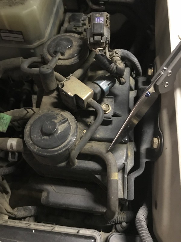

Here I am pointing at the air drain hose I squeeze:
37509687656_799bed0b66_c.jpg" width="600" height="800"
Obviously the vapors stop after the truck cools down. Problem is that the house is already filled with headache inducing gas odor (not making the family very happy).
Does anyone have any ideas on what might be going on? I have looked though the FSM for troubleshooting the system, but just looking for further thoughts from MUD.

I've been told that it's the evap canister and when you price a new one you'll understand why nobody replaces them. I was told by the PO to never top off my tank but he didn't explain why. Basically you are hearing the fuel boiling. It boils because it's hot AND under a vacuum. I would like to know why liquid fuel makes it all the way to the evap canister.

I am hoping an EVAP expert might have some thoughts. I may have a bad vapor pressure sensor or switch. Clearly the EVAP system is venting fuel vapor when it is suposed to be closed. My understanding is that the vapor that is escaping should be captured and redirected. That abviously is not happening.
