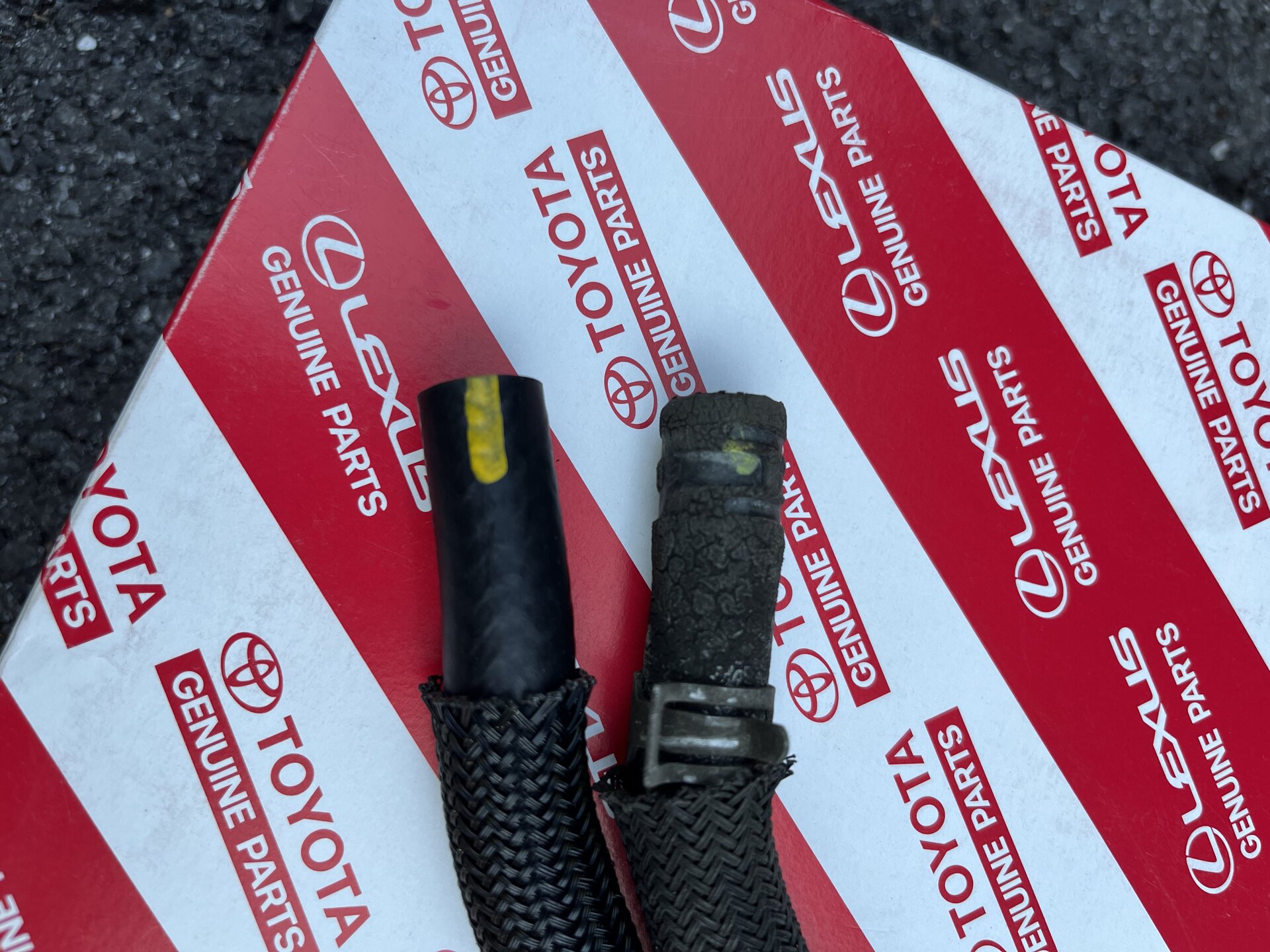

I know in your other threads you’re 100 is well loved. Did you happen to start having rubber hoses replaced in the engine bay yet? Here’s what one of my lines looked like…
Thank you and no, about to start tackling those. Just wasn’t sure which to check out that could throw those codes.
